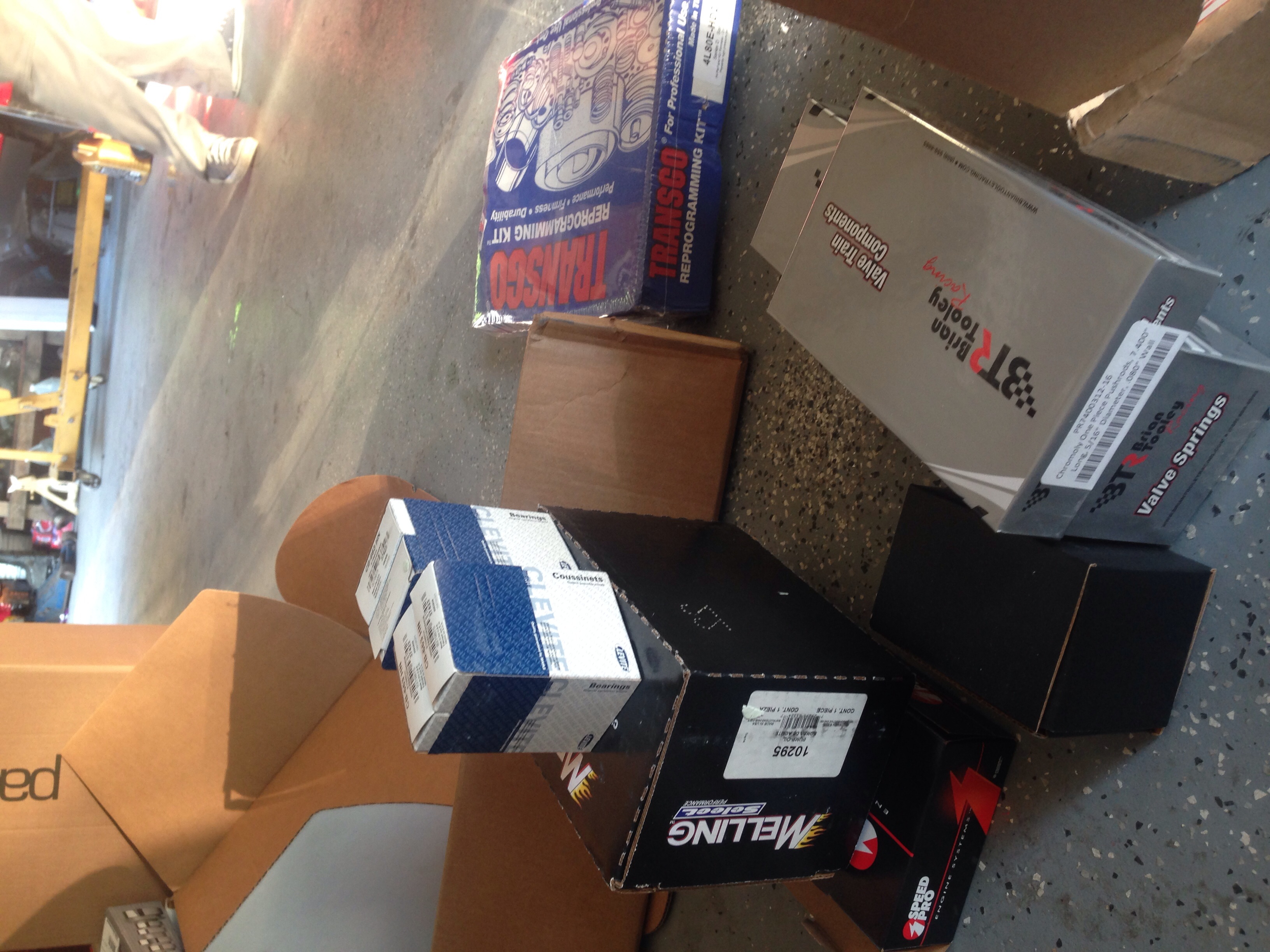

Some more updates, got the tial BOV's the BTR springs, the oil pump, 7.400 pushrods hellfire rings etc

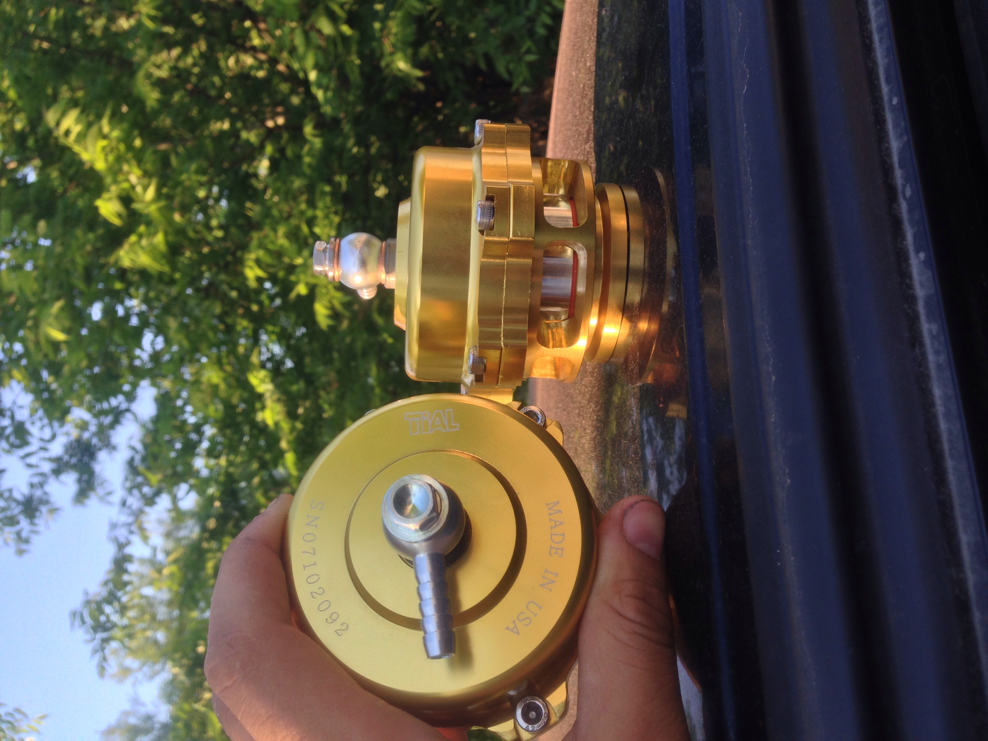

Heres a pic of all the stuff
