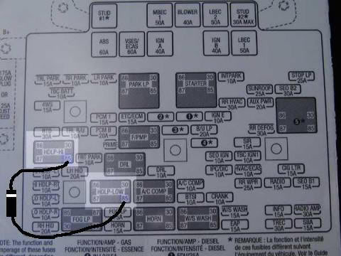

Can you even see 50ft ahead with those HID lamps in the halogen housing? I would do the 4Hi jumper, works on the trucks and should be similar for the vans.
Yeah, I can see fairly far now actually. They do a good job of lighting everything up but it's just scattered, been reading alot about HID's and I guess I'm making a common mistake when it comes to putting HID bulbs into Halogen housings. They work but they do light up everything, top bottom and side to side which is a problem for other motorists.
What's the 4Hi jumper? Is that basically running your low's and your high's together? Wouldn't that just have the same blinding effects on other motorists as what I currently have?
Thanks.

4hi allows the low beams to stay on when switching on the hibeams. I never had good results with projectorless hid lamps; about the only thing visible on the highway was the breakdown lanes and roadsigns.... lol
Basic breakdown, the concept should be similar for the vans as long as yours is 03-up. Googling 4hi mod will bring you to a few threads. Just make sure yours matches year-wise. I don't know the cutoff for van years like the trucks IE 99-02 & 03-07
1N4004 diode
http://m.radioshack.com/radioshack/product/detail.do?itemId=2036270&op=%22http://www.radioshack.com/product/index.jsp?productId=2036270%22

Yeah but I don't want Hi-beams on while driving. That just blinds people. I want more powerful lowbeams.
