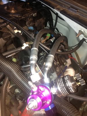

Custom rubber fuel lines (hydraulic lines)
Magnafuel boost referenced FPR
All kinds of stoopid -an fittings
(2) walbro fuel pumps thanks to foose04-->switched to single 400lph in a stock fuel bucket

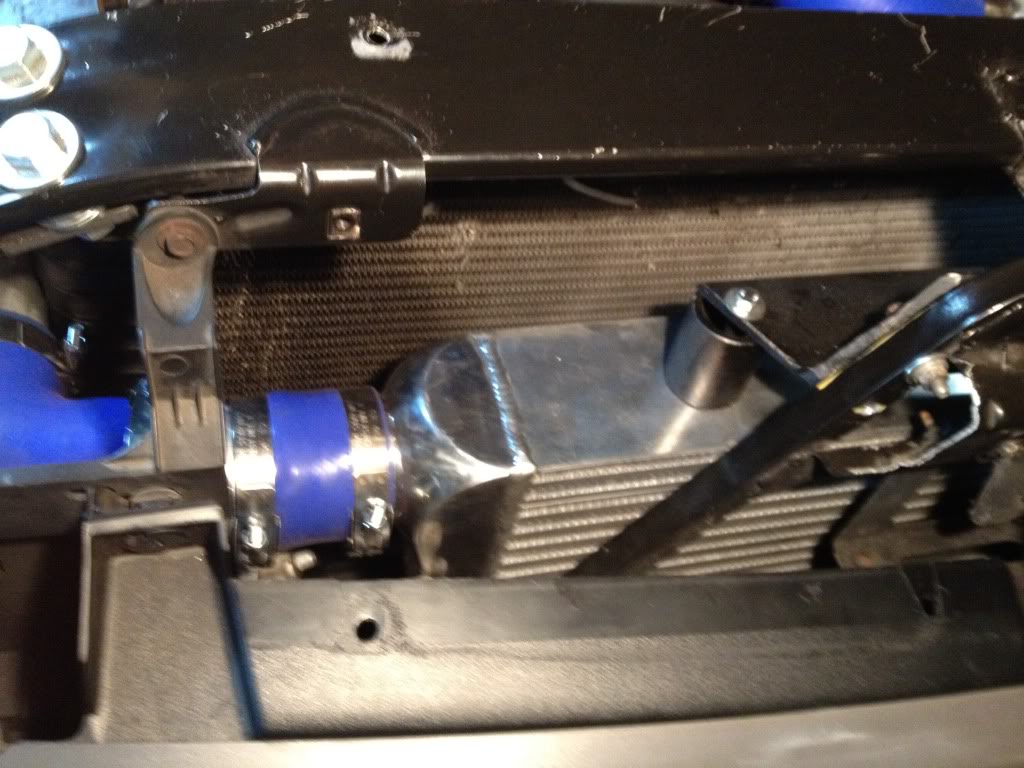

Ebay Intercooler 3"/3"/4"

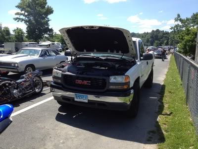

Track best was 11.67@116 with the new tranny, drag radials, and 9.8psi.
Weighed 5180lbs with me in on the tracks scale full tank of fuel.
Running 10lbs of boost on pump93 fuel, and knock retard has been pulling 6-8 degrees of timing every once in a while. Havent figured that issue out yet?
