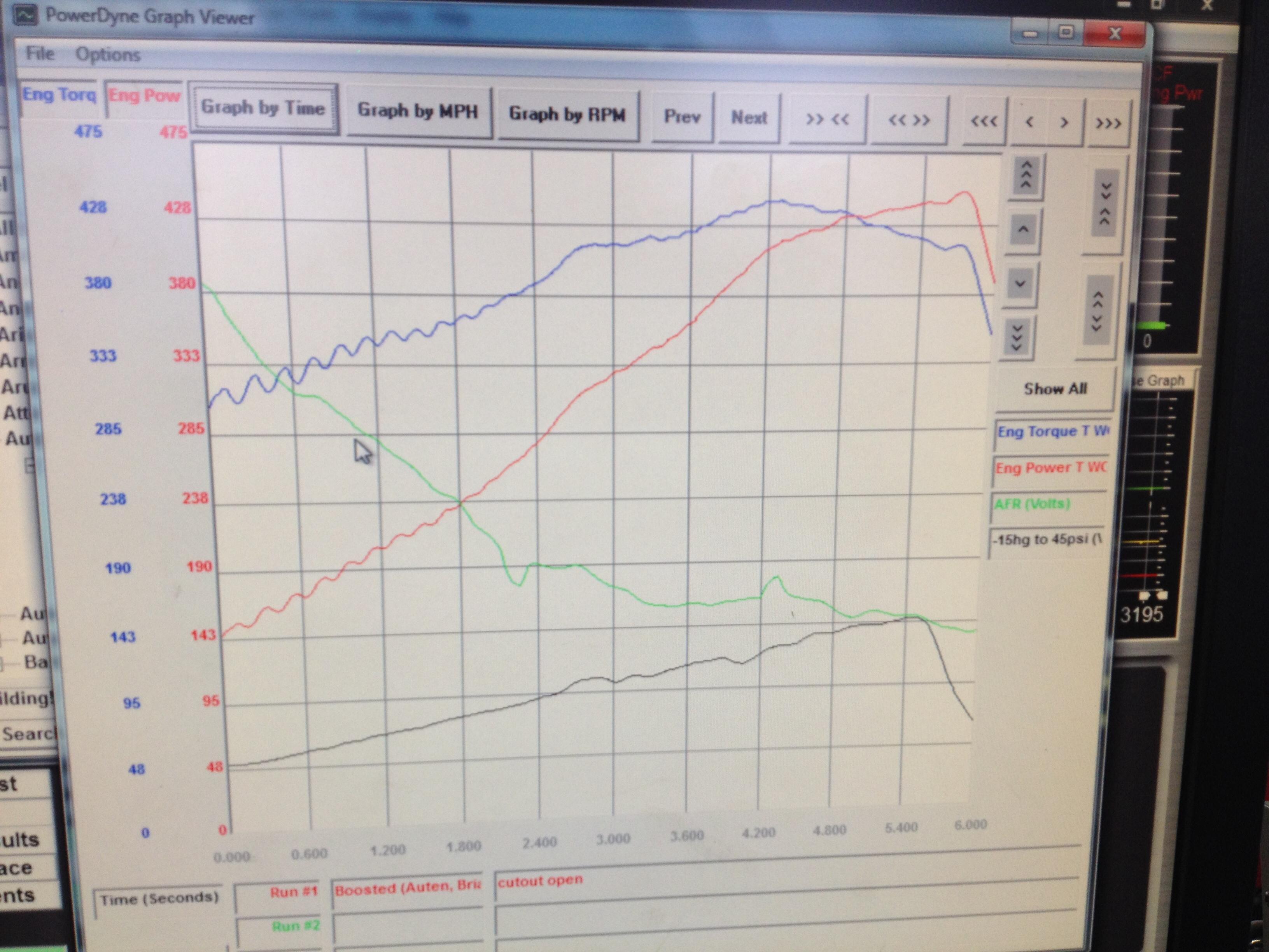

Anyhow here's the baseline on our Local Heatbreaker dyno and a vid. I keep you guys updated on the Progress. This is my Personal first Jeep and I plan to Get more into the Hemi market here in 2015.

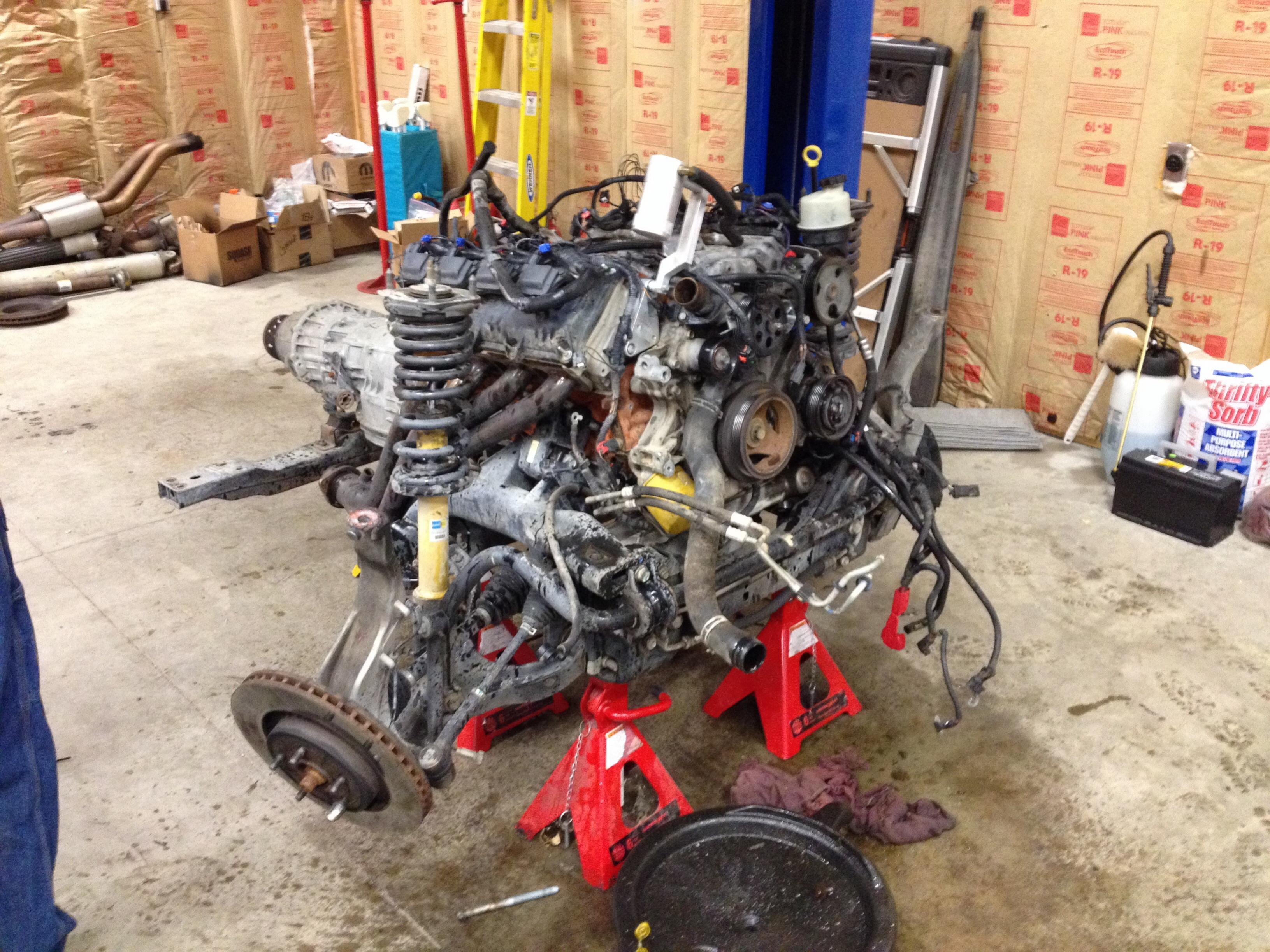

Ya I'm excited.. I dropped the engine, parts are slowly coming in for it.. PWR originally supplied the shortblock but it sat too long at another local shop that wasn't able to do the work, and got too much dirt in it for my comfort so I'm pulling it down and cleaning it up a bit while I'm waiting to get the parts here. Also sent the converter back to pro torq and had it loosened up a bit. We pulled the heads off the ok engine come to find out it had a broken ringlands and broke the piston on cylinder three.. Lol it's a wonder it ran so good had no idea of any issues. Kinda crazy

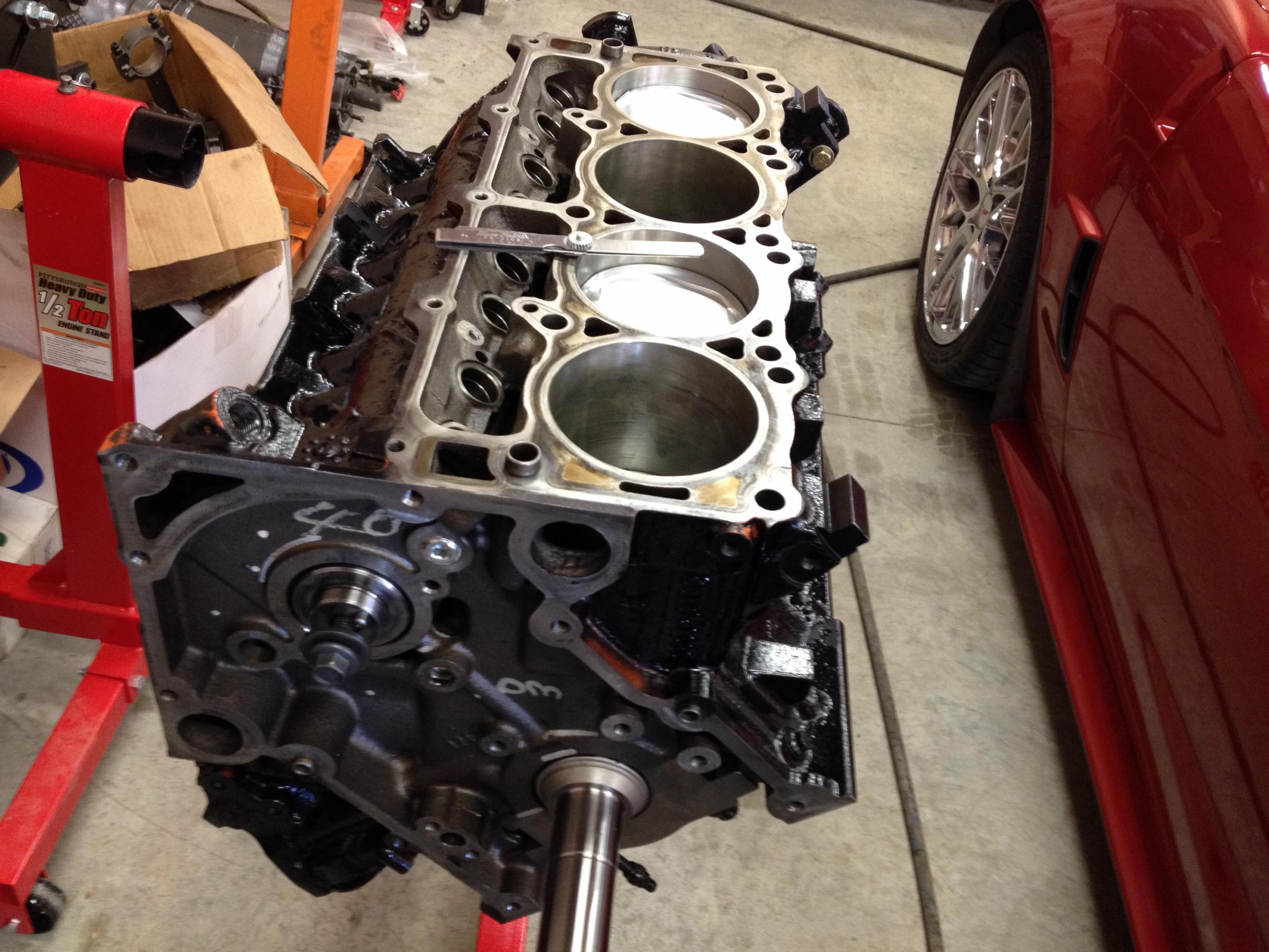

The new shortblock is assembled.. I went through and checked everything out and opened up the ring gaps a bit, since were changing blowers to the F1a-r-94 an gonna lean on it a bit harder than the guy who assembled it first knew. The fuel system showed up from fore innovations today it's a dual pump design in the oe tank I'll take pics of that during assy.
