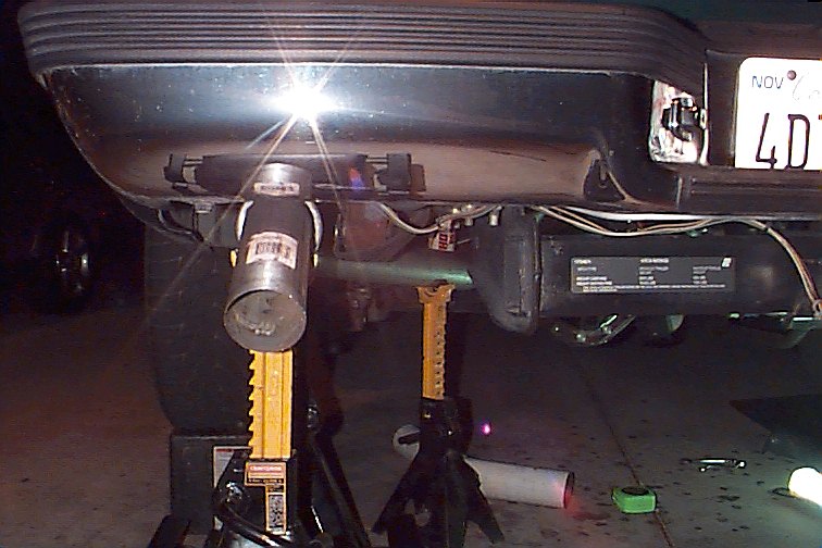

I did a bologne snub cut similar to factory but deeper.
OK, I give, what the heck is a bologne snub cut? can't find any info on it. Got any links or info otherwise?

The tailpipes on my truck are nothing more than a pair of mandel-bent tubing sections sized and cut the way I want them. A "boloney cut" is where you hack off the pipe at an angle to create an oval opening. I wanted my oval on the same plane as the muffler, and a level matching the bottom of the muffler case.
I this picture you can see what I'm talking about for the oval cut on the turndown. I know it's dark and I can take some better ones tomorrow if it would help.
This picture was what the pipe looked like during mock-up before I chopped it.
As for the "snubbing", that's just cutting off the tip of it so it's not pointy. This cut is made perpendicularly to the tubing axis. It gives it an OEM look.
I couldn't be happier with the way it turned out. It's exactly what I wanted, even the flat-black paint looks the way I want it to.
Hope this helps.

Thanks, got it.
I really like that snub cut you made. let be know how that BBQ paint holds up. I was thinking about thermal coating the whole exhaust or possibly just wrapping it.
