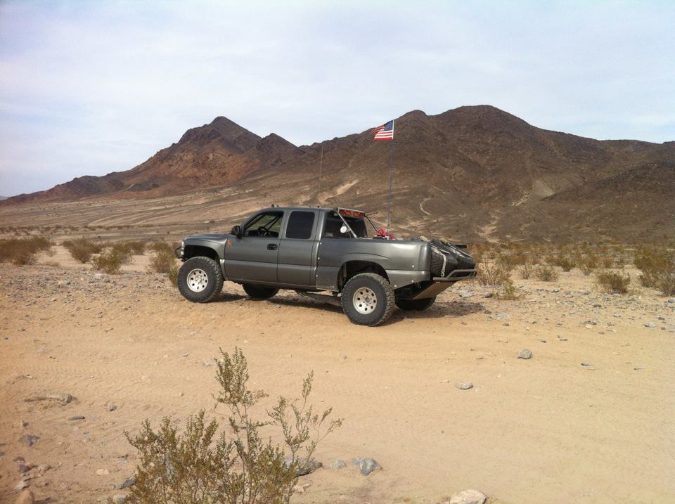

I've had a few projects going lately and figured I'd post one of them. This was a build for my buddy that we finished up recently. While the 5.3 did decently well, the truck really needed some more power for the terrain it's capable of.
Here's the truck
Here's the break down:

Cam is 231/235 .598/.610 112LSA +4
Heads are 243's milled .030 with WCCH stage 2 cnc port work.

Truck is desert only
Trans is a built TH400 with a manual valve body.
Rear end is fully fabricated Ford 9" style, 4.88 gears, with a spool.

Motor ran amazing on its first trip out. Dezert1500 knows what's up.
Prerunner engine build/swap-truck.jpg Lap around Dumont - YouTube
