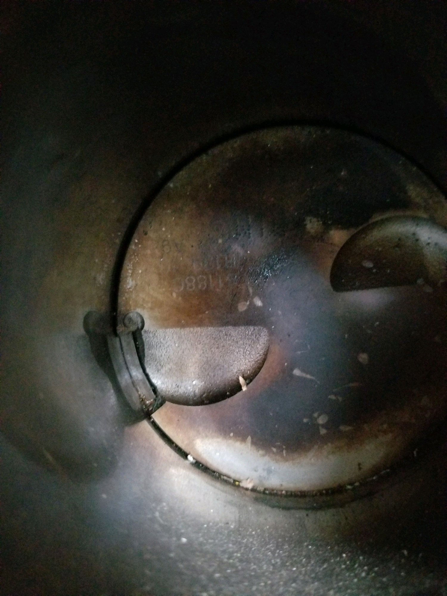

I might have missed it, but did you open up the engine and open the ring gap up any? Bent electrode usually means detonation, an if compression is down I bet you have a cracked piston.

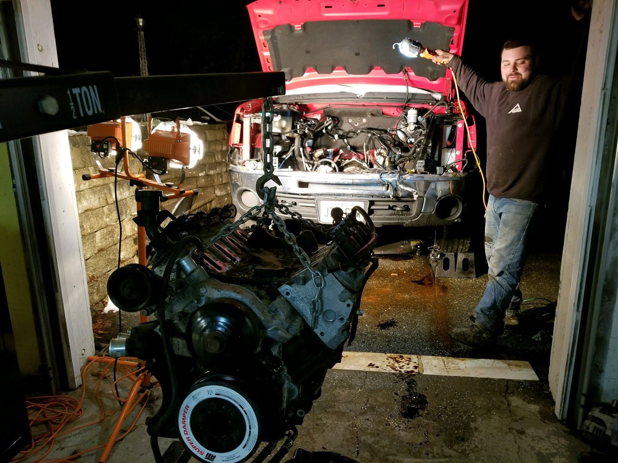

Been very busy over the past year and have slowly worked on the truck to some extent. Ending up pulling the motor and sure enough the #7 piston was missing a chunk near the valve relief.

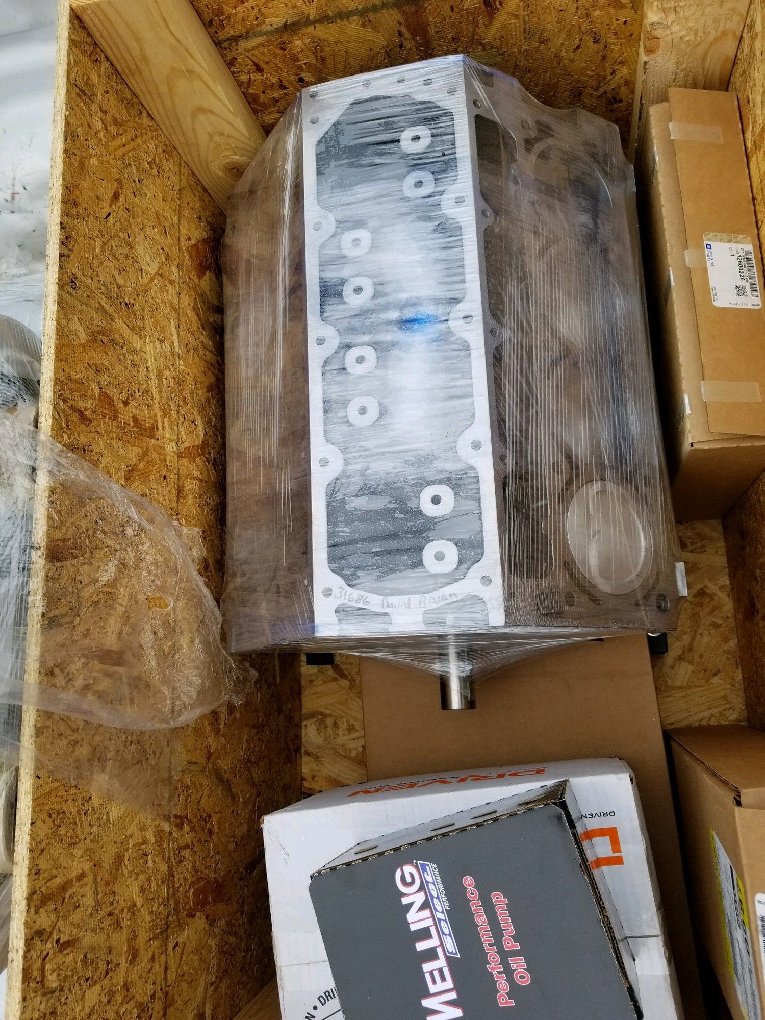

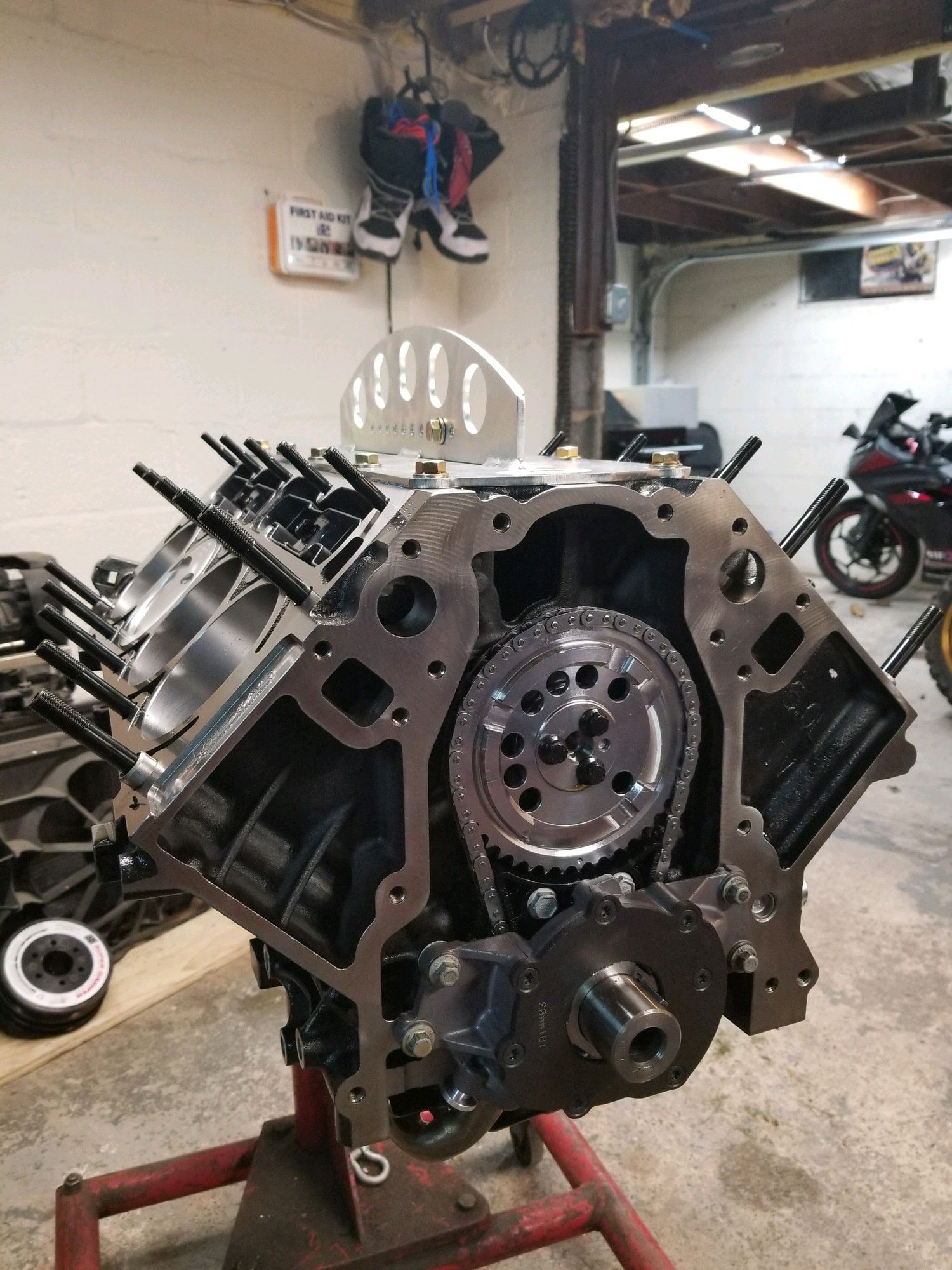

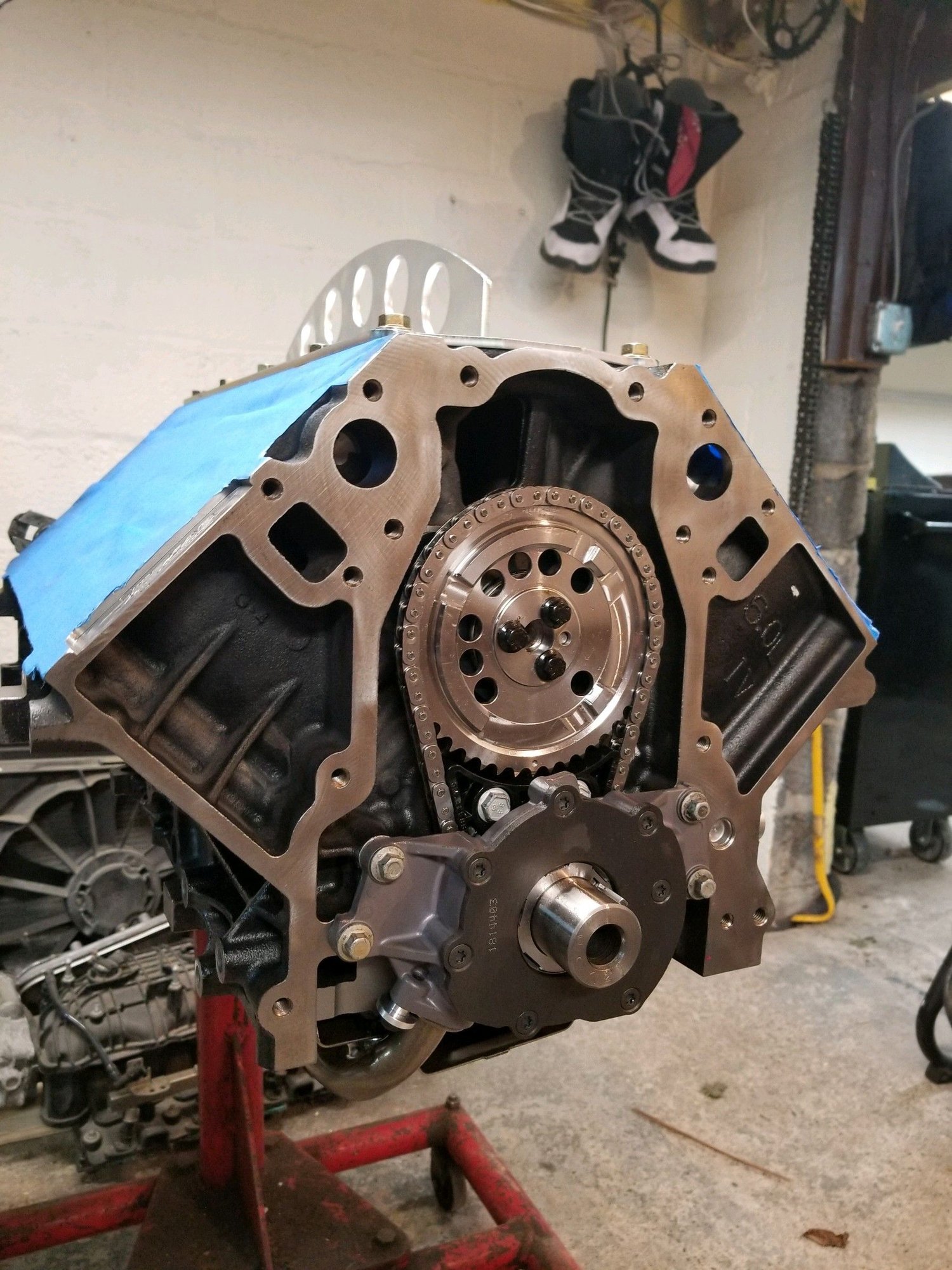

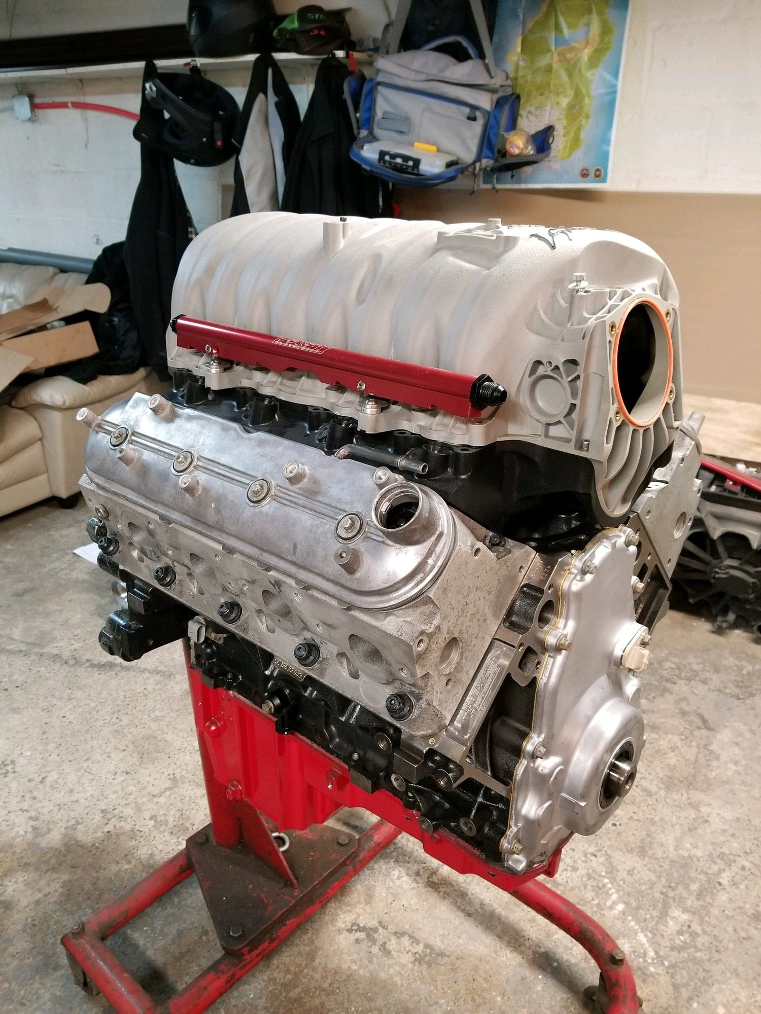

Here's some of the new engine pictures. Ended up with a 370 from Texas Speed and going to be re-using my stock 5.3 heads for now. I put an LSXRT on it for a picture but I'm probably sticking with the stock intake manifold for now. Everything is pretty much ready to go in once I get a decent weather weekend to do the work
