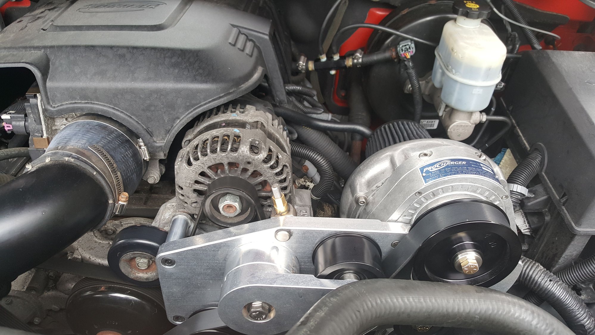

That picture isn't clear enough for me, but if I'm seeing what I think I'm seeing you're gonna have belt issues.
Can you take a close up pic where you ran the studs to the alternator/bracket?

Here's a closer up shot of the bracket by the alternator. Originally I had the provided bolts and spacers in place, but ECS said it wasn't lining up well and changed it to studs. This is an old bracket/kit which was labeled originally for 00-02.

I see what they did there. Probably be fine.

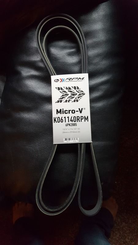

Waited 2 weeks for the new RPM belt from gates.
After 2 miles of test driving
Pretty disappointing considering it's a Gates product specifically designed for supercharged systems. Seems to me like it could be a factory defect in the compound used for the belt. The entire outer layer of the belt kind of unraveled onto an idler pulley as shown in this picture:
Have a new one on the way that hopefully will hold up better and let me delay going to direct drive a little longer..

It doesn't matter how good the belt is if there is something wrong with the pulley arrangement/blower bracket system. I say "system" cause thats how you need to look at it. It ALL has to be right to work.
I'm not saying this is the case, but based on the issues the "installer" had, I'm gonna guess there is something way wrong here. Shouldn't ever kill a belt like that in 2 miles.

Pretty sure it ended up being a defective batch from them. The way the outer layer literally melted onto my idler pulley I feel it was a bad batch of the compound used for this belt. Was supposed to get a new belt right away and was told they had 154 in stock, but a week later I got a message that it was delayed 3 weeks without explanation. Received the new belt and has held up over the past few days, but certainly didn't help my belt slip issues...
Anyway I'm fed up trying to make this bracket work so I bit the bullet. Ordered the Stage 11 direct drive kit from brute speed today.
