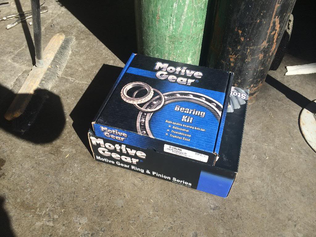

Gears showed up today. I'll pull the posi and old gear set out tonight and get it cleaned up. Not sure where I'll press the new bearings on at since we just sold our last press..

when i did mine yesterday i baked my bearings and ring gear at 300* for 20 mins
put the carrier in the deep freeze and it went together fairly easy.
block of wood and a ball peen hammer

That is a damn good idea. Very creative! I have a set of 4.10s that have been lying around, but I'm so scared of not properly aligning everything and don't have a press. We have always taken our 12 bolts to a local gear shop for this reason, but I'm not selling the truck like I would a camaro for profit and hate to pay them $250 if I bring the rear end or $500 if I bring them the truck.

I'll just end up using the torch to heat them most likely. We used to have a bearing heat plate around the shop but that was sold with all of my other toys.
I took 30 minutes and removed the posi and pinion. Tomorrow I'll gets some brake clean and clean the housing out, and see how much time I have to work on it. This truck is going to be a freaking animal with 4.10's.

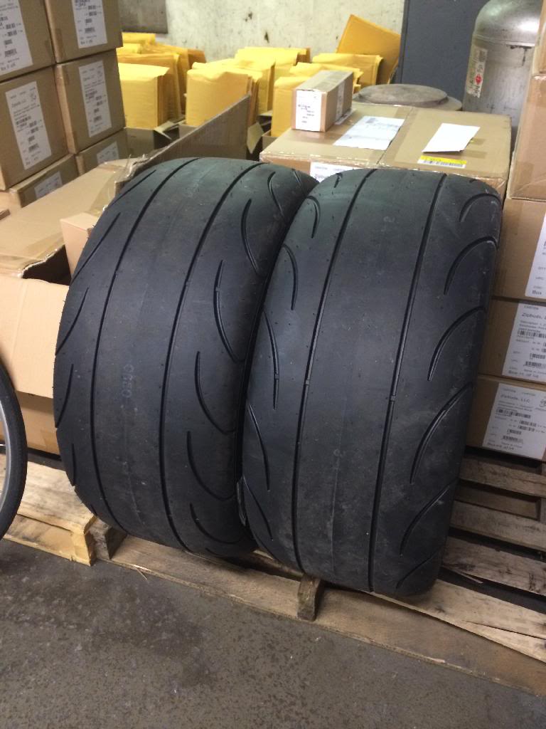

Old Mar 6, 2014 | 05:28 PM
  #460
oakley6575's Avatar
Joined: Dec 2010
Posts: 5,235
From: Las Vegas, NV
New rubbers came in. Still weighting on the wheels. These radials are super soft so I'm thinking I'll be able to pull off a sub 2.00 second 60'. Should see some 11 second passes no problem at my current boost level.
