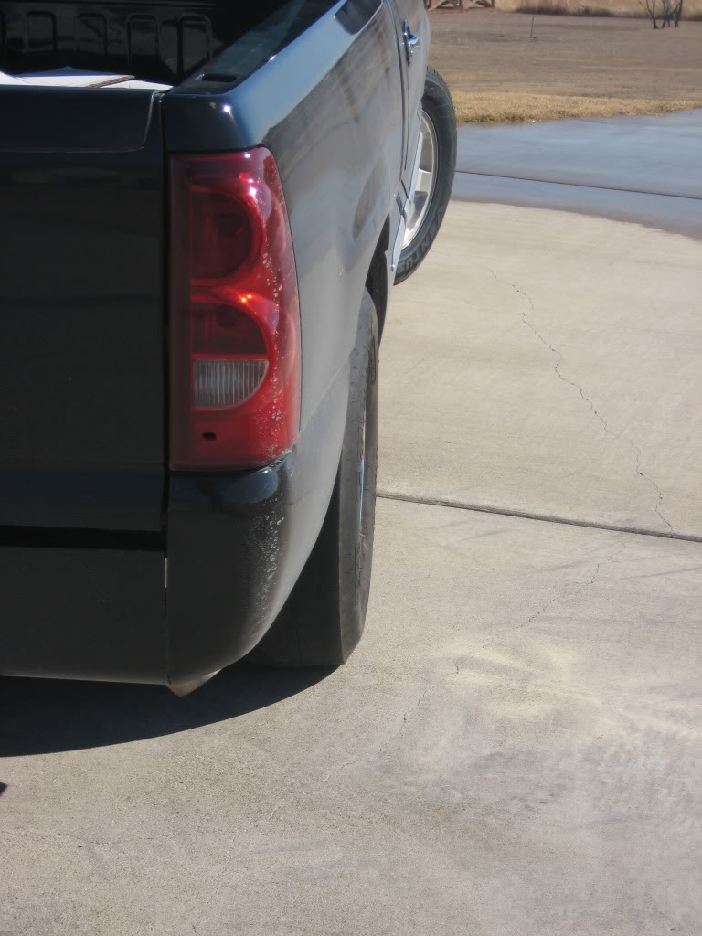

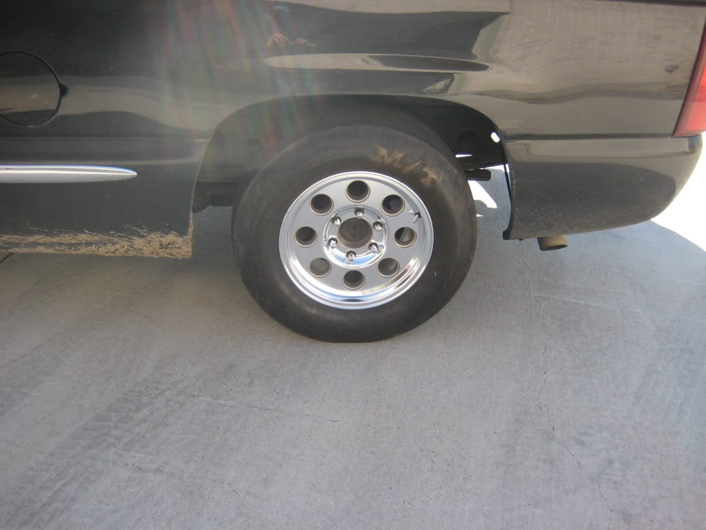

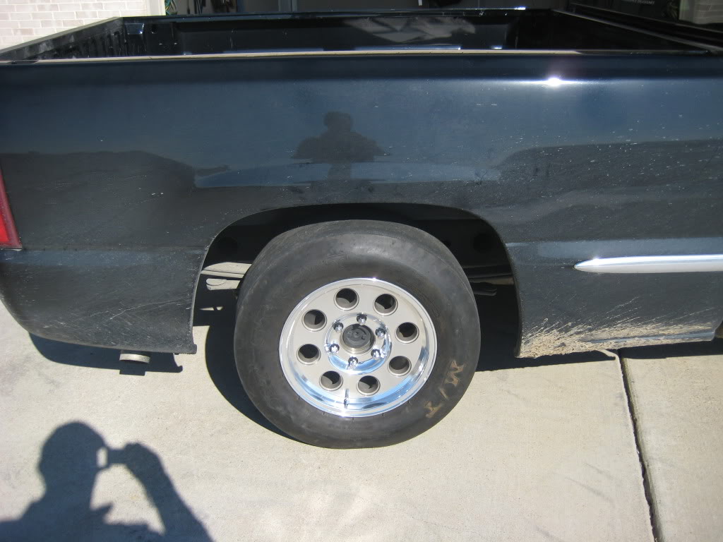

Just got bent over at discount tire. $850 later and I have some heavy *** cragar drag wheels and 315/60-15 tires.
Should have bought some wheels like this. The wheels only weigh 22lb and they tuck and are cheap and are 16x8.5

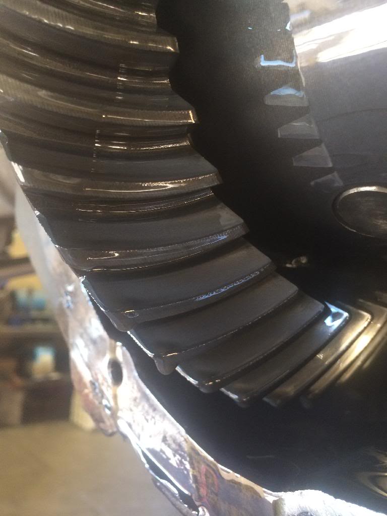

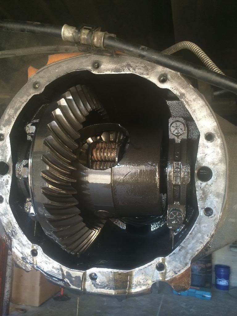

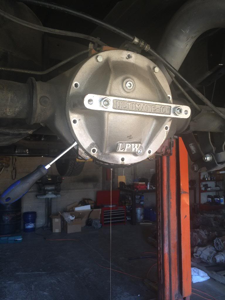

Got really tired of looking at a computer screen so I went out back and pulled the driveshaft out, rear wheels off, and pulled the diff cover. My 4.10's will be here sometime next week so I thought I would just tear it apart now and fix a few things.
A while ago, I put a line lock in my truck but once I got it installed and buttoned up, the damn solenoid didn't ever work. So since I'll be running at the track a lot now, I thought I'd either fix the line lock or get a replacement. I'll take that out of the truck tomorrow and see if I can get it to engage.
Those beefy tires and a good burnout with the line lock should give me decent traction with the new gears...I hope anyways. Next step is probably to relocate the shocks behind the rear end.

Originally Posted by ShredSled
What carrier is that, Eaton LSD?
No it's the cheaper version
It's just an auburn posi. It's taken a **** ton if abuse too. I'd buy another one in a heartbeat
