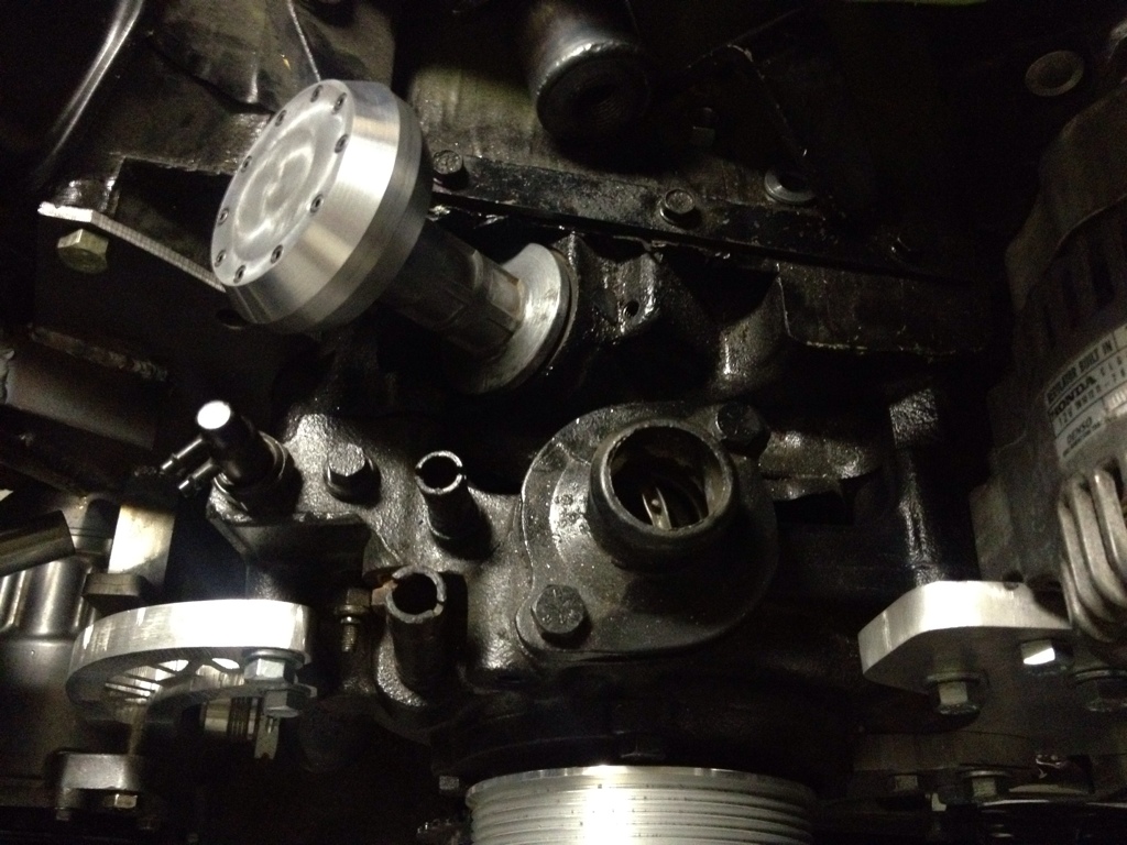

Thanks fellas,

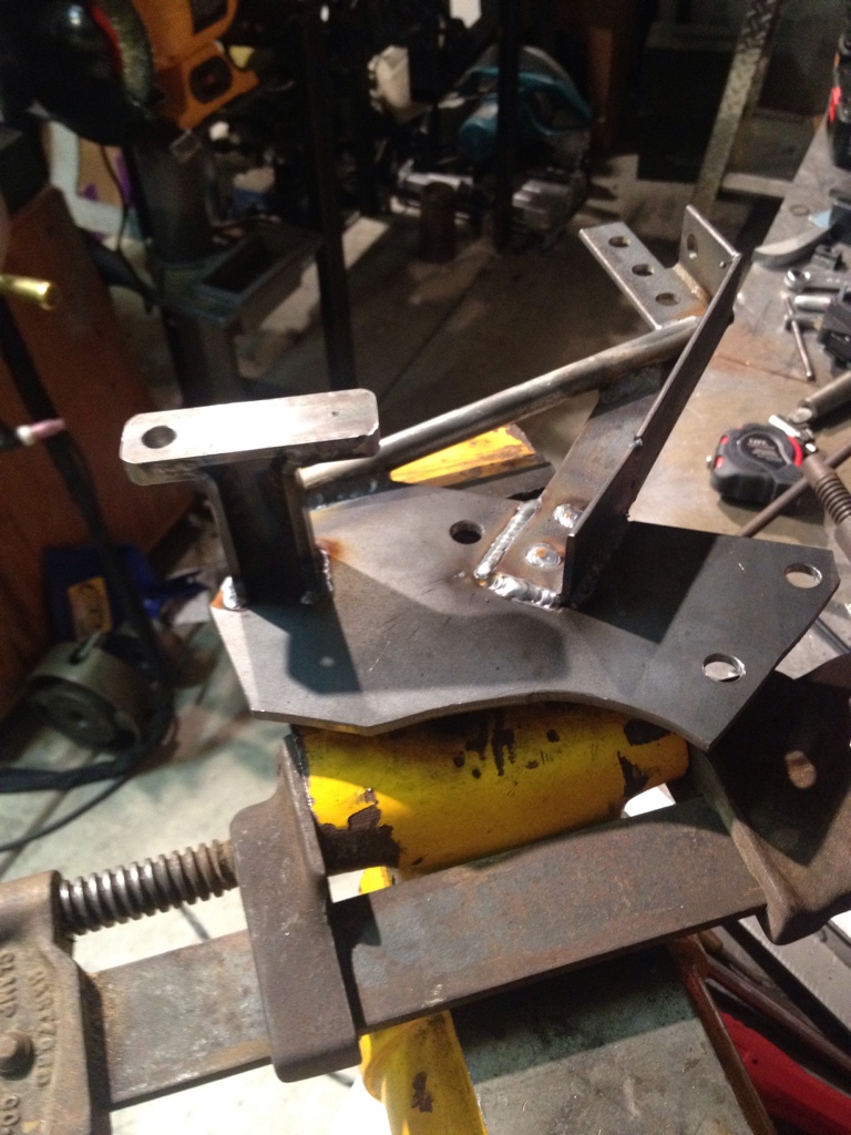

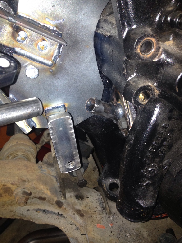

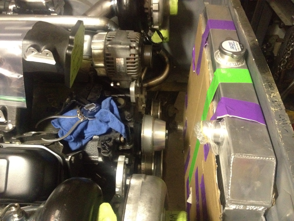

Not too much of an update, but I got the exhaust pretty much finished up. I got the ac rear support done, Im also using the fuel pump port for the right turbo drain. I'm also building a little reservoir for the power steering pump. I also plan on building a normal power steering tank that will be mounted I the fire wall or under the intake, but the little one should keep the pump happy.. I also started planing the radiator and piping, pretty tight fit...
Old Aug 16, 2012 | 08:38 AM
  #132
01GMC5.3's Avatar
Joined: Apr 2009
Posts: 220
From: Gantt, AL
looking very nice sir. it has come a long way

Old Aug 16, 2012 | 10:01 AM
  #134
TX Tahoe Z71's Avatar
iTrader: (28)
Joined: Nov 2004
Posts: 3,836
From: Houston, Texas
Really coming along! Amazing work, and even more amazing patience
Thanks, feels like so far to go..
I like that purdy duct tape your using..
It's packing tape :/
Thanks. My son is turning one tomorrow so I doubt I'll get much done this weekend.

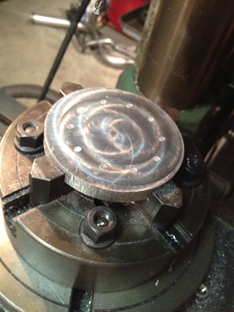

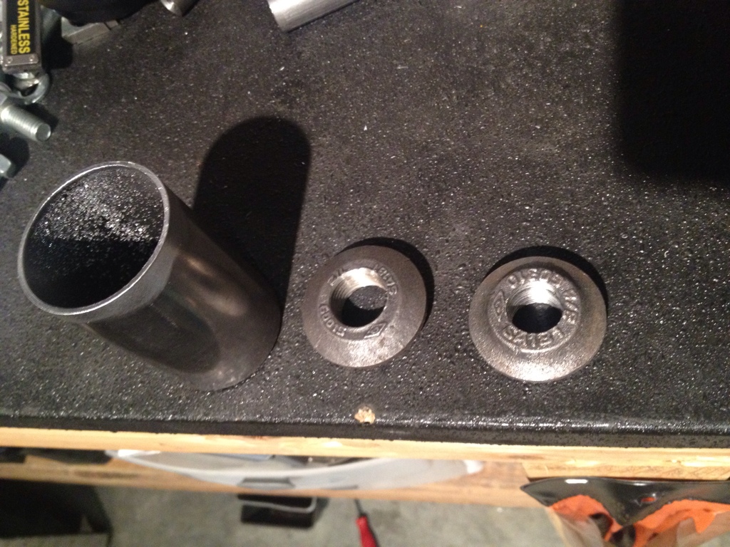

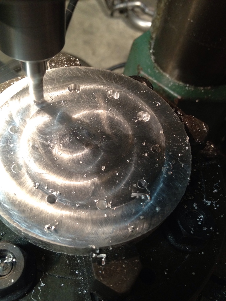

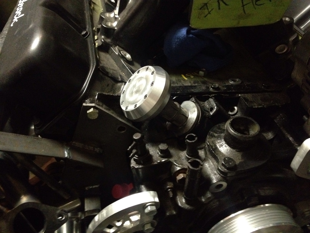

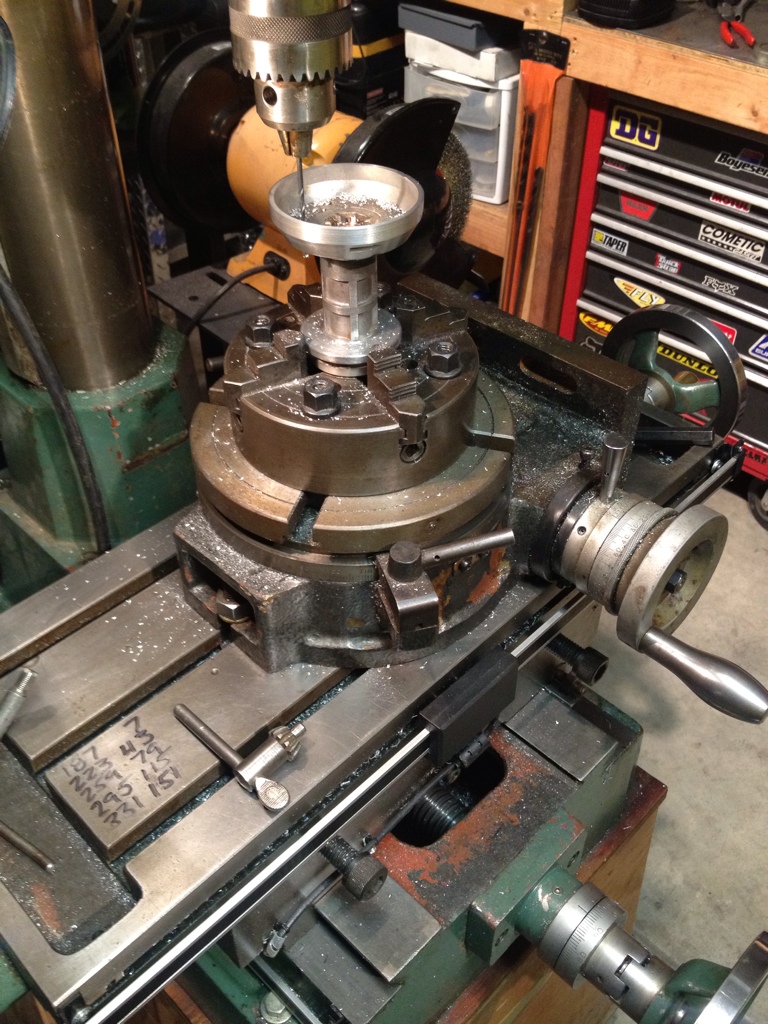

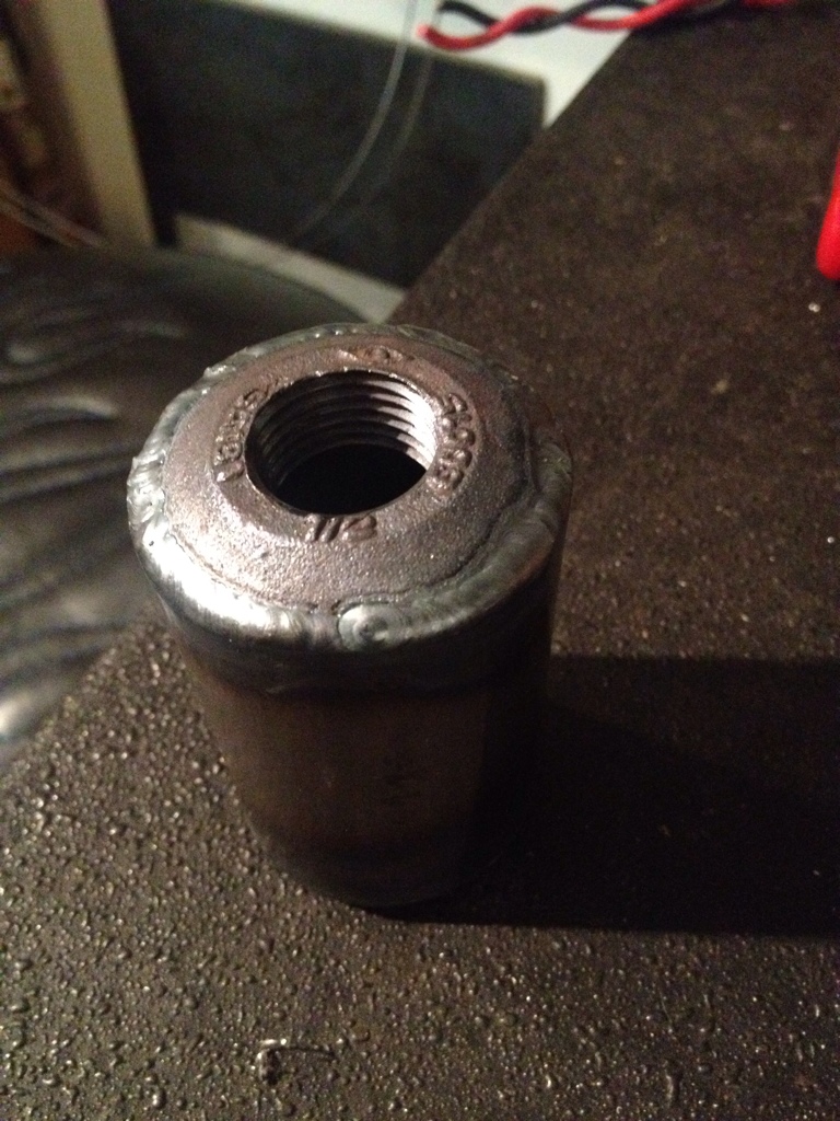

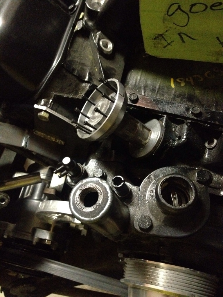

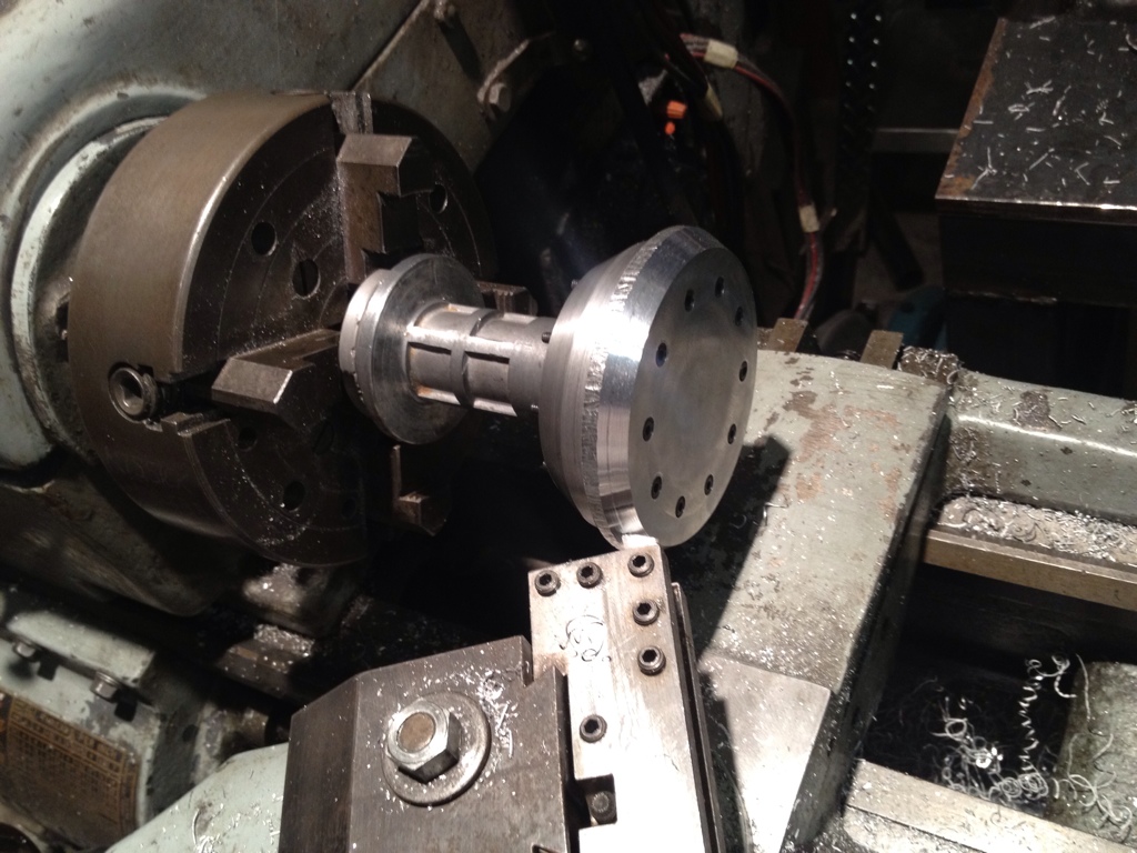

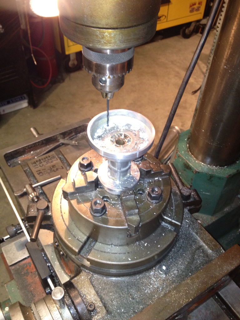

I pretty much got the distributer/cam sensor housing done.
