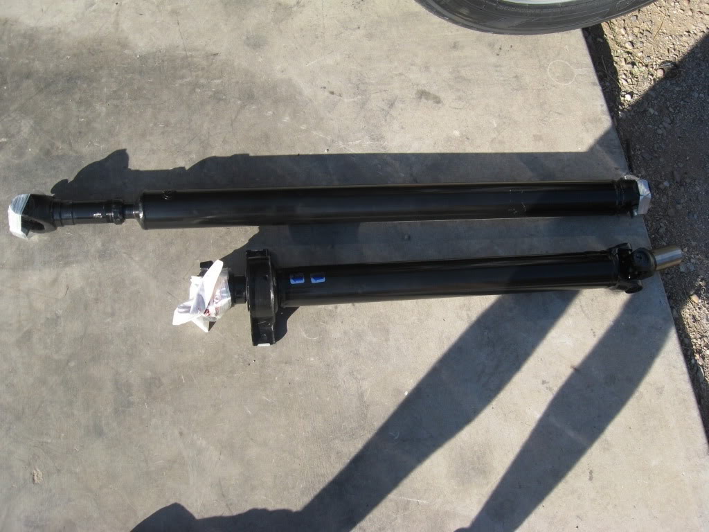

Pic of the driveshaft...

  #58
SincalT/A's Avatar
Joined: Oct 2006
Posts: 1,783
From: Currently In suspense.
Damn,thats a nice shaft....

double047's Avatar
14 Second Truck Club
iTrader: (15)
Joined: Jul 2010
Posts: 1,629
From: Texas
Do you have pics of the drive shaft installed?
