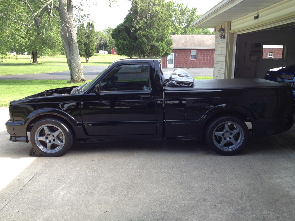

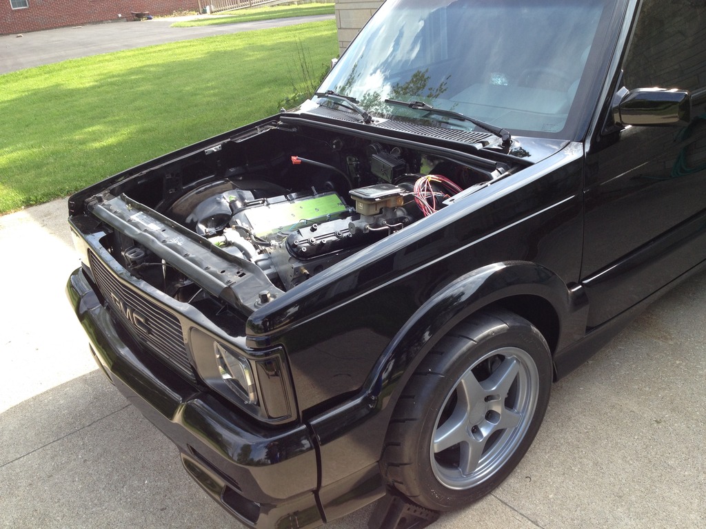

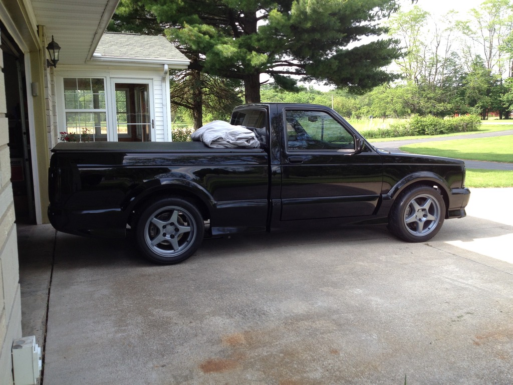

Finished a few things left that were underneath and got it back on the ground under its own weight. Sits and looks good, bad part is oil pan is lowest piece and is 5-6" off of the ground..
Truck is a freakin shoe box tho, its small compared to my ss, and my ss is small compared to the new trucks so its tiny.

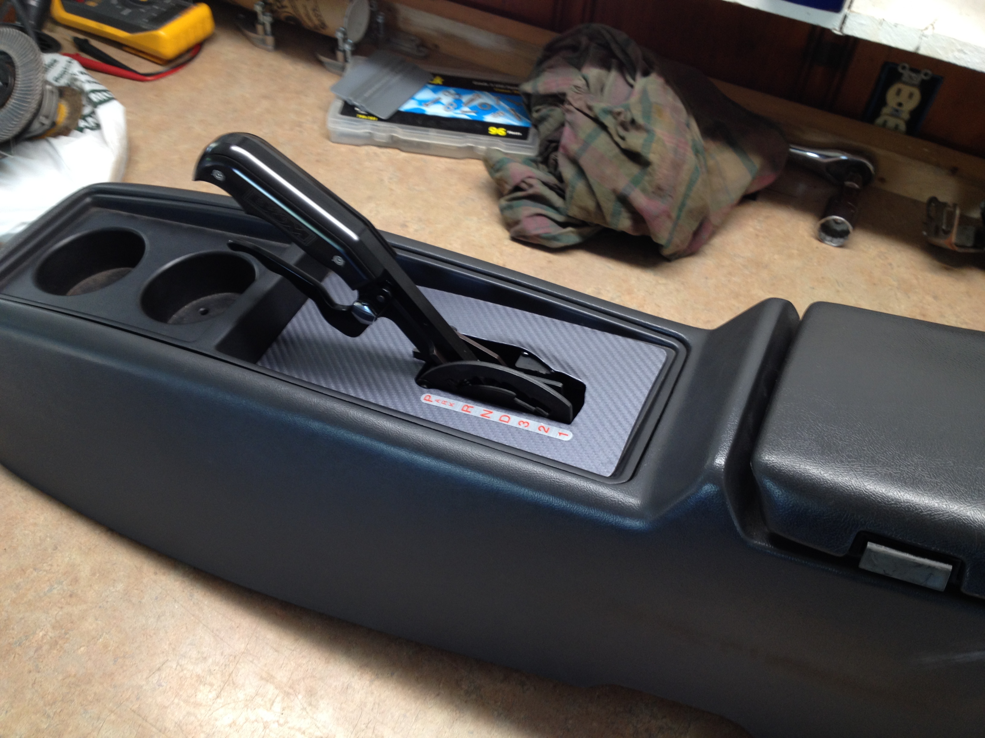

I mounted a b&m shifter finally, made a plate and covered it in 3m vinyl. Looks decent but not exactly what i had originally set out to do which was make it look more factory with a boot. I like the shifter alot tho.
Mounting the fuel cell, fitting a a2a, and mounting trans and oil coolers is next. Then maybe some custom tigged hotpipes come fall..
