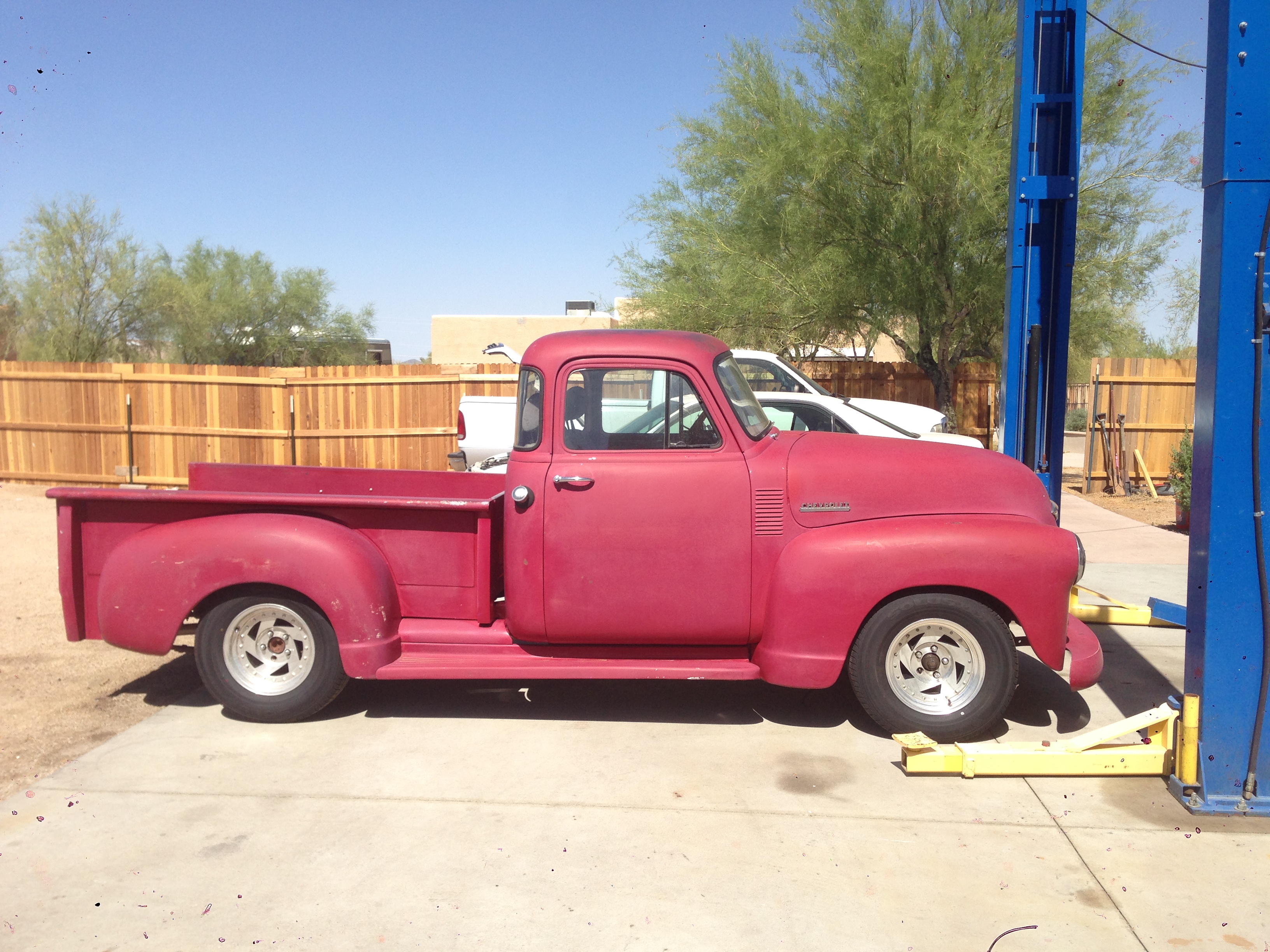

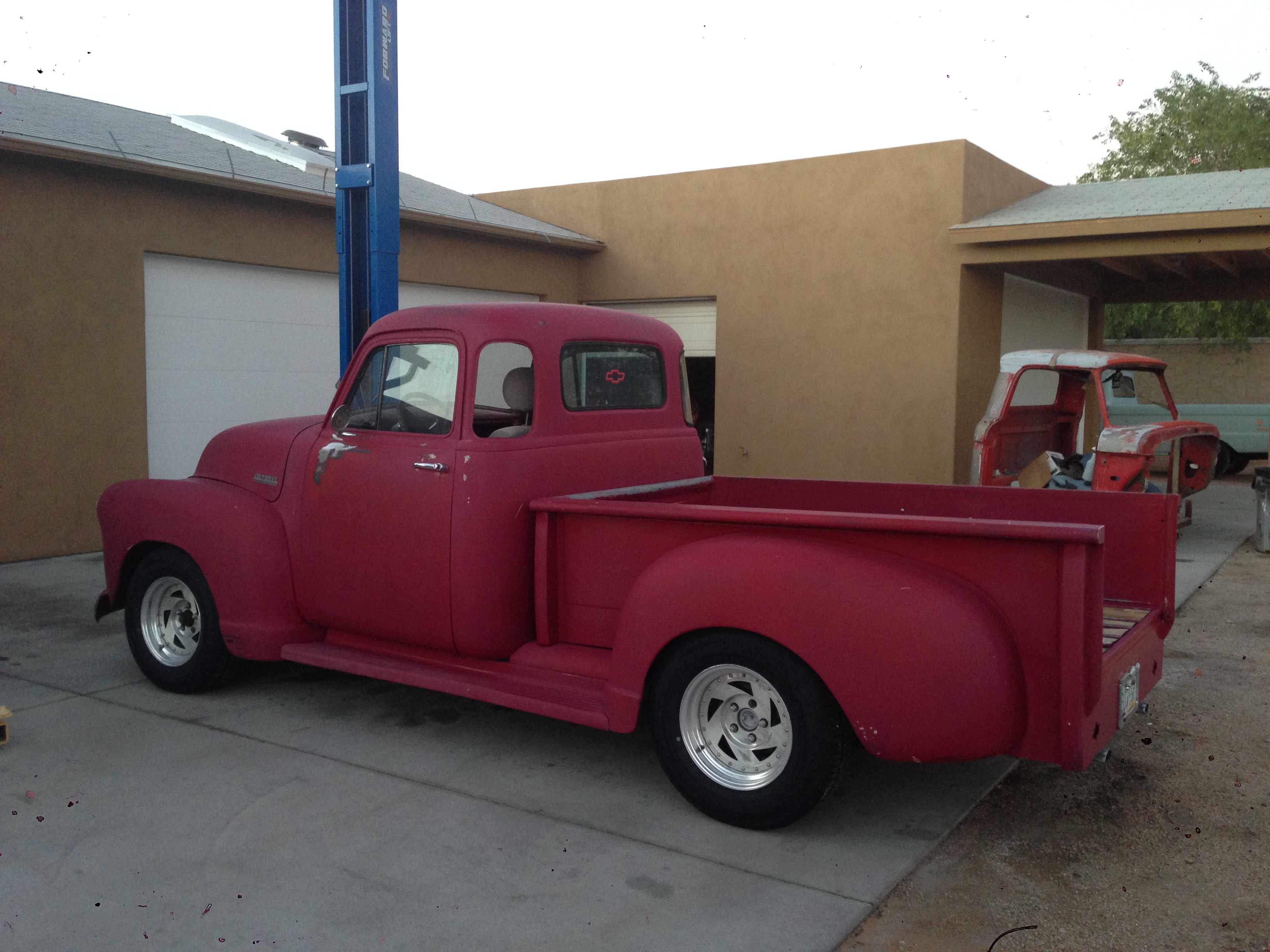

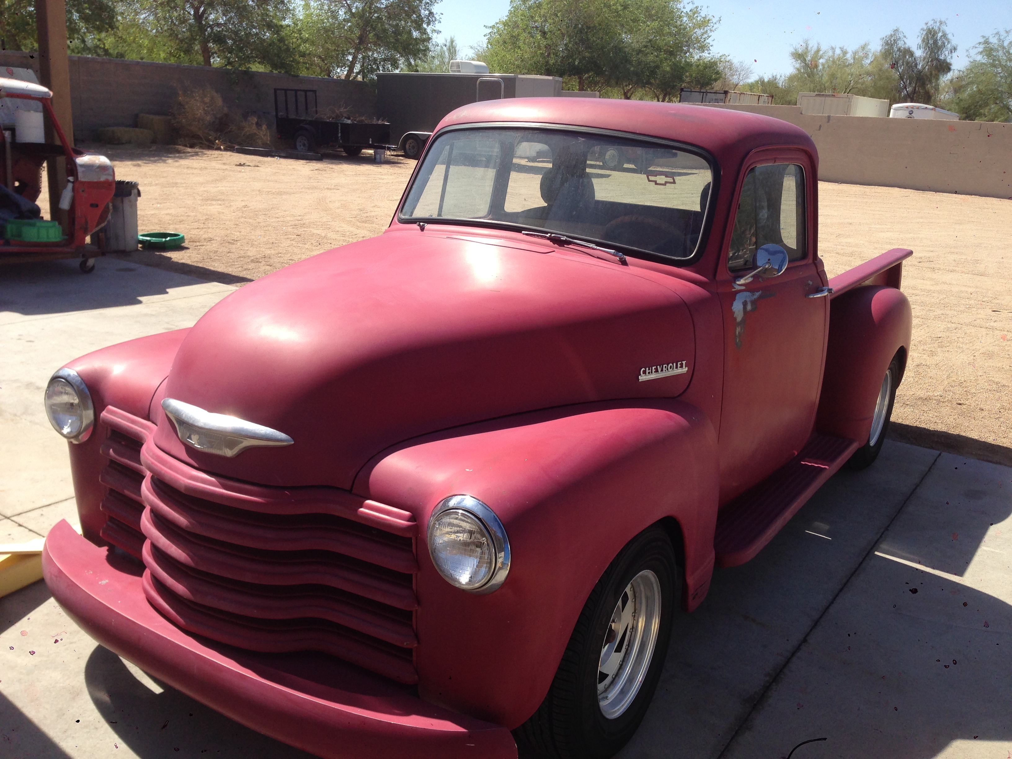

I do have a Chevy Truck build on the back burner. Its a '54 5 Window with a '53 Front clip. Its got a Firebird front stub and rear axle along with the 5.7 and TH350
Nice clean AZ body.

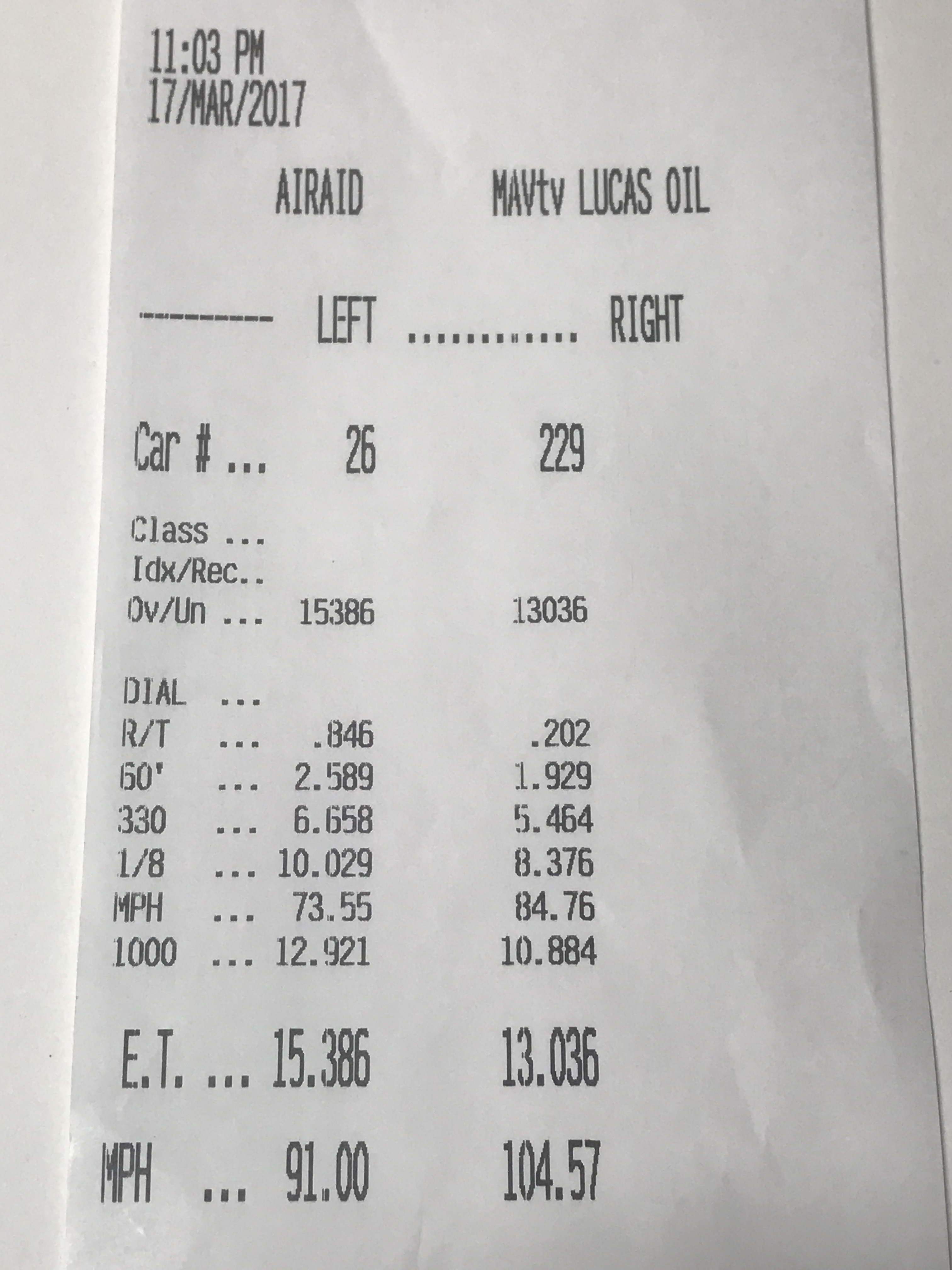

approx 5000 miles on Eco1 so far. Have been to AutoCross and also to the dyno and Dragstrip.
With a very poor tire where I had to launch from idle it ran a 13.036 @ 104.57 mph on a high temp night with temps from high 80's into the mid 90's.
Dyno it made 405/532 @ the tire. (dyno could not load properly so not full boost over 4000 rpm)

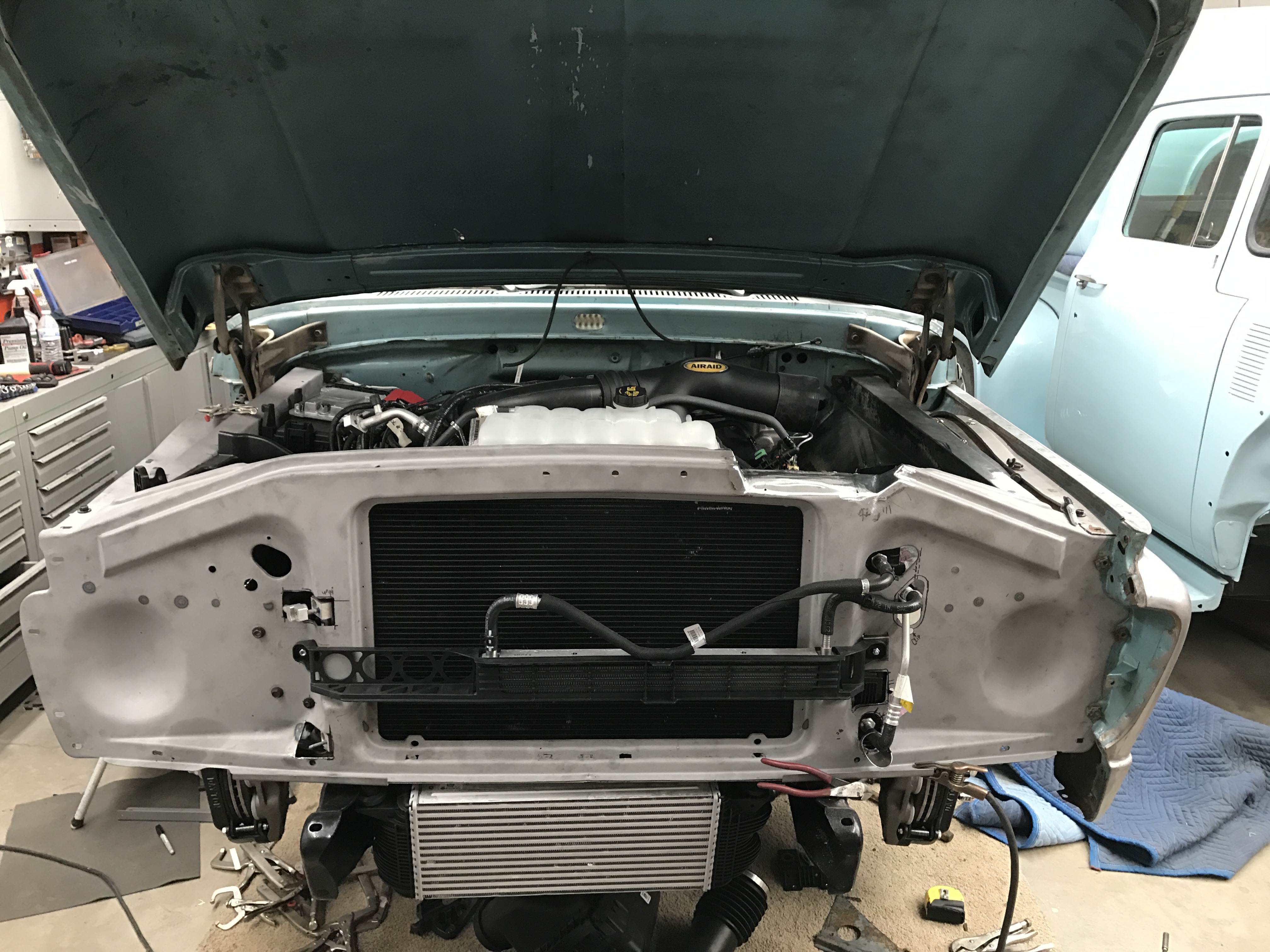

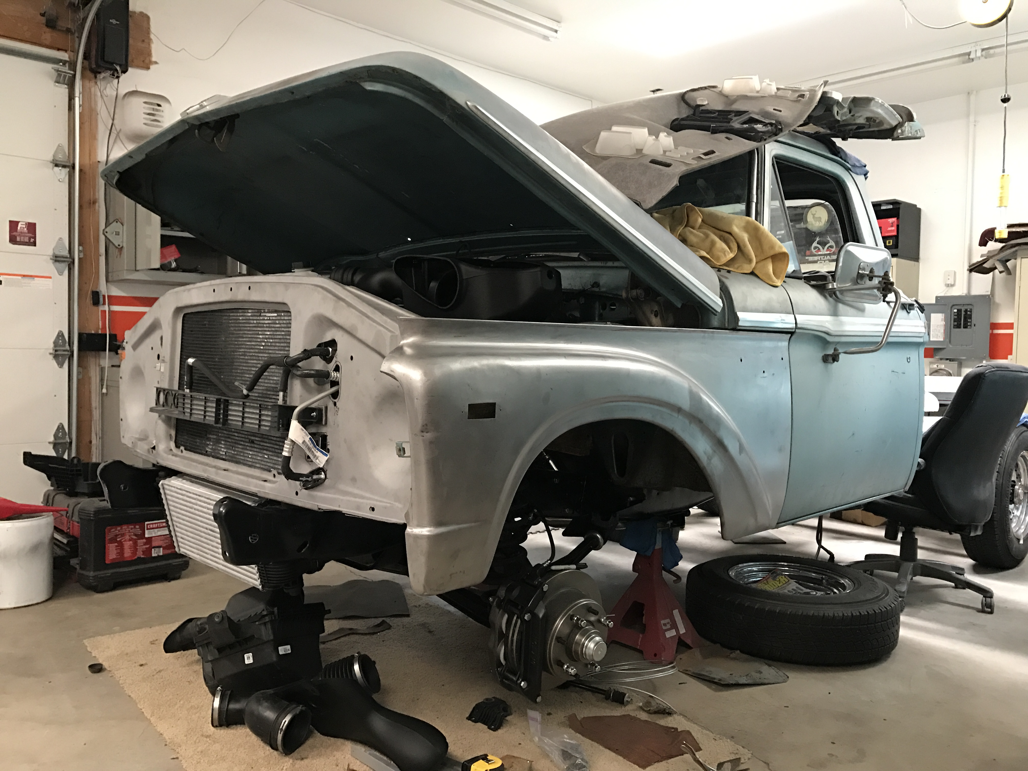

Eco2 making very very slow progress, but progress.

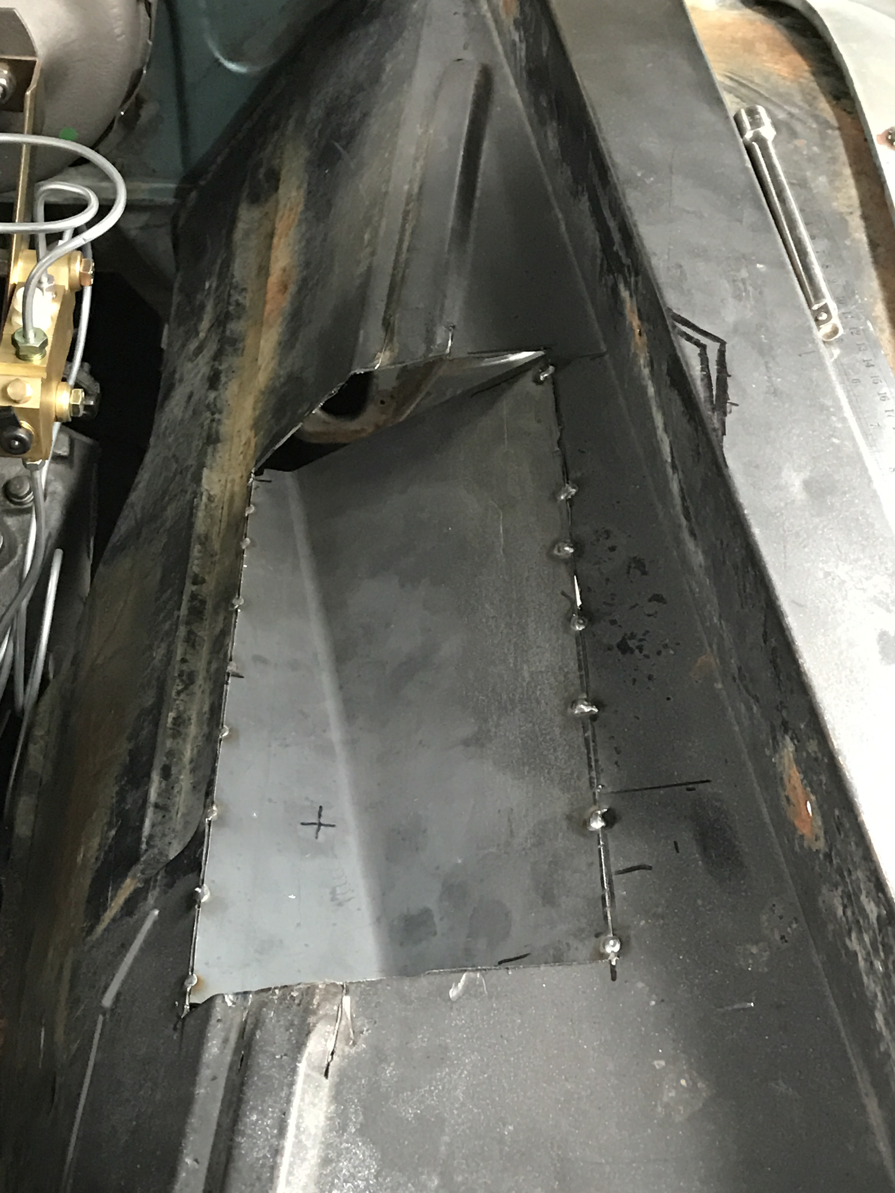

Pretty much have all the front inner structure figured out and tacked together. Managed to fit all the '15 components under hood. Quite a bit of fabrication tho.
Very little room left but still very easy maintenance once the airbox is out of way which takes about one minute to do.

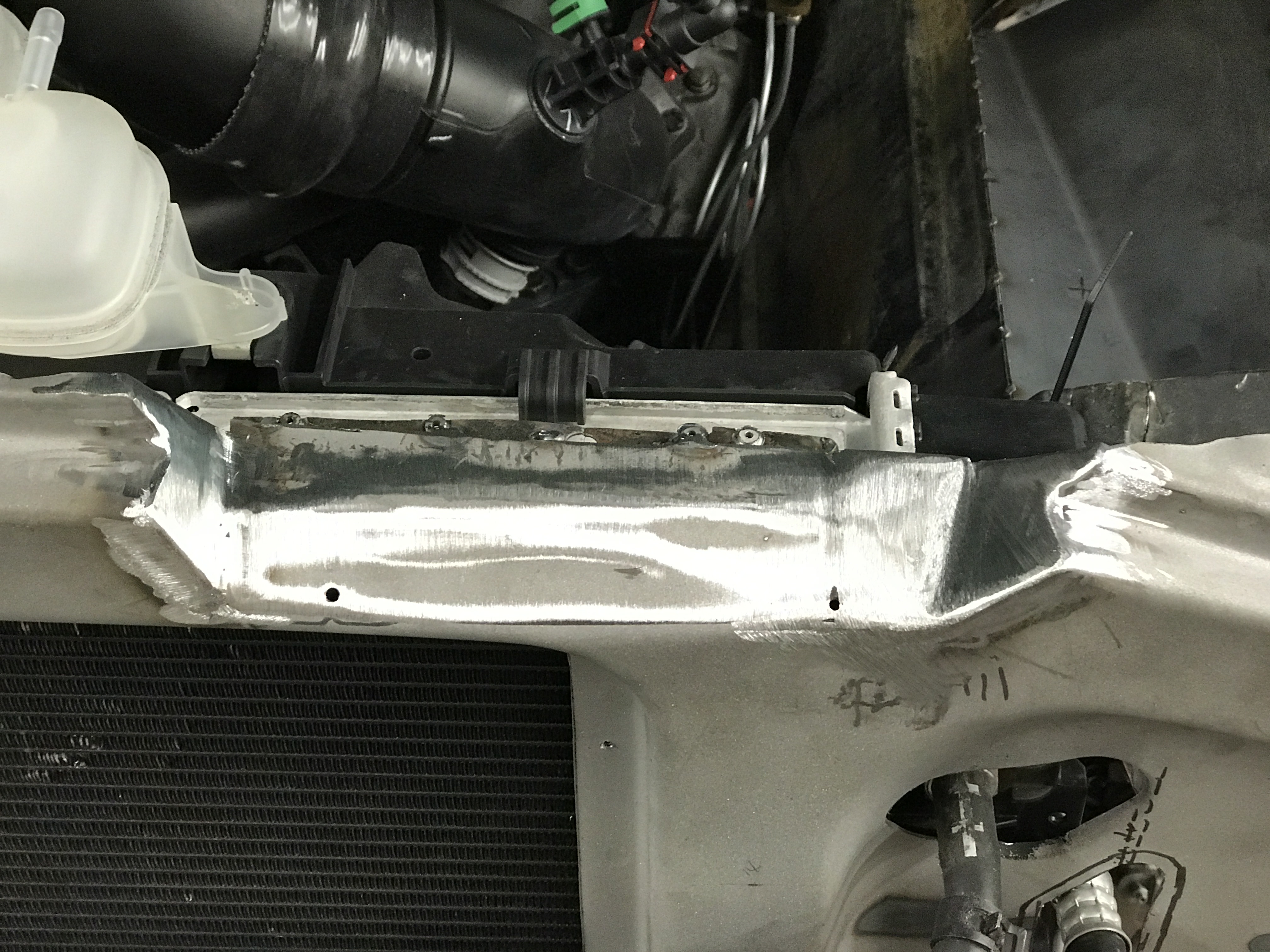

Had to do some mods to core support to make it all work. One was notching the upper portion for the functional Cold Air Intake setup.
Inner fenders needed a bunch of mods too.
