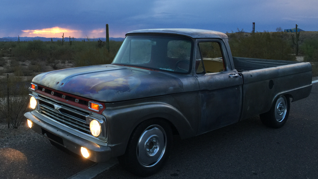

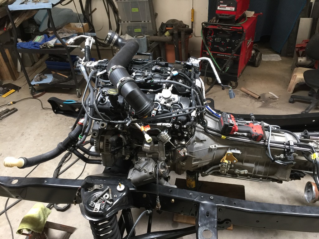

Messed with diesels for years and now switched back to older no emissions trucks.
This is a 1966 F100 with a full late model Chassis, Suspension,Steering, Brakes F150/EcoBoost/6R80 Combo.

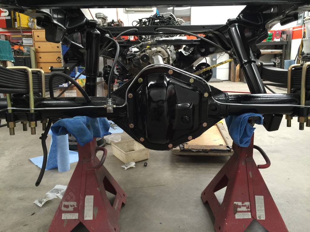

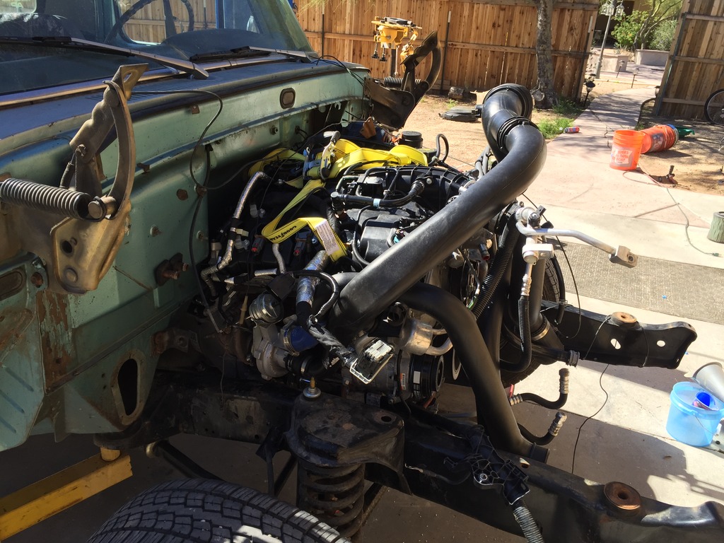

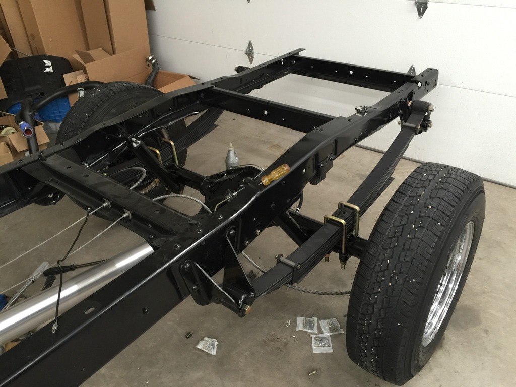

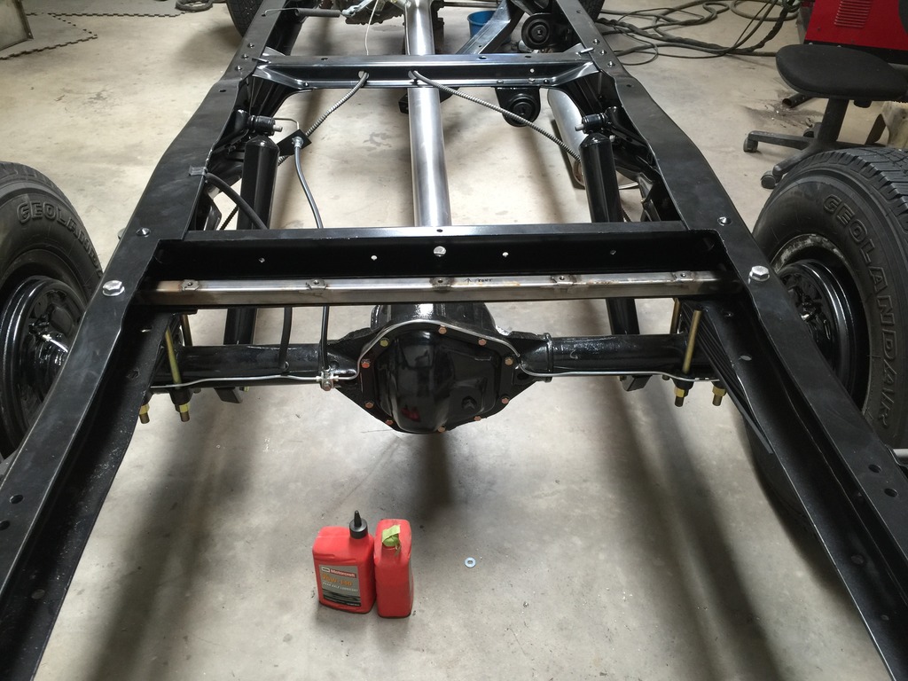

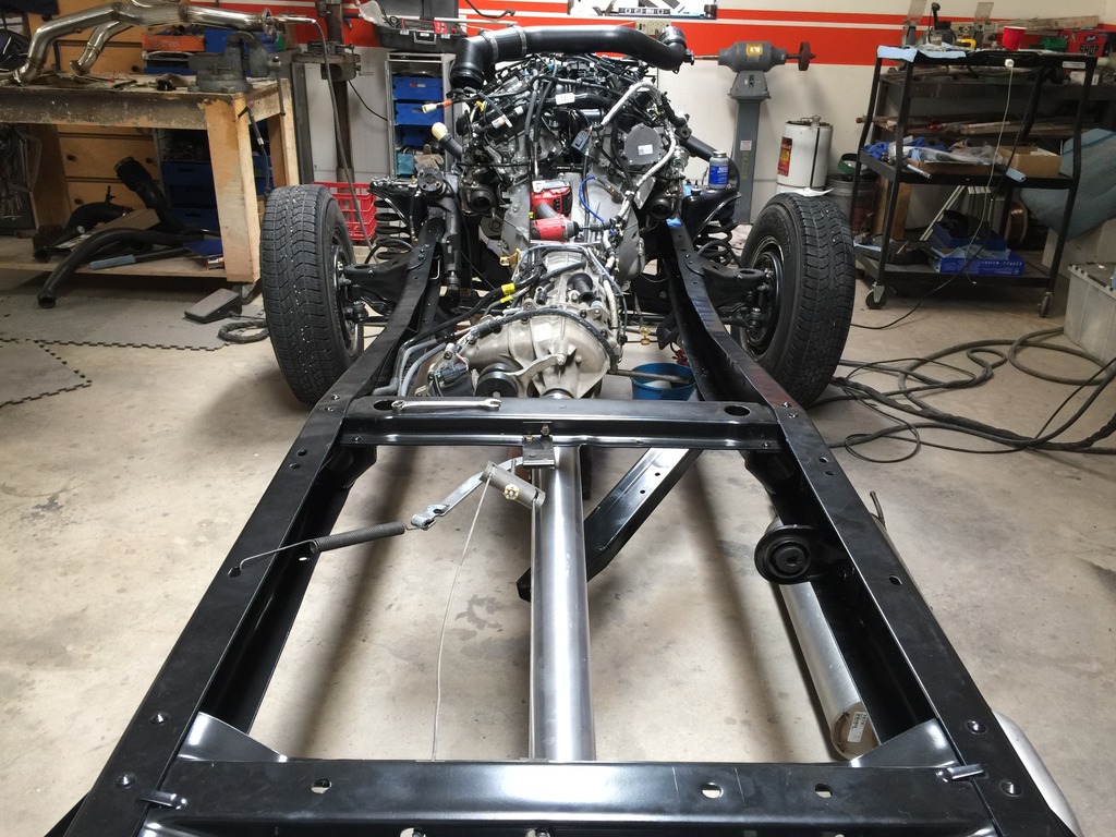

Truck 2 I call Eco 2. Its a 1966 F-250 with a 2015 3.5 Eco/6R80 from a 4x4.
Its a restored to stock 1966 F250 chassis with a Dana 60 that has been upgraded to current year standards. A bit easier to find parts if need arises. 3.54 Gears 4340 Axles, New Locking Diff.
This will be the "Sleeper" of the bunch with upgraded Ford GT Turbo's etc

Eco 1 has full 2011 Electronics Inc Trailer Sway Control, Anti Roll, Anti Skid and Anti Theft, everything a loaded 2011 F150 Eco would have. At the time when I started the build there was ZERO support so it was quite the chore getting it all to work.
Eco 2 Because it was a 2015 the Anti Theft system was a hard nut to crack just to get the engine to start. (Since then its been figured out how to disable the anti theft)
Eco 2 has just minimal electronics to run the engine and trans. The Dakota DIgital gauges will run off the Can~Bus system. I did have some Ford Engineer helping/doing the wiring.

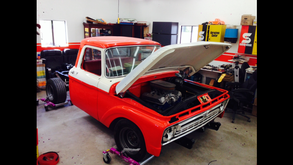

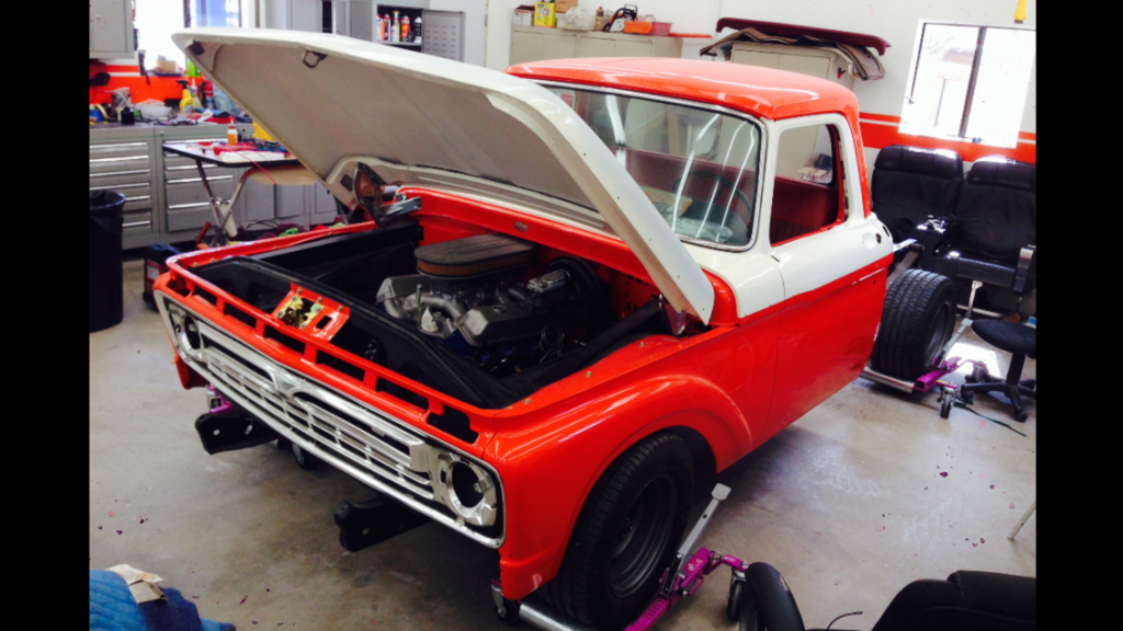

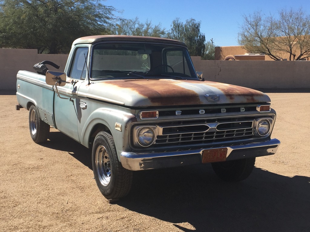

This one is Truck 3. Have owned for nearly 17 years now. Really gotta get it finished up.

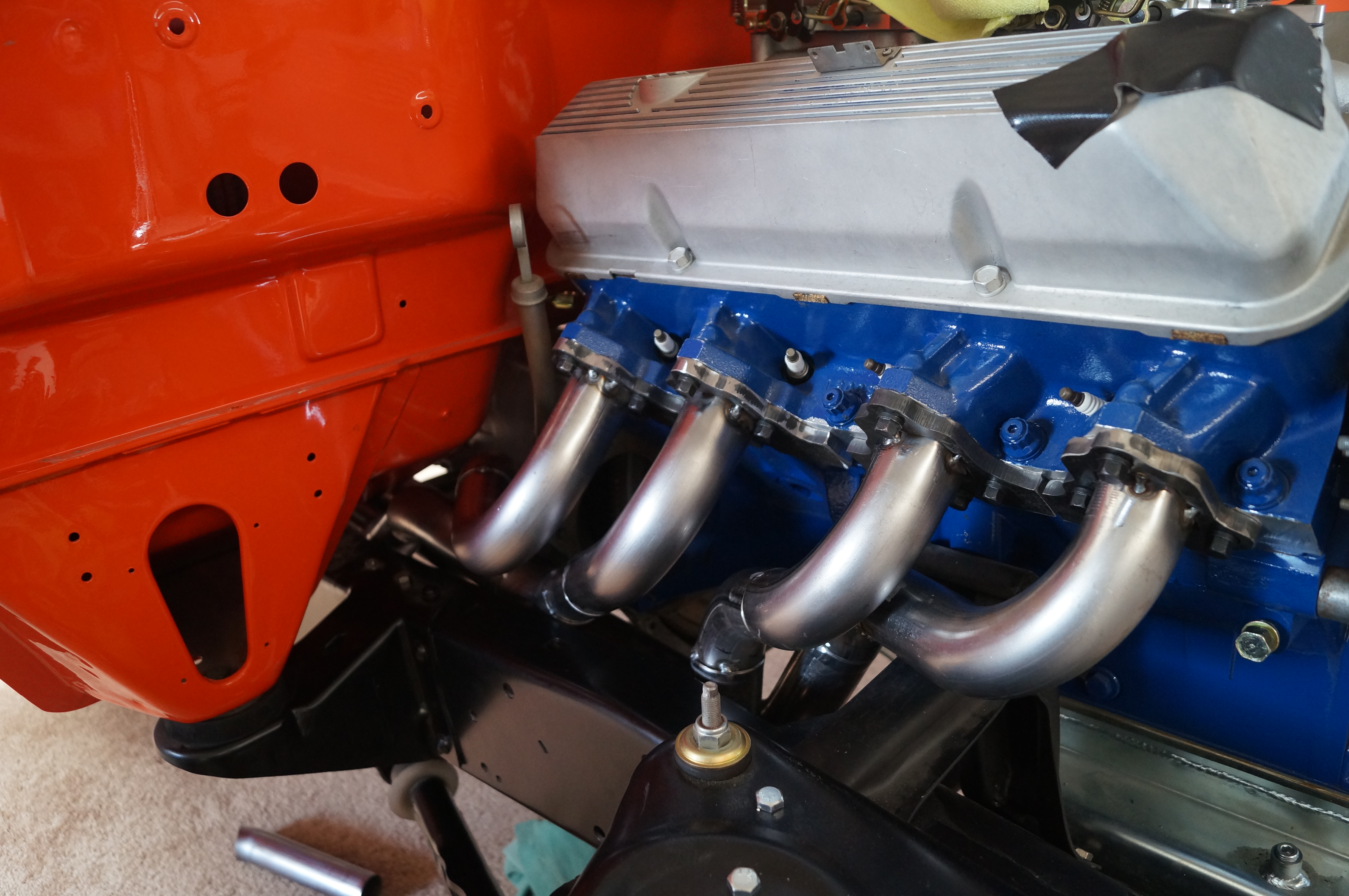

Built some custom headers for it too.
