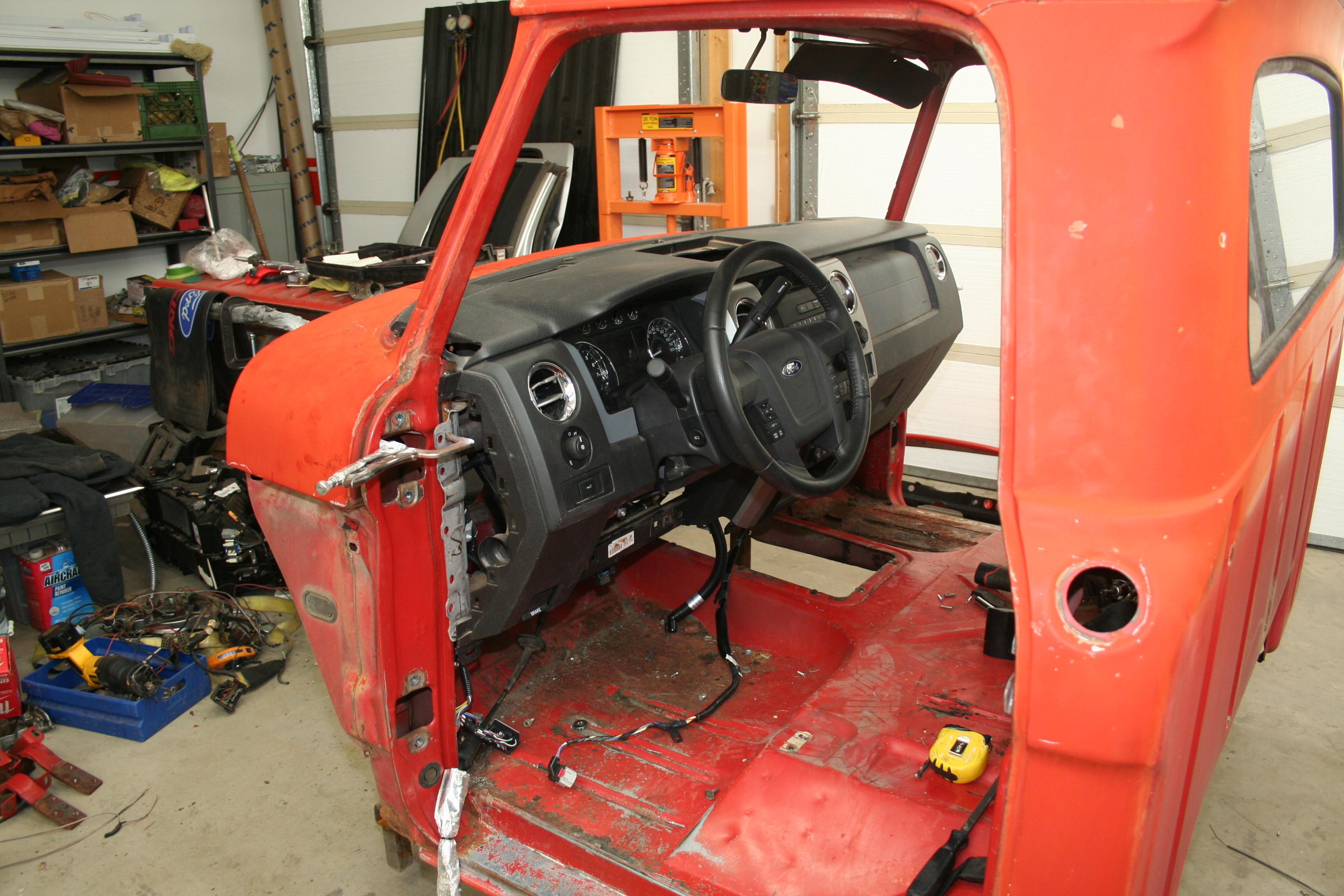

Driver View

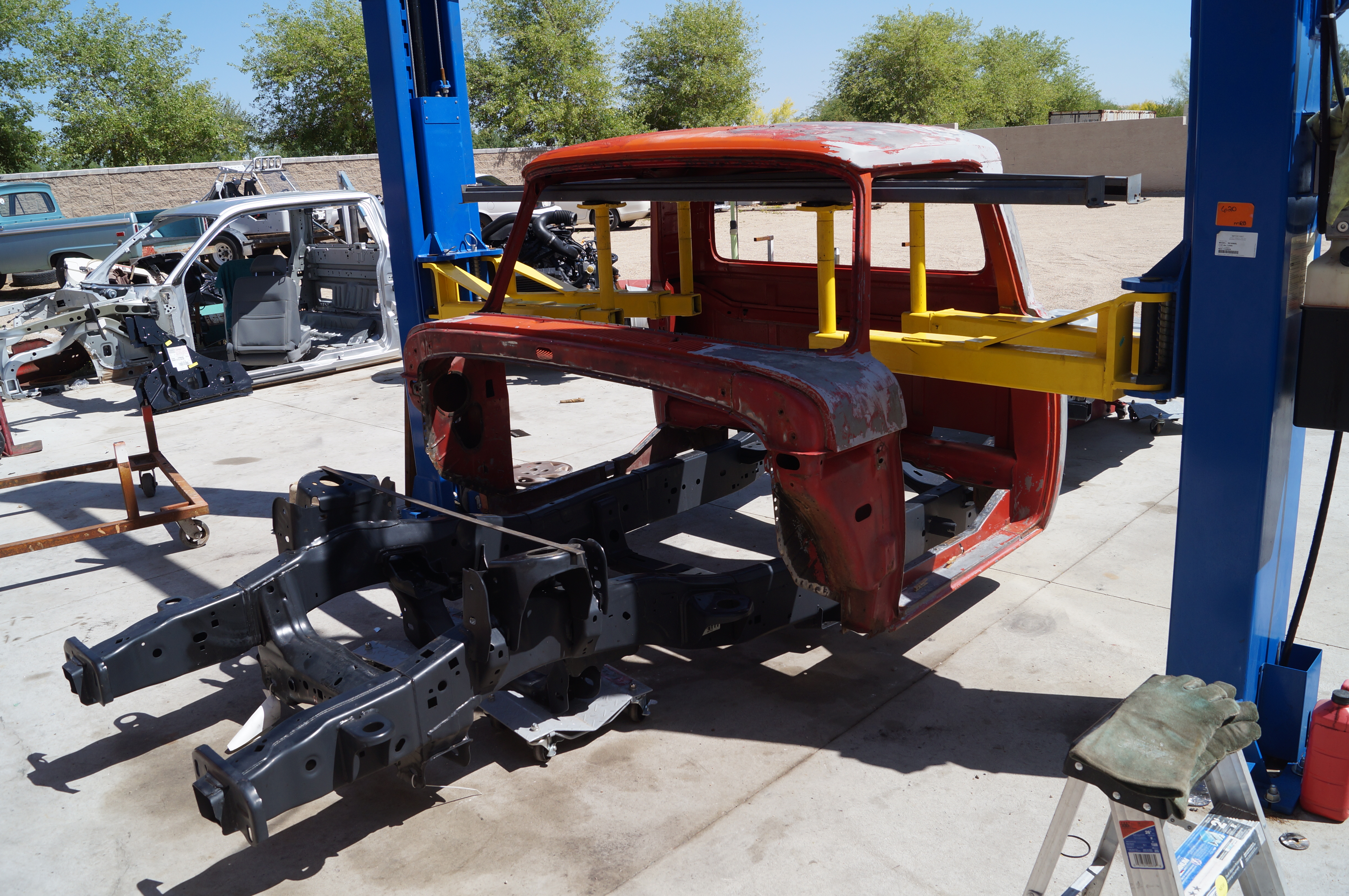

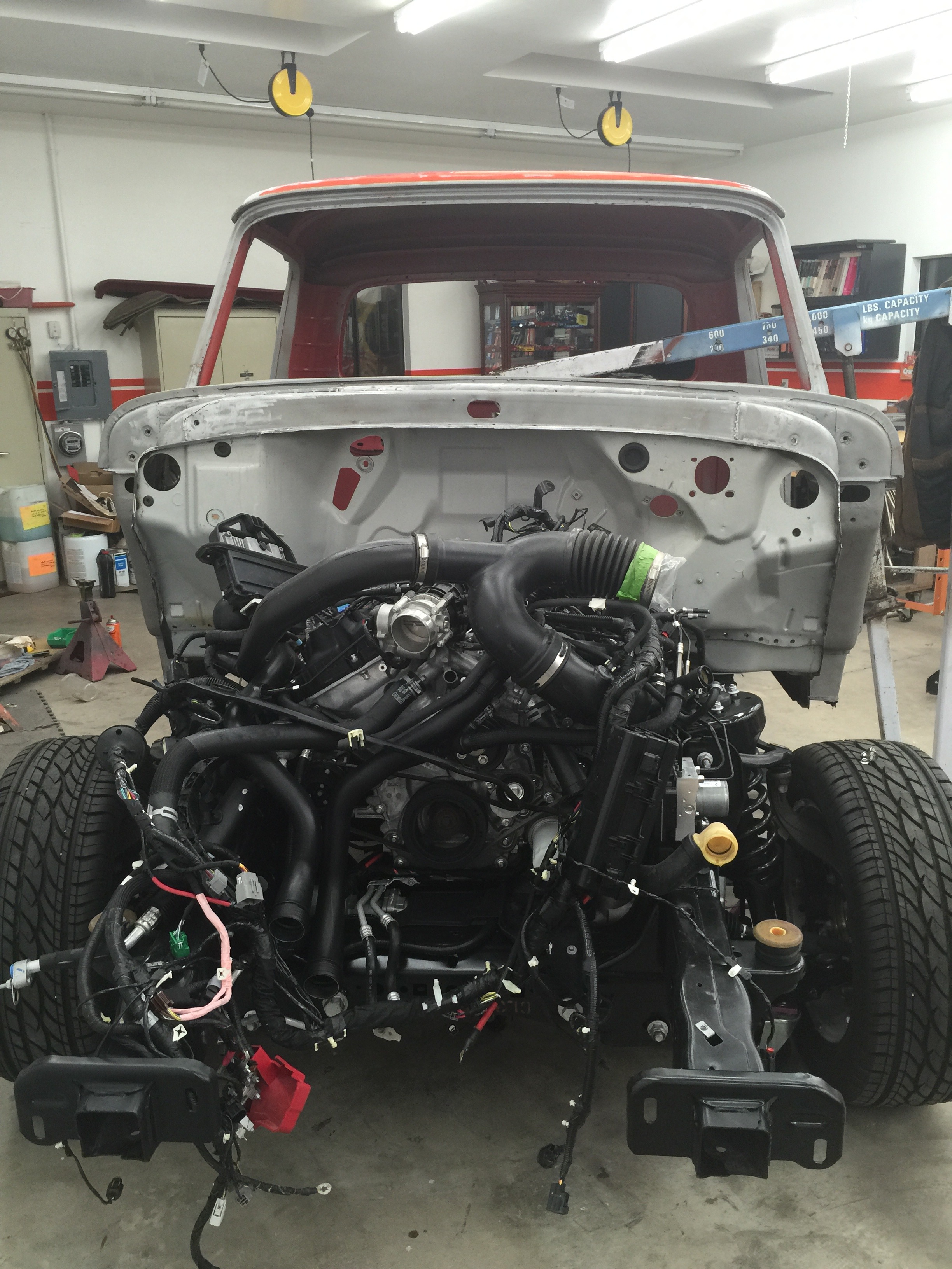

Fitting the cab to new chassis. A bit of work . .

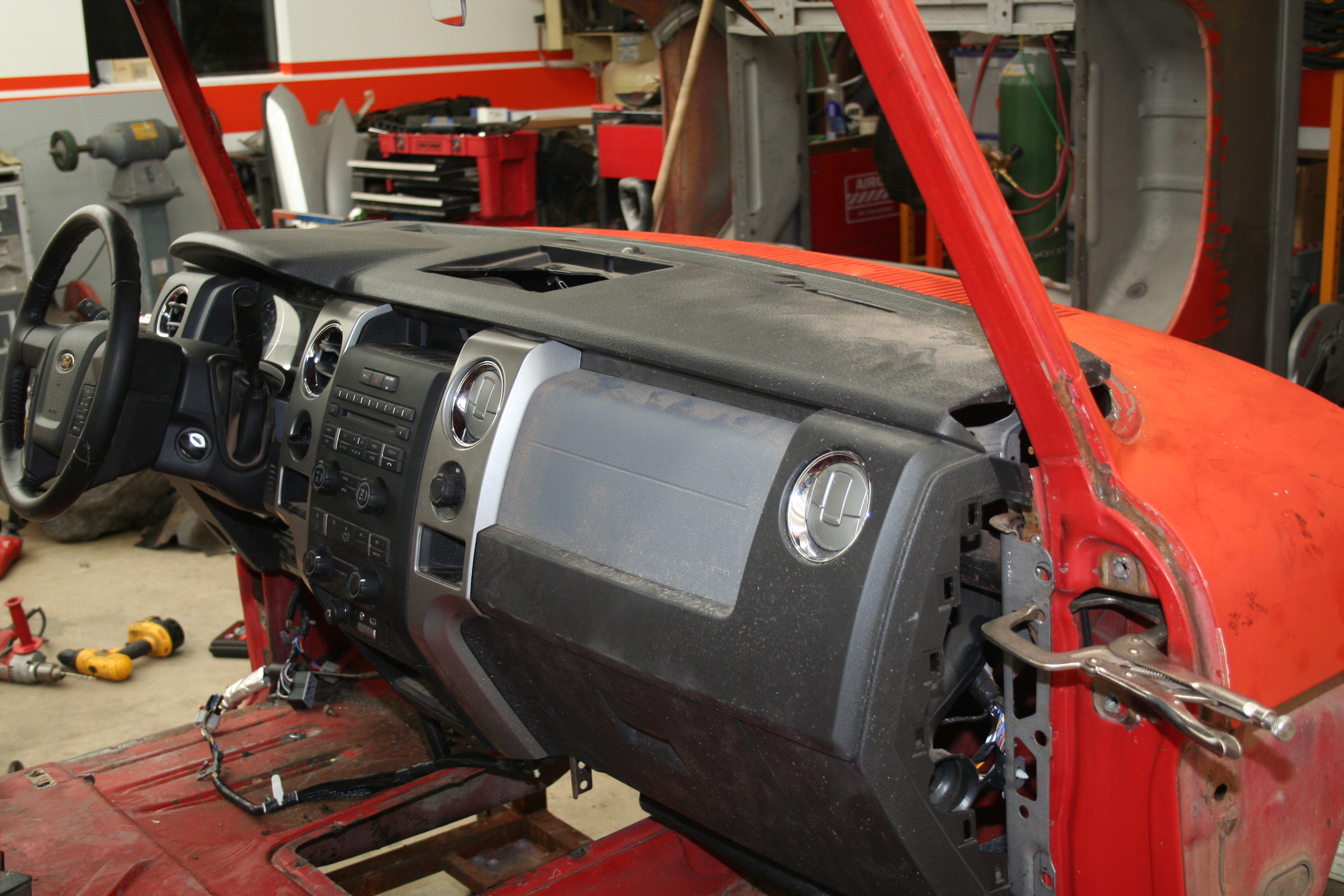

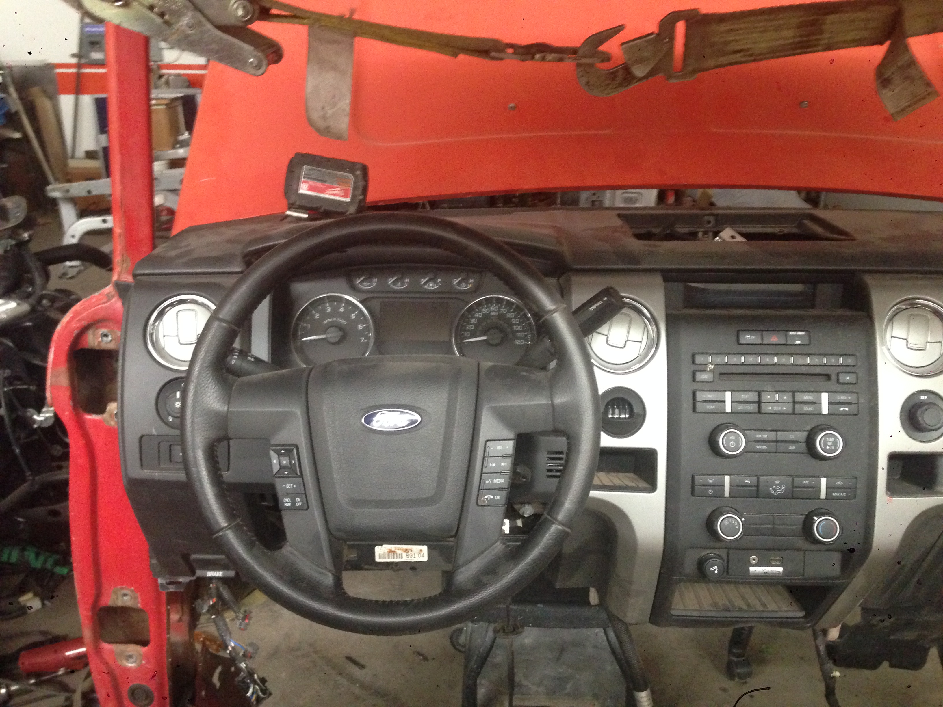

New F150 Firewall & floor installed into the '66 Cab

I'll be honest, I'm not a huge ford guy but I can't get enough of this build set. You did a great job putting the new dash in eco 1.

I'd consider myself a bit of a lunatic when it comes to detail, but fitting that dash in that truck would just send me over the edge. So good on ya man........killin it.

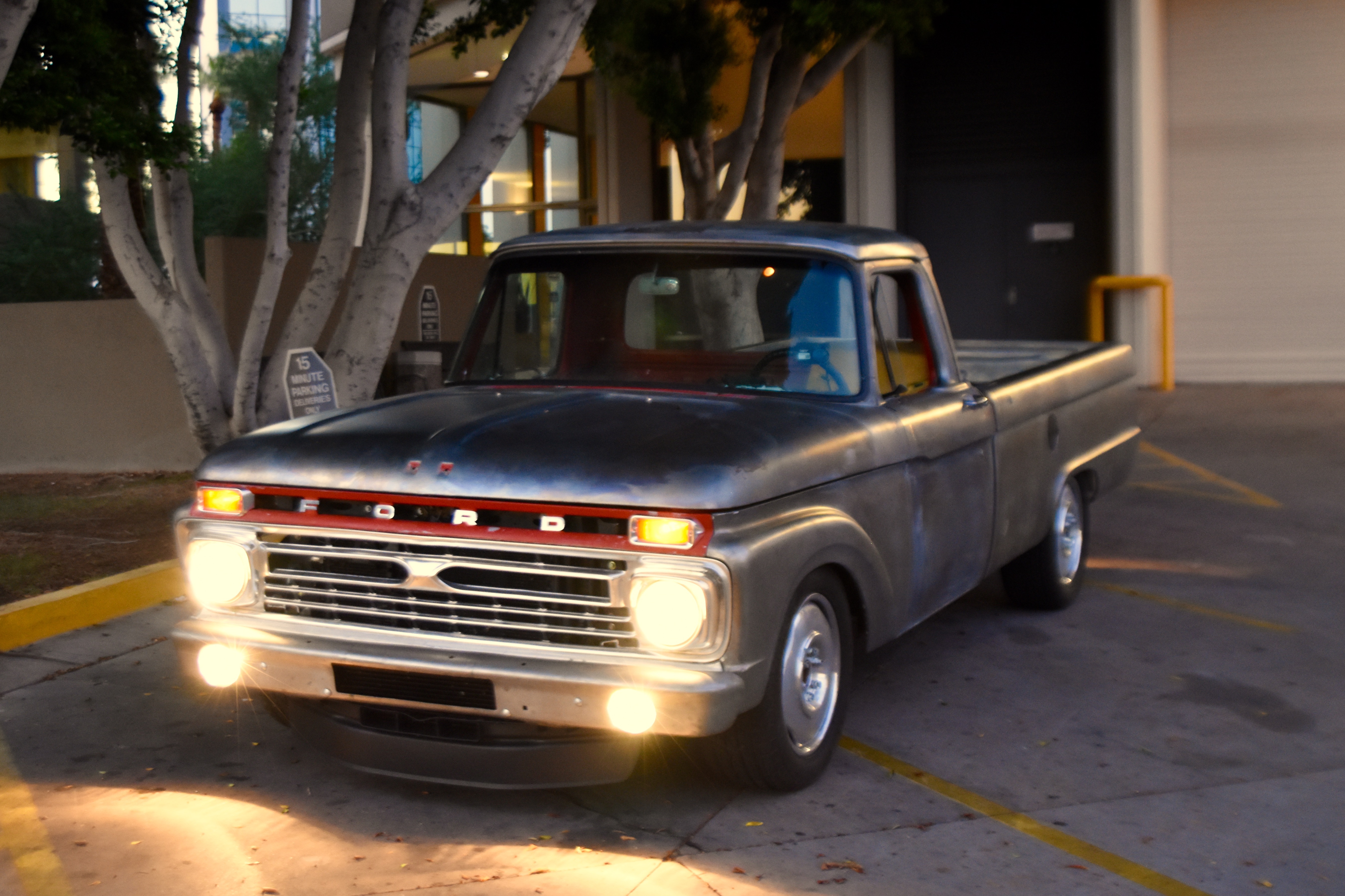

Today was Test Drive Day with Eco 1! Took to the Phoenix Metro Freeway System for a total of 215 Miles. I did find 24+ MPG @ 75 MPH
Uploading a couple video's now.
A few pics taken DownTown Phoenix.
