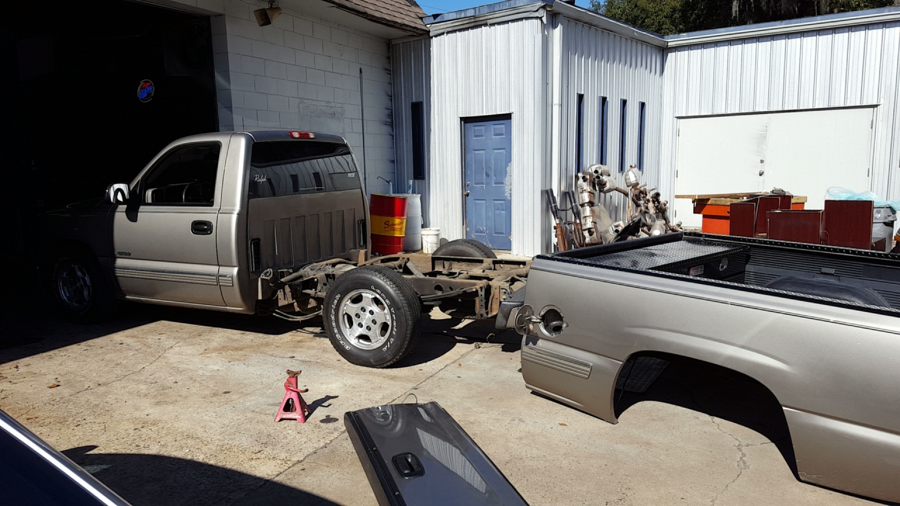

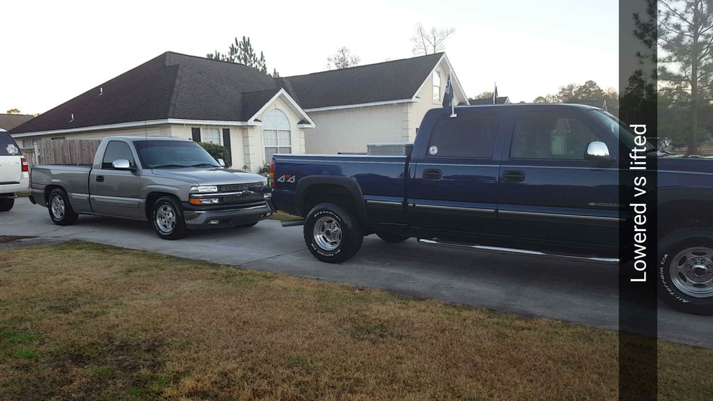

Update 1/17/2016: I did it !
Only question is my bumpstops are rotted off so its just the metal piece and its sitting about 2 inches or so from them and if i hit a bump on road i bottom out pretty easy but im unsure if its my stock shocks with 200k miles or just how it is. so should i buy new shocks all around made for a 2/4 like belltech street performance shocks and a new bump stop or just keep my stocks and get a c-notch. I REALLY dont wanna cut the frame. i know that you're beefing it up and stuff but my family members of mine sell cars and they told me that if i cut the frame someone will say the frame has been damaged and try to offer me less even if it is professionally done just cause its the FRAME! not like a fender or something replaceable its the frame. So do you guys think new shocks and bumpstops will solve my problem or should i just notch the frame any will new shocks make the truck sit any higher since the current ones are maybe sagging?

Looks good. IMO notch it, it's super easy. Along with new shocks it'll ride fine. Even with a 4" drop on belltech street performers I would bottom out so I used a DJM c notch to fix that. Comes with small bump stops also.
