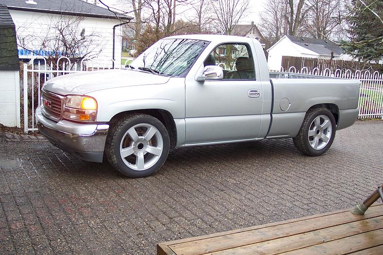

I,ve had the truck for 2 yrs and the engine for 4 yrs. Still need to get Inj's,plugs & wires yet. It's a 99 rcsb. Was blue and tough replaced frt fenders,rockers,cab corners and box sides. painted Cortez silver. Interior dirty old blue cloth switched to graphite,leather seats pics dont do the seats any justice. Just need rear window installed and the cabs done. Engine is a 408, TBSS intake, Holley 90mm TB,Kooks 1 7/8 f-body headers,comp cam 281LR HR13 231/239 617/624 113 deg. Heads are 243's p&p. Eagle crank and rods, aries pistons. Have'nt decided if I should use stock rockers or the Crane golds I took off the silverado. Hope to get it done for this summer. Heres some pics.

It's all ready dropped 3". its enough for me dont like the scrubin and bangin. Lookin for go more than show.
