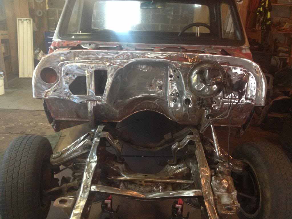

Had to name this truck SilvyChev II, as my first build truck (Orange 90' C1500) is dubbed " The Chev".
Dyno results page 7
I picked my SilvyChevII up from a guy in Maryland for $2900. Plans are to make a really fun street/strip truck. Turbo LQ4 with a muncie M22 4spd. This is my second turbo build. Any input/opinions are welcome.
Went and bought another 2005 LQ4 6.0L from the junkyard with 150K. (2005 year so it would have the better rods) Cleaned it all up. Swapped in a Isky 218 cam from Stock48 and found a really good deal on a used victor jr with an aluminum elbow. Bought a set of 85lb injectors. Heads were Hand ported by me just on the intake runners and did a valve job. Everything else is untouched (stock bottom ender)
Tranny was build by a local guy here in CT. Its a Muncie/Autogear M22 2.56 first gear. Should handle about 800hp with all the goods. Plus my custom powder coated bellhousing gives it some character.
Clutch/flywheel is from Mecleod RXT twin disk, should handle the abuse.
Bought a S400-75mm turbo with a T-6 1.10 housing.
Made some custom engine mounts and set the engine on the chassis. Started to mock up the turbo location and hot piping.
