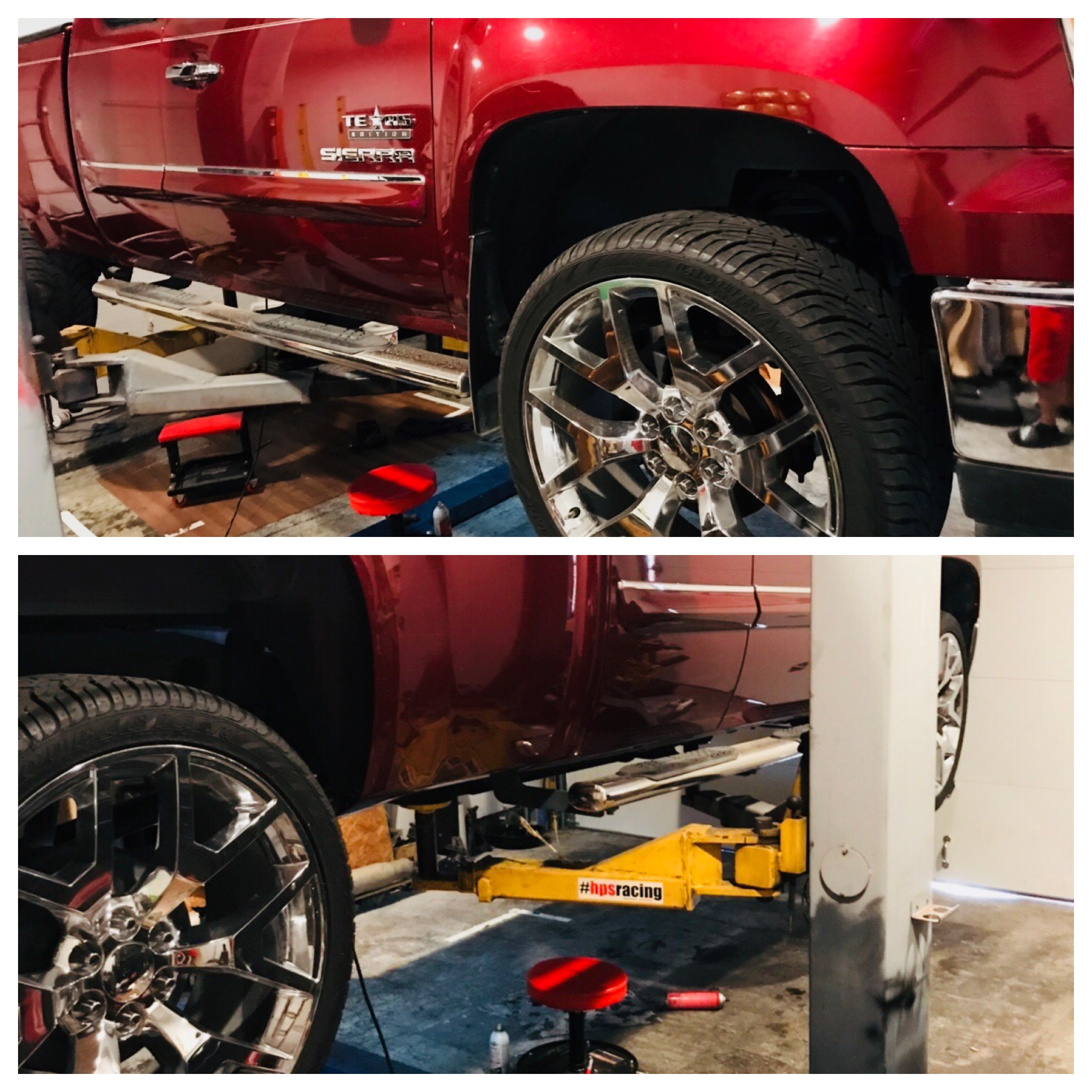

From: Houston
Man you have my attention with that lift in the garage! Which one is that and have you had any issue mounting it to the slab of you house? Are you ceilings standard 9-10ft?
It's an Atlas lift. No issues with the slab at all (it's a 9" slab pour). It's been up for close to 3 years now and it's handled everything I've thrown at it. Hell, it survived the fire (save for the hydraulic pump and a hose)!
My ceilings are right at 9' 10" and the lift post clears
It's about the best $1900 I've ever spent - in relation to cars!

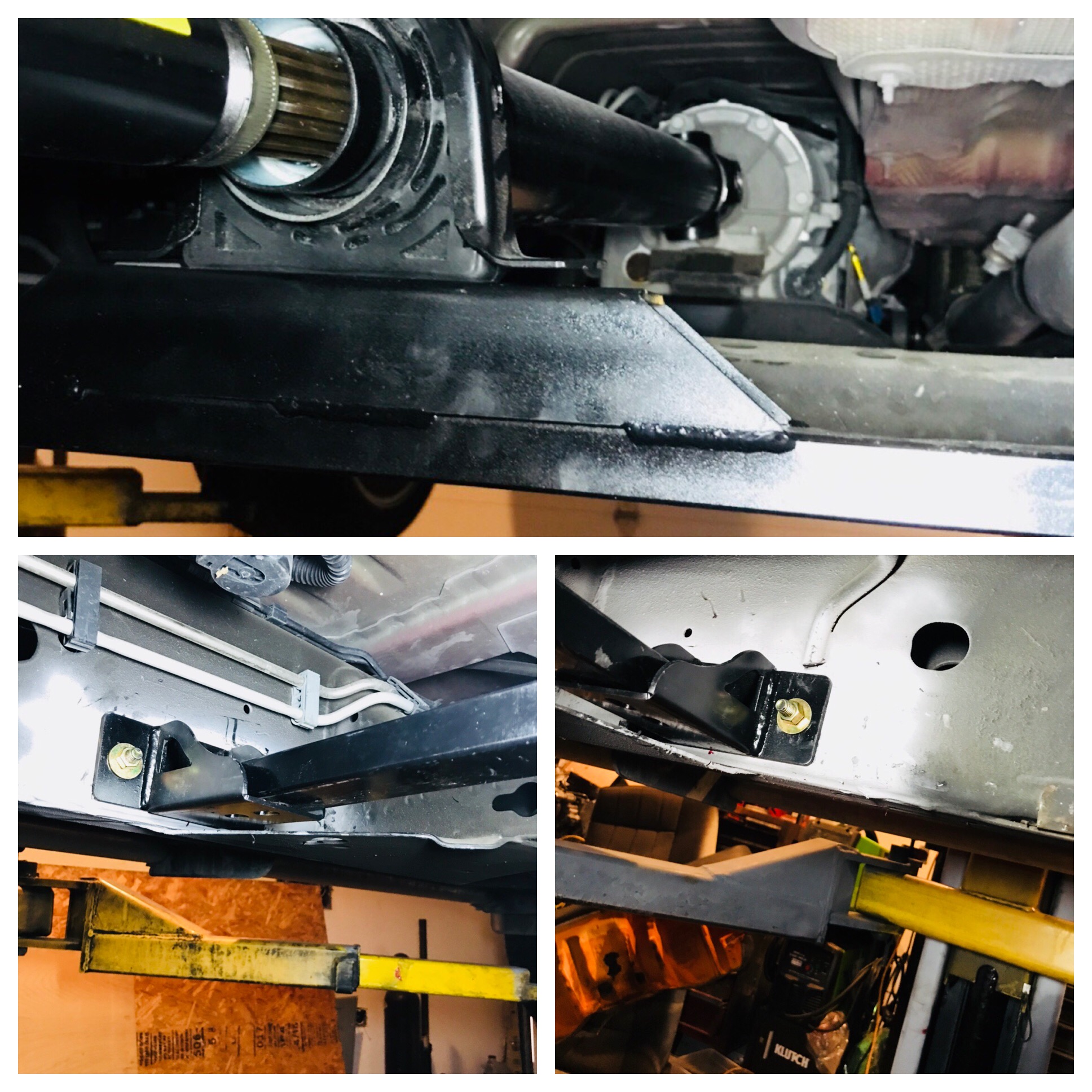

Default Driveshaft - Finally
So I grew tired of limitingthe truck based on the stock aluminum can drive shaft (never drove it over 95 mph).
I ordered a 2 piece unit fom Performance Driveline about 3 months back and finally got around to installing it.
The hardest parts of the install were cutting about 4” off the muffler hanger on passenger side (see pics) and drilling through the frame (it really plunked my drill bits). I don’t know how people did this on jack stands (must of had plenty fresh drill bits) but I’m thankful for having a lift in the garage, that’s for sure!
Rides smooth as stock and I’m no longer worried about the driveshaft exploding every time I crowd the loud pedal.

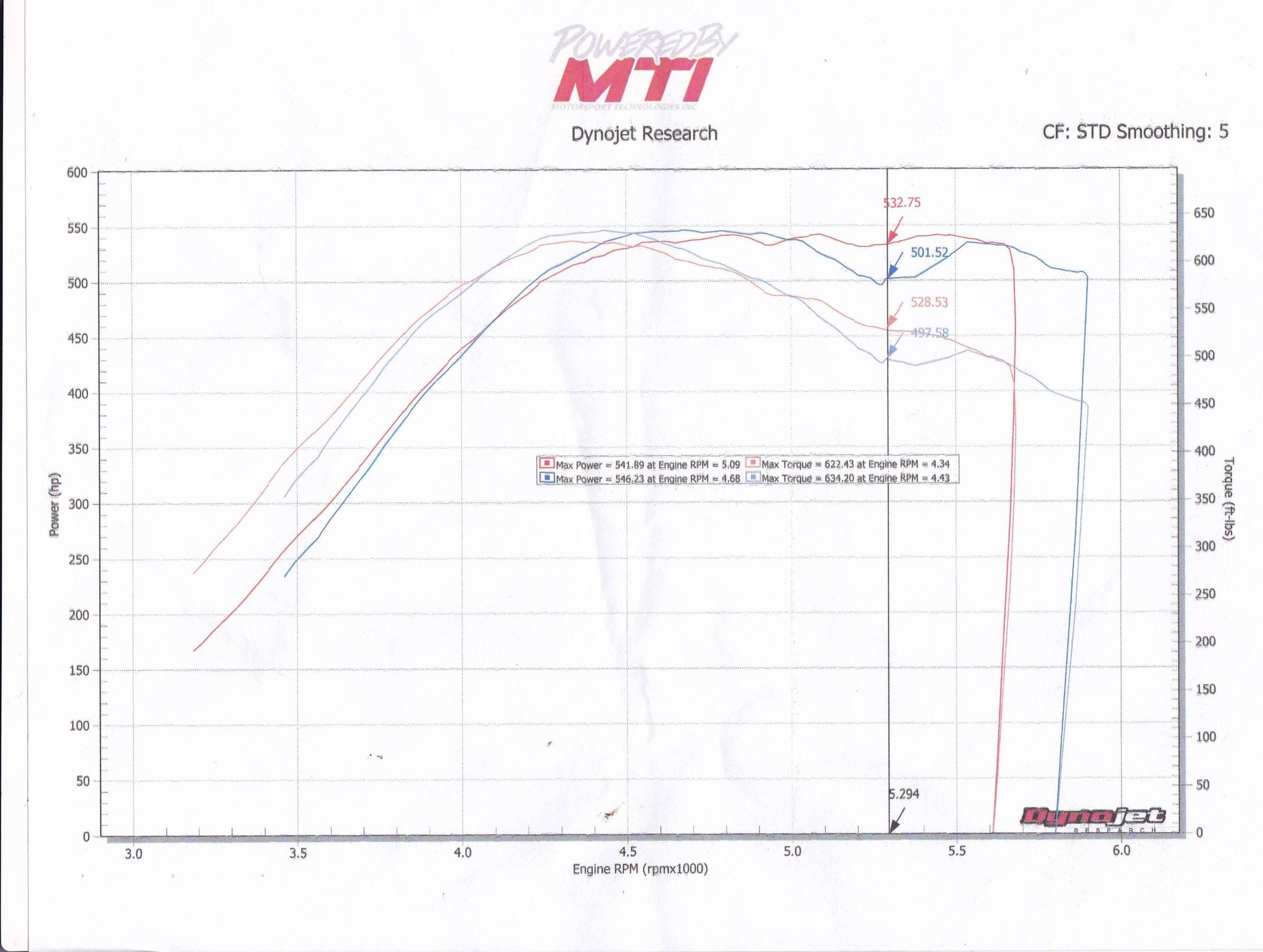

Default Some Updates - DYNO’d Finally!
Finally got the tune decently ironed out - not perfect but it runs/drives fine.
At 14#s above atmospheric pressure it made
546 HP
634 Tq
This was on 10 Gallons of E-85 with the rest of the tank being 93.
Not too shabby for a stock 5.3, VSRacing 78/75, 80# Deka, E-85 sensor and a STOCK flex fuel pump!

Wow, that's awesome! I didn't know the stock flex fuel pump would support that power either.
I’d read a few postings here, where they went in the high 6’s for HP with a stock flex fuel pump, so I figured I’d leave mine in.
