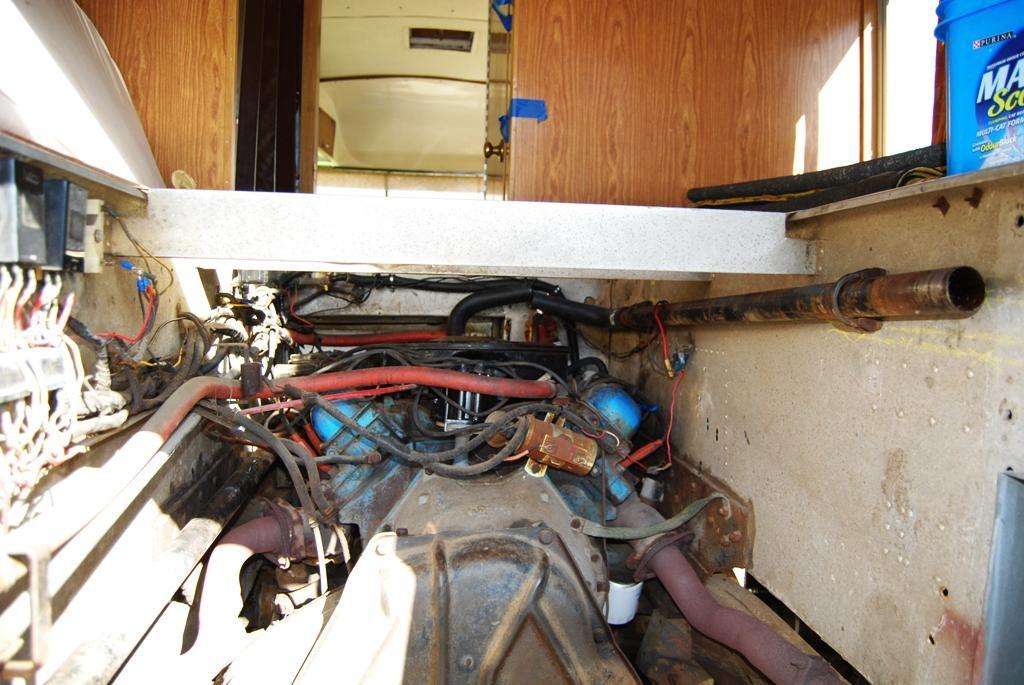

I am one of those guys who (so far in life) have never learned how to weld.
Because I can not weld, I make templates or drawings and have the stuff made.
How I will be doing the power-plant install is no different.
I have purchase 2"x2" cedar because it is light weight, easy to work with and it will last longer even if it gets wet a couple of times.
My plan is to make a cradle to mount in UV231 that will house the entire power-plant with radiator.
My design is so that the enter power-plant or drive-train can be removed out the back for repairs.
Repairs like; a head gasket, intake or even exhaust manifold, giving full access to them making it easier to work on.
Once something like a head gasket, exhaust manifold gasket or even intake gasket has been repaired;
I will be able to start the engine, bring it to operating temps, check for leaks and top off the coolant.
All the while having the power-plant sitting outside of the vehicle.
Once I'm 100% sure it has no issues - I can then slide the cradle with the power-plant back into UV231.
FYI - If you did not already know this. Some Tanks and most City buses engines are done this way.
Having been a mechanic in the USA Army and seeing some buses - gave me the idea.
I knew I wanted a better way to do major repairs on a power-plant that was in a tight engine compartment.
So I will make the cradle out of the cedar 2X2 and then take that to my metal guy.
Once he has made it I will return with it and fit is in UV231.
Here is a link to the post (dated January 28, 2016) where I talk about this.
231 Ultravan Build Project
And here is why I want to be able to remove the entire power-plant making it as easy as possible to work on. I'm not getting any younger. GRIN
This Olds 455 is in another one of our Ultravans (UV520) that has either a bad exhaust manifold and/or gasket.
Too tight for me to work on as I am getting older.
