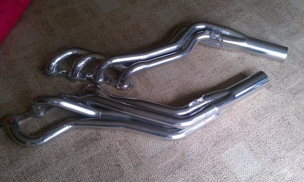

Proud new owner of these:
1 3/4" LTs with 3in collector....Better than the 1 5/8" mids I had..I also have some custom made Cal-Vert Split Mono Leafs sitting at the house...

why not 1 7/8? awesome build. i'm building a SCSB LS2 s10 myself at the moment.

They don't make any production inside the fram 1 7/8" headers for S10 LSX swaps..They do have some with primaries outside the frame in 1 7/8" , 2" and stepped headers also...And thanks for the compliment...The new engine should be a beast when she's done!!!!
