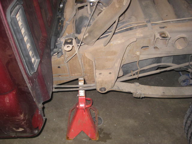

Well I have had the rear lowering hangers for a few months now, so I figured I would get up this morning and install the hangers. All I have to say is, it is not an easy mod!! But if you have a torch and a good friend to help you take the bed off the truck, it will save you hours of work.

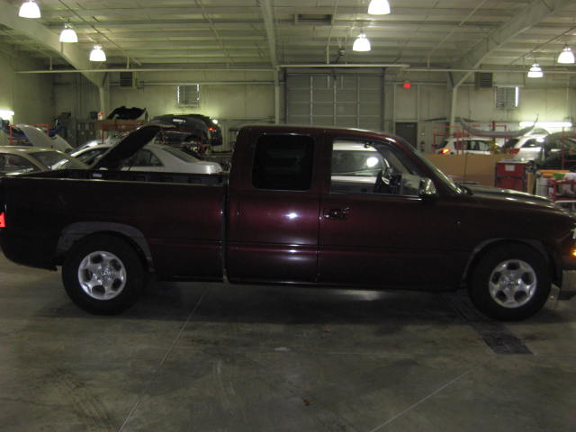

before I started
took the bed off

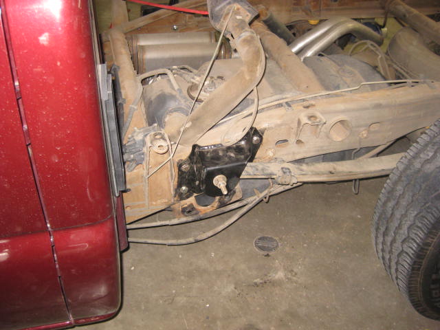

torched the heads off the rivets.
and bolted the new hanger on with the supplied bolts.

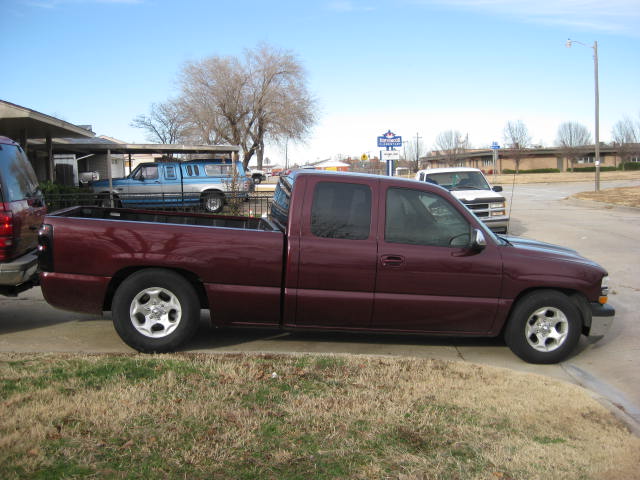

I did it all in 4 hours and never even dropped the gas tank.
After it was all done it looks good, but I need to do a c-notch and get some movement back in the rear suspension.

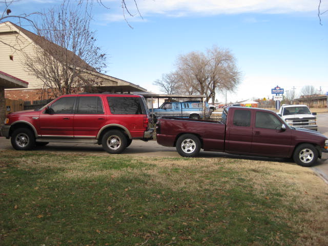

My truck and the wife's truck. lol

Looks like it was worth the work. Definitely has a much better stance! Looks good.
Old Dec 15, 2012 | 11:32 PM
slowxcab33's Avatar
Joined: Jul 2010
Posts: 56
From: Moore, oklahoma
Thank you sir, aside of beating you to death! Yes it was very worth it. I need to c-notch it now.
