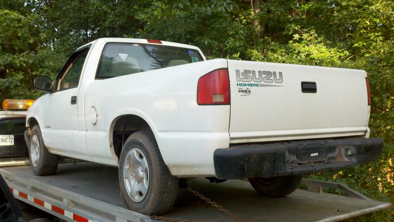

I am in the planning stages of building a 98 hombre. Basically an S10. This will be my go fast ride so the trans selection will be based on what will perform at the strip. Research points to the glide. Any advice on doing this would be great.
Plans for the setup...
junkyard LS
ls9 gaskets and studs
222/226 59X/59X 116 cam and dual springs
150 shot until I can go turbo
built glide and 4k converter
explorer rear end ??? maybe
n20, cell, and battery in the rear of the bed
This is my first build without being limited to daily use so there is no telling where this will end up. Please give advice if you have knowledge that will help.

Spot saved for initial pics....
