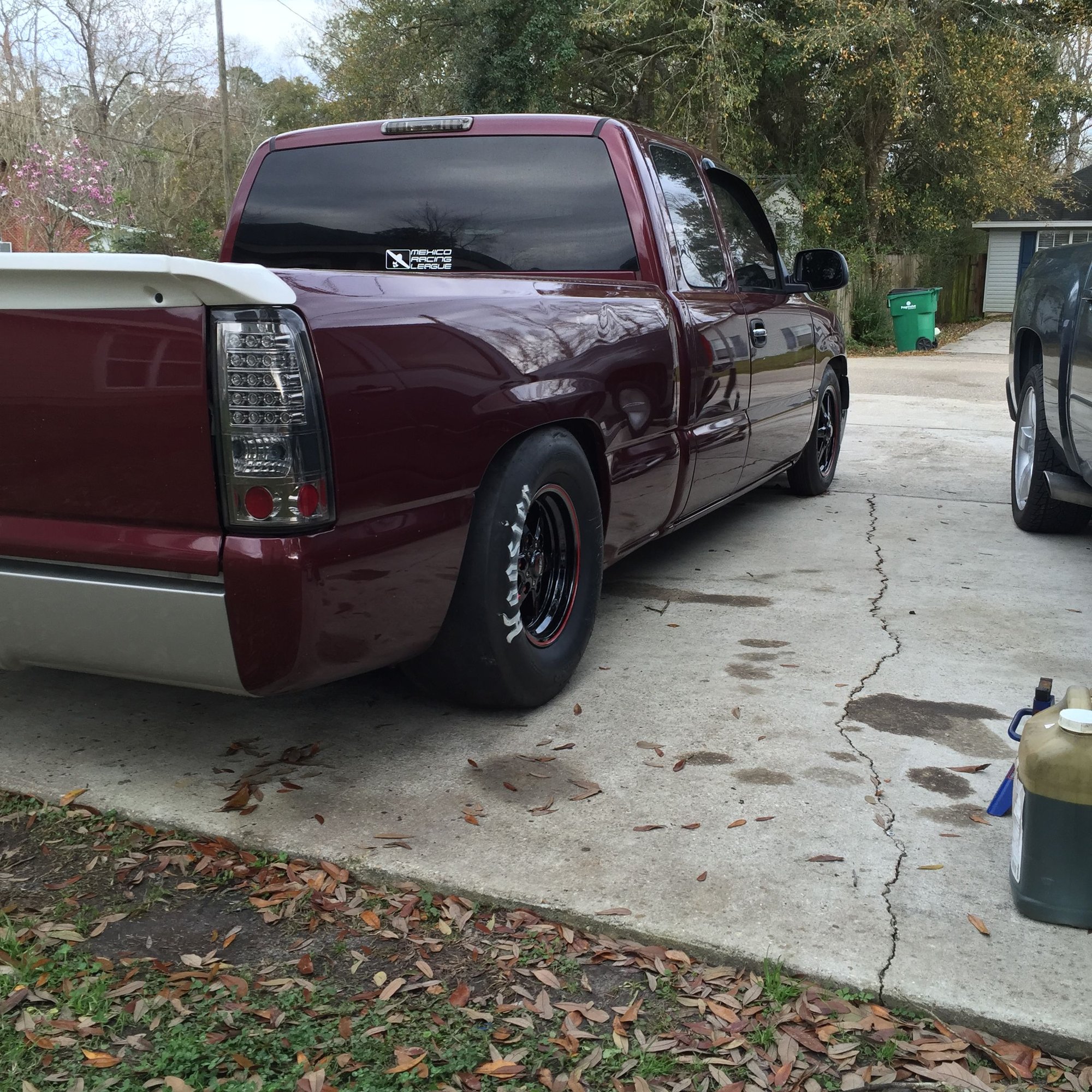

Suspension is done and she's back down sitting on the drag wheels.

Looks good! I love that color.
I'm not in love with those tail lights, I prefer the stock Silverado tails. But to each his own!

Haha yeah I don't like those tails at all but haven't bought a set of 03 tails yet

Money shot!! Looks good man. Shocks relocated to rear? Can't wait to see what times this will run

very nice build, only changes id make would be fit a super vic 4500 and get those heads cnced and ported nicely

Yep double adjustable qa1's out back.
Waiting until spring and adding dual adjustables up front also, building a fuel cell for behind the axle, adding a direct port, and if money is there sending heads and intake to Frankenstein to get worked and matched.
