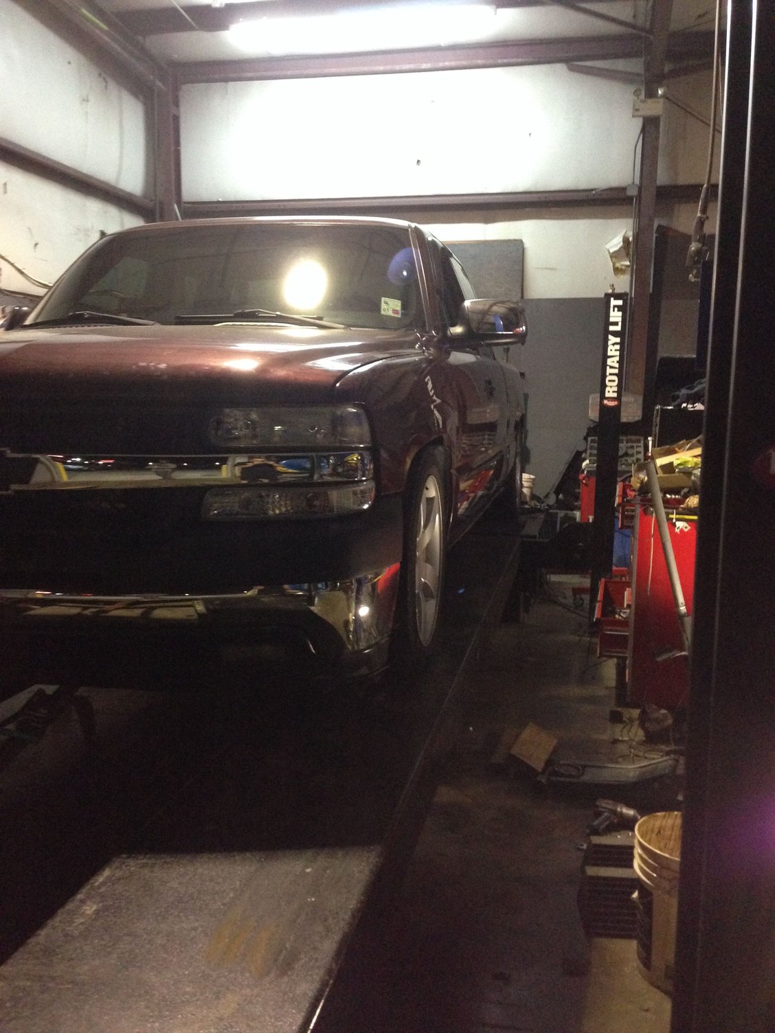

Figured I would start off with a little bit about my truck. It's an 02 Extended cab 4.8 purchased beginning of 2012.
Started off pretty basic
Did the run of the mill drop with some 24's and HD front end swap.
Being my first v8 vehicle I figured it was time for a little performance to the 4.8. I did standard K&N intake, OBX long tubes, trutrac with 4.10's, had a local shop build the 60e with TB converter, and did a street tune. This was a fun time playing around with friends until about 5k miles in the built 60e decided to grenade itself. Had a warranty on trans so I brought it back to the shop who seemed very funny about things. Shop had my truck 6weeks and I finally got it back. 15 miles into the trip home and I hear a clunking and the truck just coasts. I crawl under the truck to find the rear part of the driveshaft dangling on the ground. As I start to look there are only 2 trans bolts holding crossmember neither of which are tight, big dent in the steel trans pan which is leaking (and not my $200 B&M pan I put on), and they never tightened the straps on driveshaft which is why I fell down and beat up the underside of my truck. I knew then I could trust nothing about that trans so off to a buddies speed shop it went.
After the truck sitting at my buddies shop for a week I decided to take it a little farther. We did a 4l80e swap with 3600 multi disk circle d converter, and a Nitrous Outlet 78mm plate kit. Truck was way faster after that.
Ended up running a 12.21 @ 109 1.68 60' just running clamped springs and 28x10 slicks on stocks.

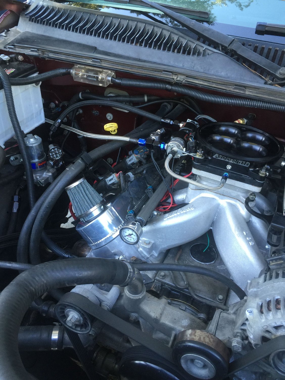

At this time I was already hooked like crack and I can't leave anything alone I took it farther. Being rotating assembly was trash from the motor, I decided to step it up to a 408. Compstar crank and rods with wiseco nitrous Pistons. Thinking since I was this far keep going so I added a set of L92 heads with the LS3 hallow valves, a victor jr efi manifold topped with adaptor for accufab 4500 throttle body, and a NOS 4500 big shot plate using my valves from the nitrous outlet kit.
Here is where we are now. I got the motor in and running and it's a monster. I've been working on suspension setup I've added a set of smith race works assassin bars and along with relocating shocks to behind the axle, and just removing minor stuff from the truck to see about running some killer times.

Very nice setup! I like the truck!
I hate to say it, it always seems like there is shady dang people out there doing some kind of work. That's why everyone on here usually ends up doing all the work themselves. Glad you got it lined out. I'm in to see times out of the 408 and spray. How big of a shot now? 200?

That's awesome!! The new engine looks killer!
How big of a shot did it take to run 12.2 with the 4.8?

Love the truck, what's that like a 4/6 drop? Looks good man

Thanks everyone! Yeah I have found some shady workers for sure. 12.21 was ran on a .078 jet which was about a 200. I haven't tuned the nitrous yet but the plate currently has a 200 shot jet in it but once I send transmission out to get rebuilt I plan on doubling the shot size. Truck is about a 4/7 drop maybe a hair more, and the assassin bars were purchased directly from smith race works, I had to order them on the phone because the website wouldn't let me.

200 shot with a stock cam?
Old Dec 16, 2015 | 04:51 PM
JB_Stylz's Avatar
Joined: Mar 2013
Posts: 24
Yeah haha needless to say stock cam and stock intake it fell off pretty bad up top.
