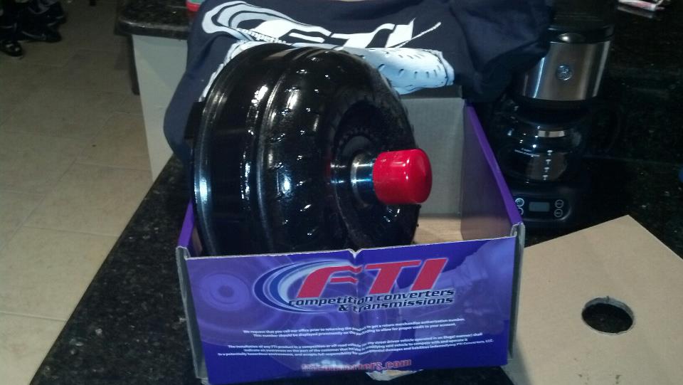

Well look at what come in today!! Puzzle piece is coming together finally...
It's not cheating it's the competitive edge!
