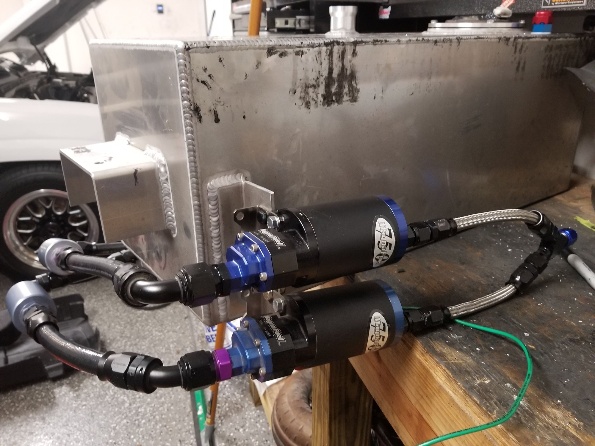

Got the second pump on just need to wire it up and ill be heading back for more dyno time. 2nd pump will be on a 2psi hobbs switch

should have plenty of fuel this time around! What size feed line to the pumps and to the rails? I just purchased 2 AEM 400s for my truck. I run a dbrods cell as well.

Originally Posted by brandon6.0
Edit** never mind on the fuel line size and routing. Saw u posted it a couple posts back.
incase anyone else doesnt wanna go digging. I'm running 12an to the inlet of the pumps and -8 out of each pump to a -8 Y fitting out to the rails

If you use a straight piece and a 45 on the Y the lines from the pump will be parallel and the line to the engine will be angled up already so its easier to run

My cell has twin -8 fittings at the sump. U think they could flow enough for twin AEM 400s parralel like yours?? Was gonna reuse my -8 feed and -6 return.
not sure I'd call aem. Magnafuel recommends 12an on the suction side of these pumps to prevent starvation
