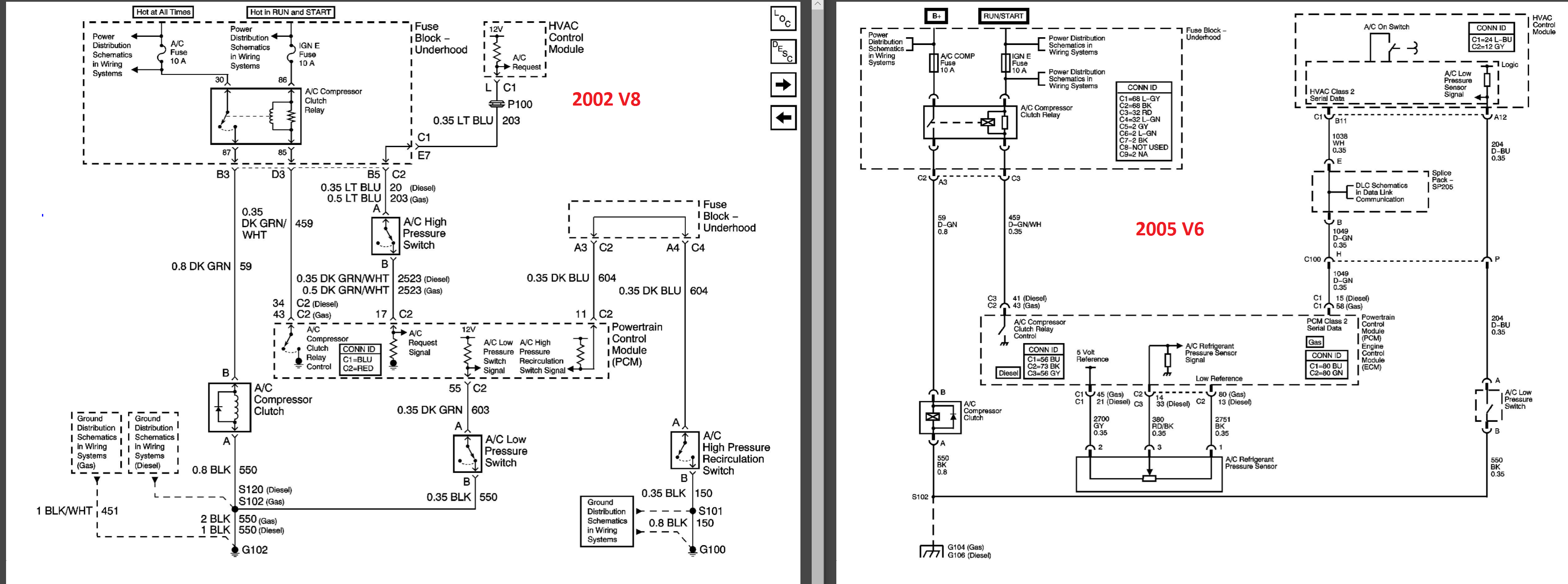

I'm trying to get this ac stuff settled out. The 99-02 V8 harness i'm using has an ac signal request wire on connector c2 pin 17. But the v6 body harness on the truck does not take a ac signal request wire. So I'm kinda stuck on this and what to do next! Also the 99-02 has a high pressure switch and the v6 did not have one.
Any help on where or what to do with the signal request wire?

Shoot me your VIN for the v6 truck so I can pull up those diagrams.

Heres your problem

So i can change the output of the ac request wire on the 2002 pcm to serial data in hptuners and connect it to b11 on the c1 hvac connector and that will trigger the compressor. Am i looking at that right?

I think so. The C1-B11 wire at the AC module needs to connect to C2-17 wire on the V8 PCM. Right now it is connected to the C1-58 connector.
Im not sure where that splice pack is in the truck, so if its before the harness the wire is actually dark green, but if it is gone with the harness the wire is white.
