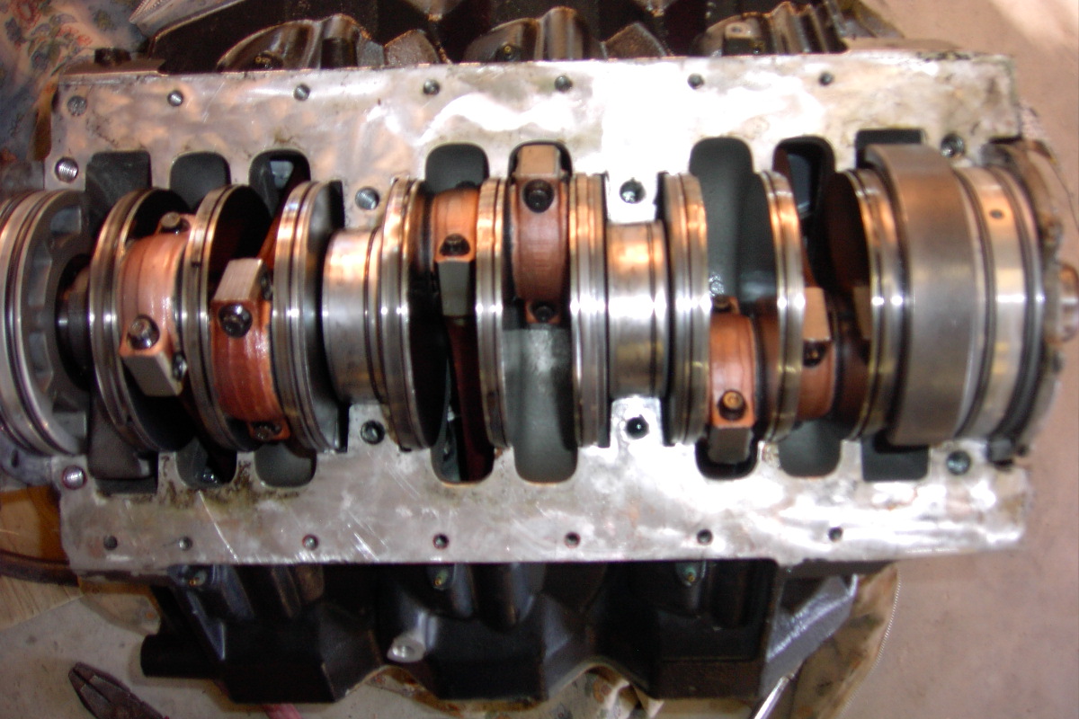

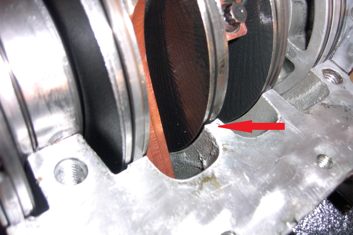

Seems to be a less critical location if the right epoxy is used. Had a 2 stroke boat motor rebuilt and they told me the machine shop used epoxy to repair one of the crank sealing ring areas(see pic). Wasn't so thrilled about that, but I would think that there would be a suitable material for a non-moving part like an intake manifold.
I think the gaskets are OK....now if only I could keep the intake bolts from loosening up!
