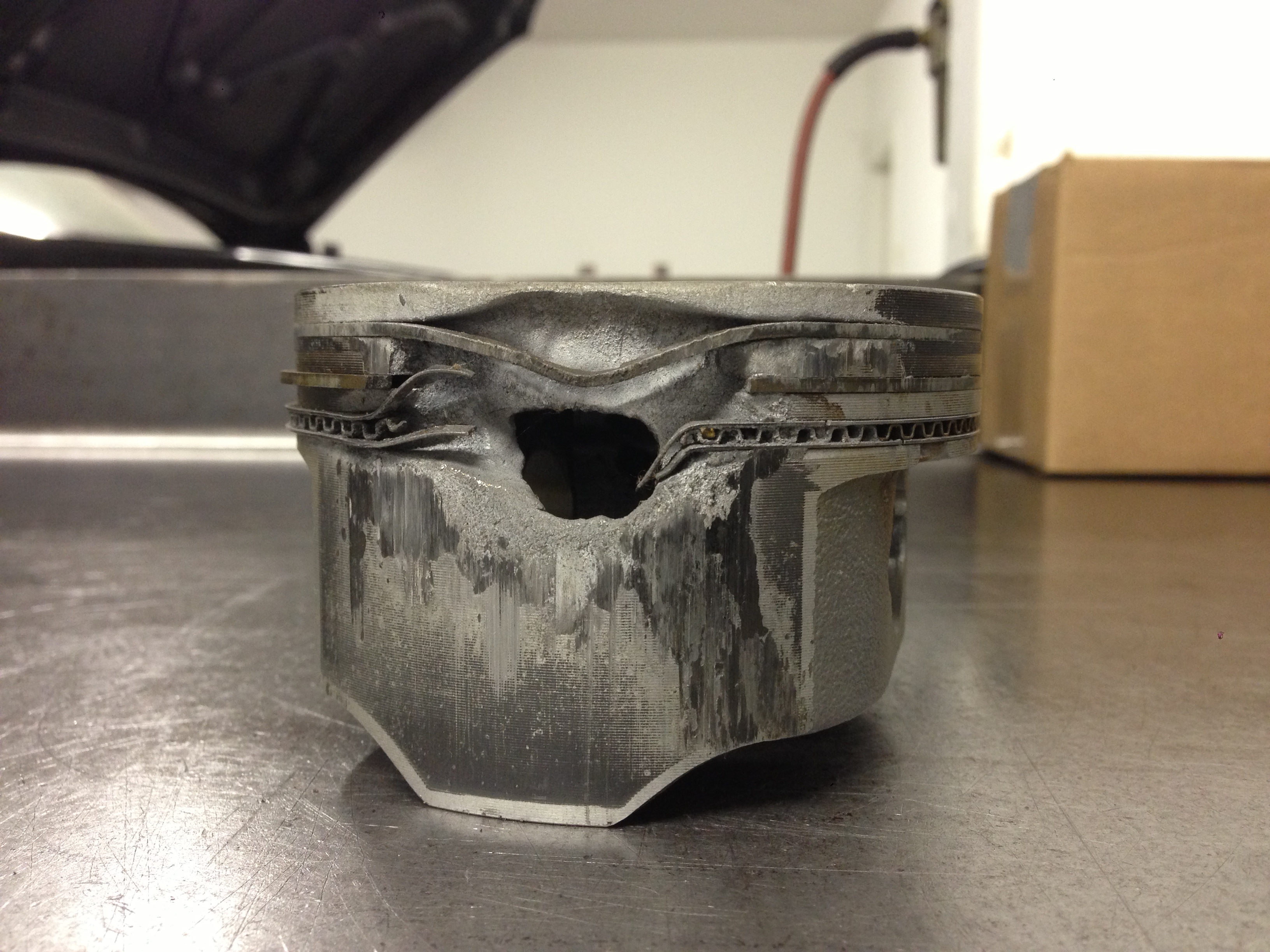

Wow, I just popped in for an update. And forgive me as I just glance through all the discussing, but I will add this.........
The piston above in question is "broke".
This piston is "burned"....
Old Jan 15, 2016 | 06:58 AM
  #153
blownescalade62's Avatar
Joined: Nov 2013
Posts: 299
Agreed this is another one.

I dont think it melted, I think lack of meth caused detonation/preignition. Rest is history.

This is the only case I can think of where a lack of meth is a bad thing.
