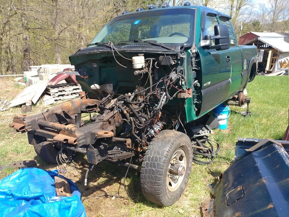

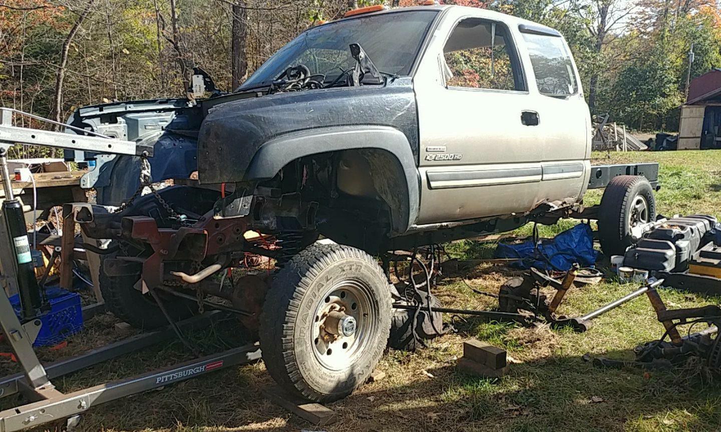

Fall 2017 - I picked up a 03 2500hd duramax long bed frame and cab for $150 on mothers day, my wife absolutely loved that road trip ! Cab was missing front end parts like fenders, bumper, hood, and interior. I then picked up a set of F350 axles off my dad, balljoint D60, and sterling rear. Threw them under the frame so it was rolling. I cut off all the brackets and stripped the Dana 60 down to the axle tube. Made up some coil spring buckets and 3 links, and welded them up. Got the truck rolling in a weekend.

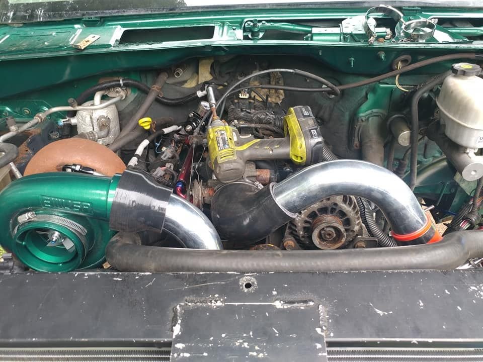

Winter 2017 - I had pulled the LQ4 out in fall and brought it into my basement to freshen up. New pistons, rings, bearings, ARP rod bolts and head studs, LS9 head gaskets, 706 heads with LQ4 valves, hardened push rods, HVHP oil pump, ebay GT45 turbo, front mount intercooler, new cooler for transmission.

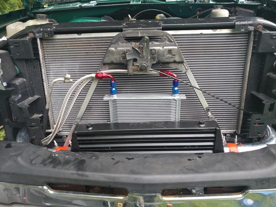

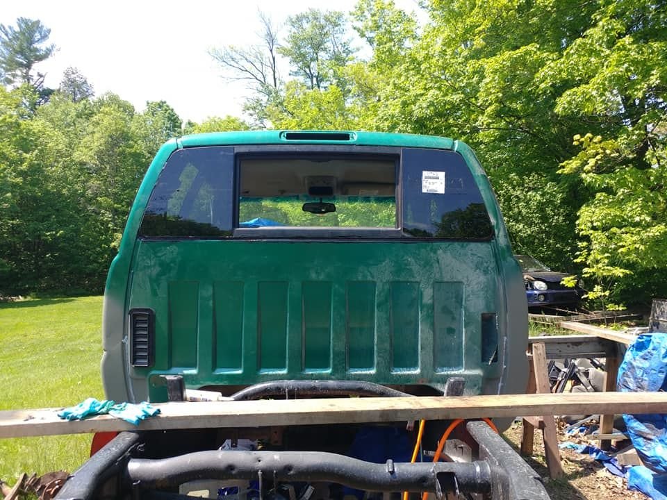

Spring of 2018 - I had a buddy parting out a 02 2500hd, so I bought that rear axle and replaced the sterling. I also took the engine frame mount brackets since I learned the Dmax and my 1500 were completely different. Nicer weather so I started on body again. Got front fenders, hood, and bumper for $250 from local junkyard. They threw in a brush guard too, which I gave to my brother in law for his 1500. I ended up emptying the 36 gallon diesel tank and using that instead of the 24gal tank off my 1500. Got most of the diesel out, maybe a gallon or 2 left in it. I filled it with 93. At this time I also threw in my titan rear window I had. Ran all new stainless lines for transmission and fuel.

That leads to today. Been slowly working out the bugs and been on a few test drives while I dial in the tune. Runs nice and strong, hits boost quick. I learned I had the PCV hoses routed wrong and had too much positive pressure in crank case, caused me to blow the rear main out, so that is now leaking. I had a few exhaust leaks on the hot side, easy to fix. I was using vband clamps after the turbo, but got rid of them and just went to band style clamps. Way easier for removing and reinstalling exhaust. It also smokes a little but I feel like that is just the rings sealing, I haven't really put many miles on it, and it took awhile to get the idle tuning correct with the 80lb injectors, so its idled more then driving (which I know is bad for it).
03 cab and frame with D60 axle

WRX and 2500HD first drive
Small FMIC, and trans cooler
mocking up intake piping

Titan rear window
