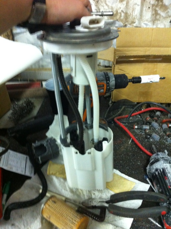

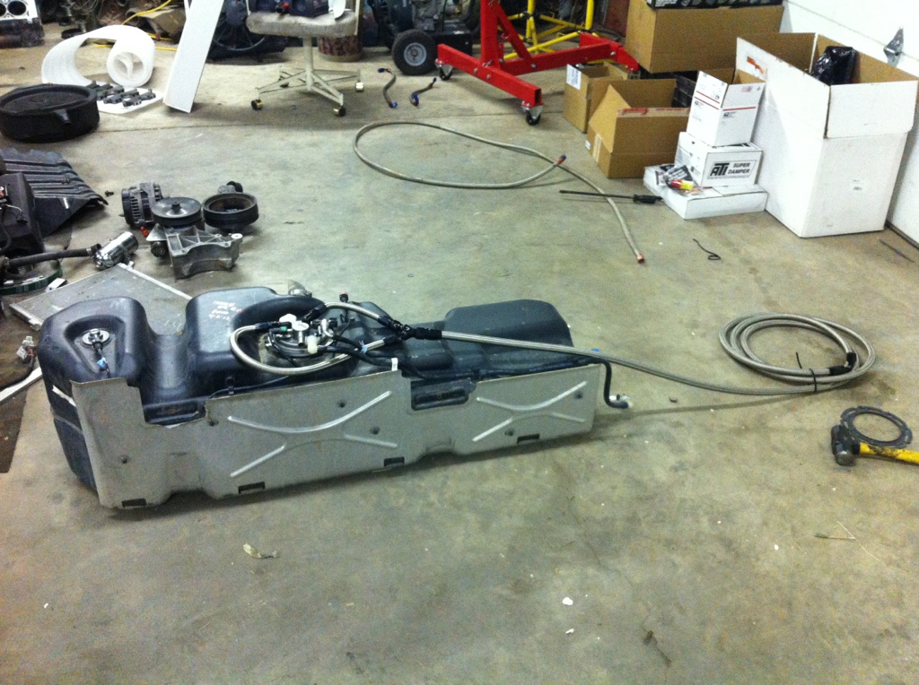

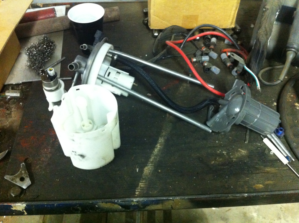

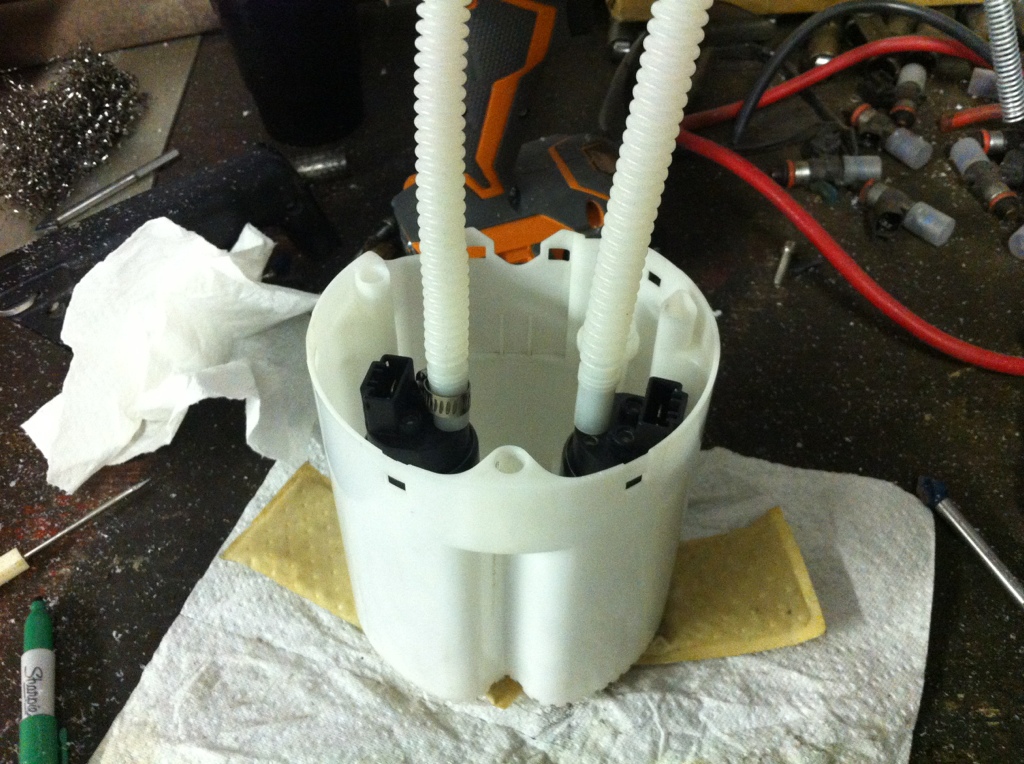

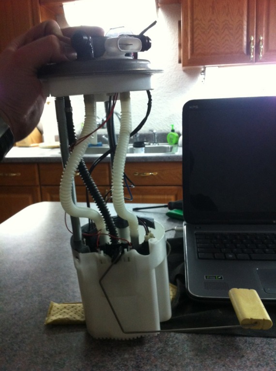

You think you coulda done this Richard?
Twin -8 feeds Y'ed out of the tank to a -10

Thats sick man. What psi will you have the second pump come on?
Old Apr 3, 2013 | 10:30 PM
  #76
Gray Ghost Silverado's Avatar
Joined: Oct 2011
Posts: 389
Thank you sir, the other will come on at 4 psi.
I'm eagerly anticipating trying this out. Still waiting on my clamps for the corrugated hoses to come in, gotta get some zip ties to hold the pumps from turning in their mounts and I still have yet to clean out this used/new tank. Then I can stuff it all in the truck.

Originally Posted by Atomic
Probably couldve done it better
Shouldve upgraded the wiring while you were in there.
Upgraded what wiring though? It's all brand new lol.
Old Apr 3, 2013 | 10:53 PM
  #79
Atomic's Avatar
I have a gauge for that
Posts: 16,282
Likes: 438
The wiring to the pumps. Are those 450s? If so, they are going to draw a lot of current, and at the least you run the risk of a significant voltage drop to the pump, and worst case it melts the wires through. I would run at least 12ga to them. I did mine with dual 10ga.
Old Apr 3, 2013 | 11:01 PM
  #80
smokeshow's Avatar
Mod with training wheels
Joined: Feb 2009
Posts: 7,741
Likes: 207
From: Detroit
The pigtail and pump wiring itself is only like 14 gauge.
