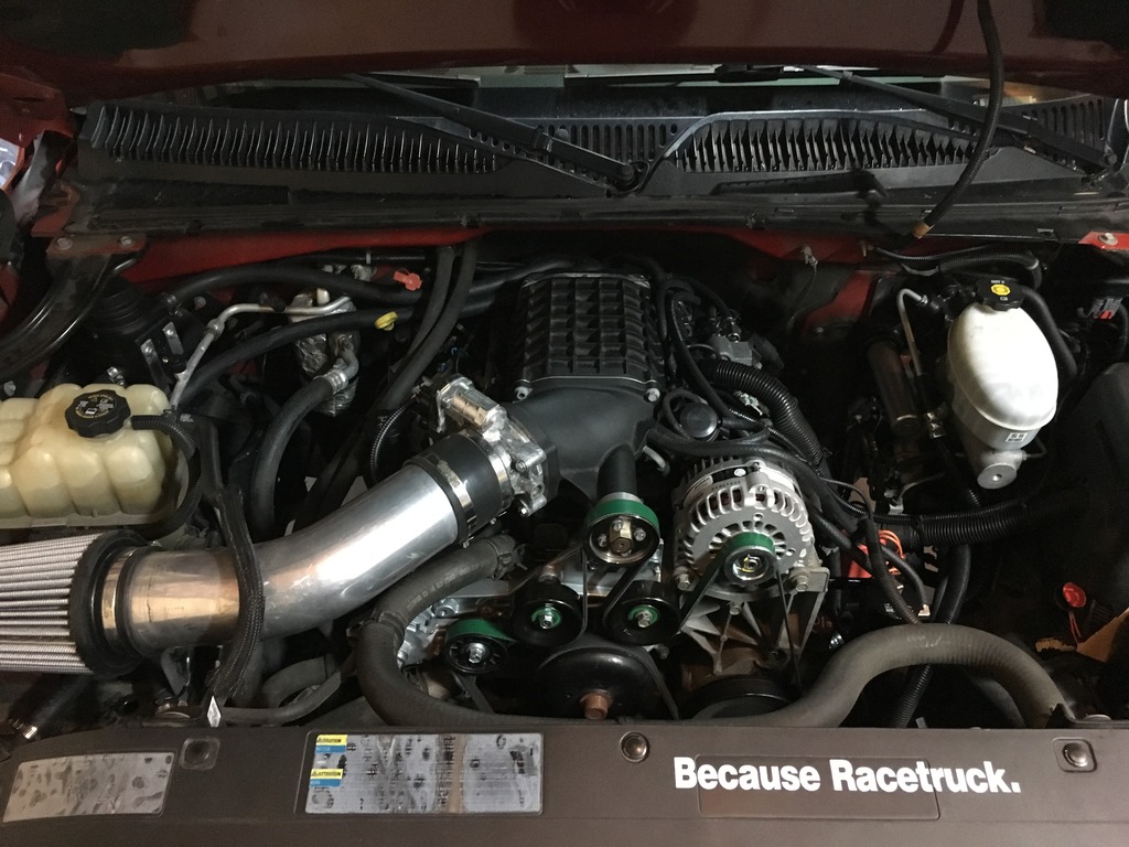

Added a 145amp alt today.

SC looks good.

Likes: 791
Looks really good!
Is that alternator a direct swap?

From: in MA or SC
Thanks guys.
And yeah the alternator is a direct swap, it came in the 04+ trucks.
Some say you need a longer belt, but because I have the adjustable idler it didn't make a difference.

Originally Posted by GM1697
Thanks guys.
I did this mod before my supercharger, with the stock setup and belt you can get away without a new belt but its a fight to get the belt on. Are they 90mm idlers..?

Yup 90mm idlers.
