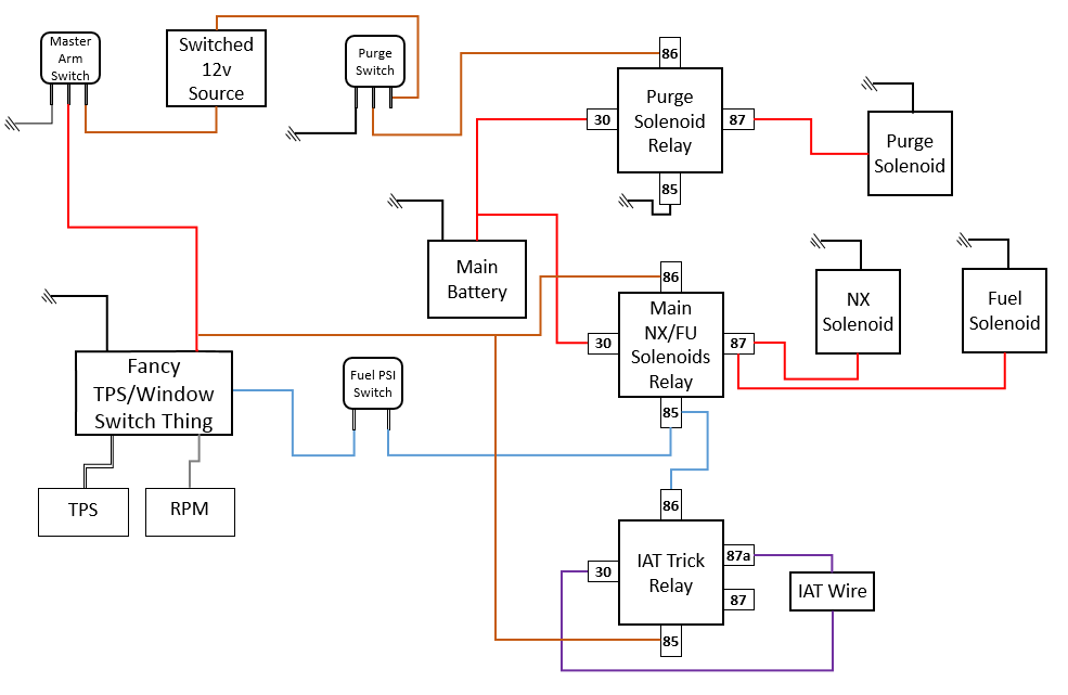

Yeah I'm the same with work. Did you use the relay that came with your proton kit to run your window switch to or did you use the new relay they sent with the window switch? Cause I'm just using one relay for the whole system.
I went with pacesetters when I was lookin for headers and they've held up pretty good.
I'll be running 3 relays. But you can do it with one. The other 2 are for my IAT trick and the purge system.
Here's a diagram Atomic did for my wiring.
Attachment 76692
Relay for your purge? Mine don't require one.
I think use get the lnc-2000 to pull my timing.

Anything that requires more than a couple amps is good practice to use a relay.

yeah the purge kit doesn't come with one. I just added it in.

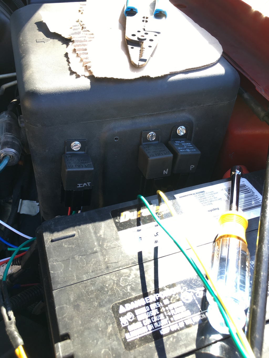

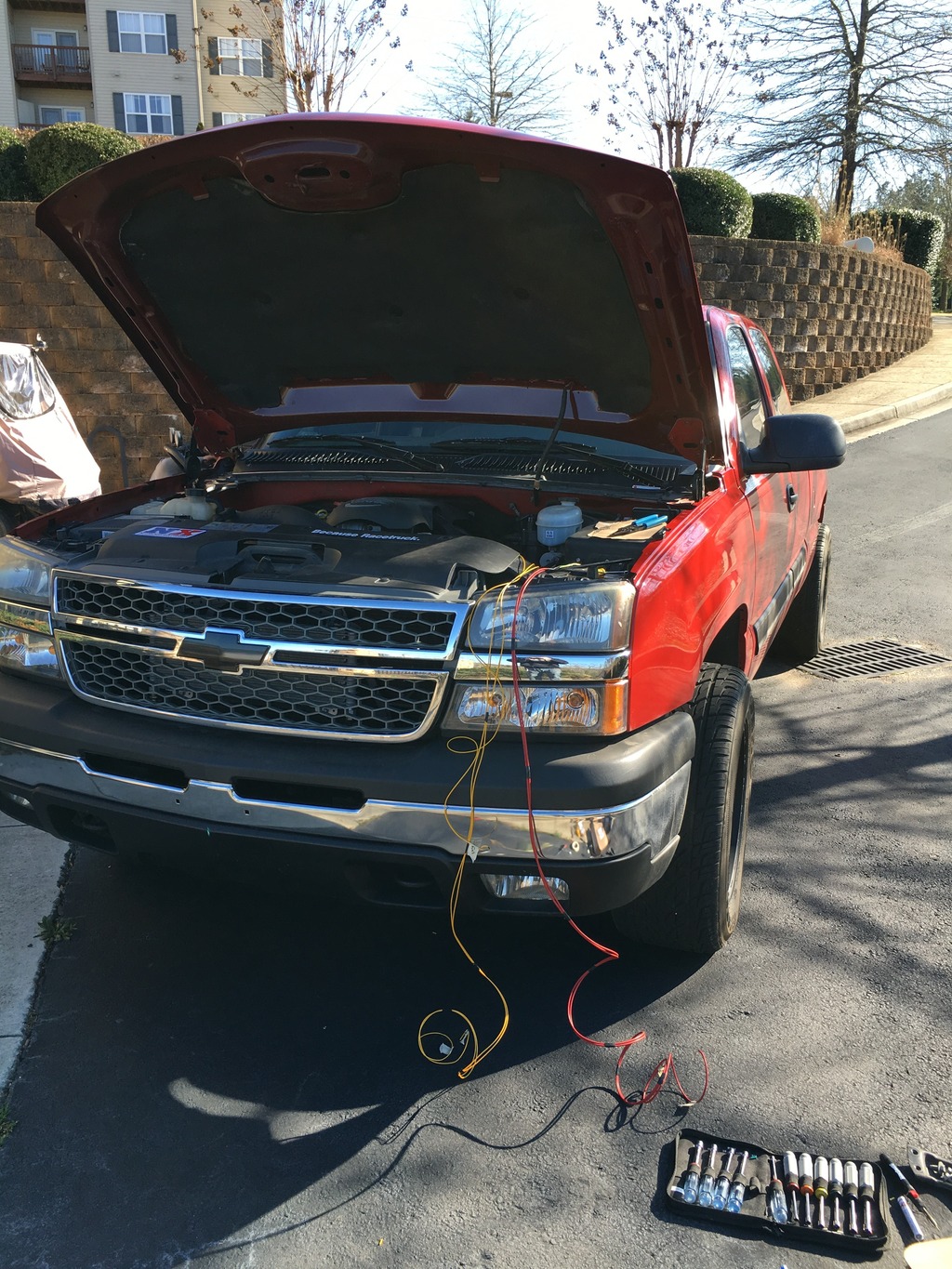

Just doing nitrous things

Did my diagram actually work?
Baha sounds like you'd be surprised if it did...
I dunno, I stopped for the day. The clemson sport car clubs rx7 needed work done on it, so I spent the rest of the night working on that bad boy
Tomorrow wiring be finished, just needs some switches and a few grounds.
Then it's onto the nitrous lines and noids and whatnot.
