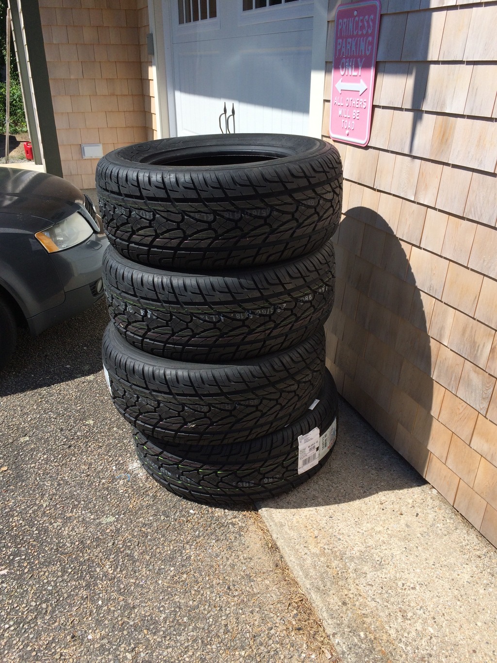

Yeah so I lost my wheels...

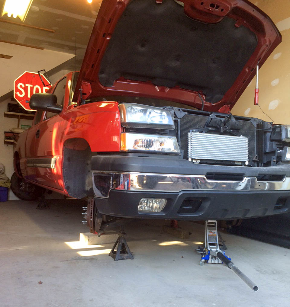

new shoes. waiting on my new wheels
