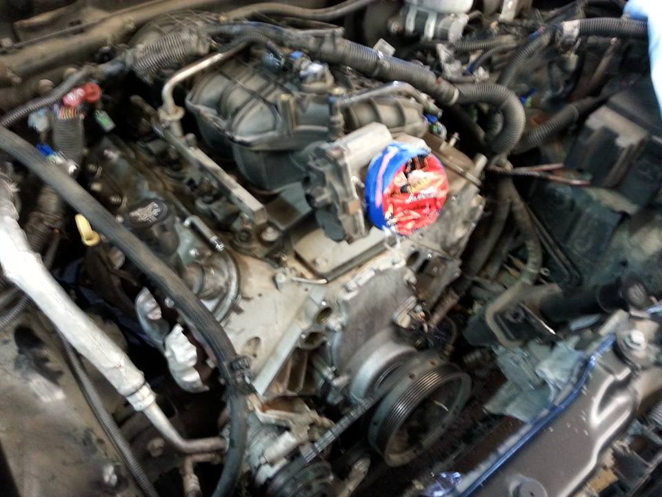

Tuckin15s's Avatar
Joined: Dec 2011
Posts: 333
From: Spring Lake, MI
My sweet custom lifter bars
