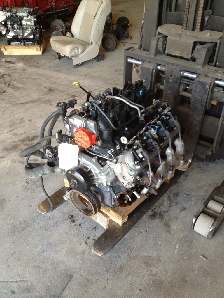

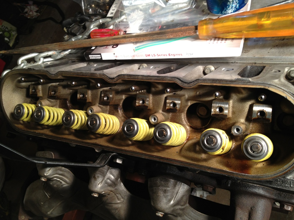

Been reading through the forums for a while now, finally in the last few months I got the itch. Started with a stock 2004 5.3 Z71 with about 70k on the clock. Went big with a good deal on a low mileage LQ9 from the salvage yard in Holland.
Swapped in yellow springs and LS6 cam.

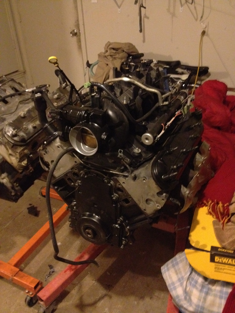

All buttoned up

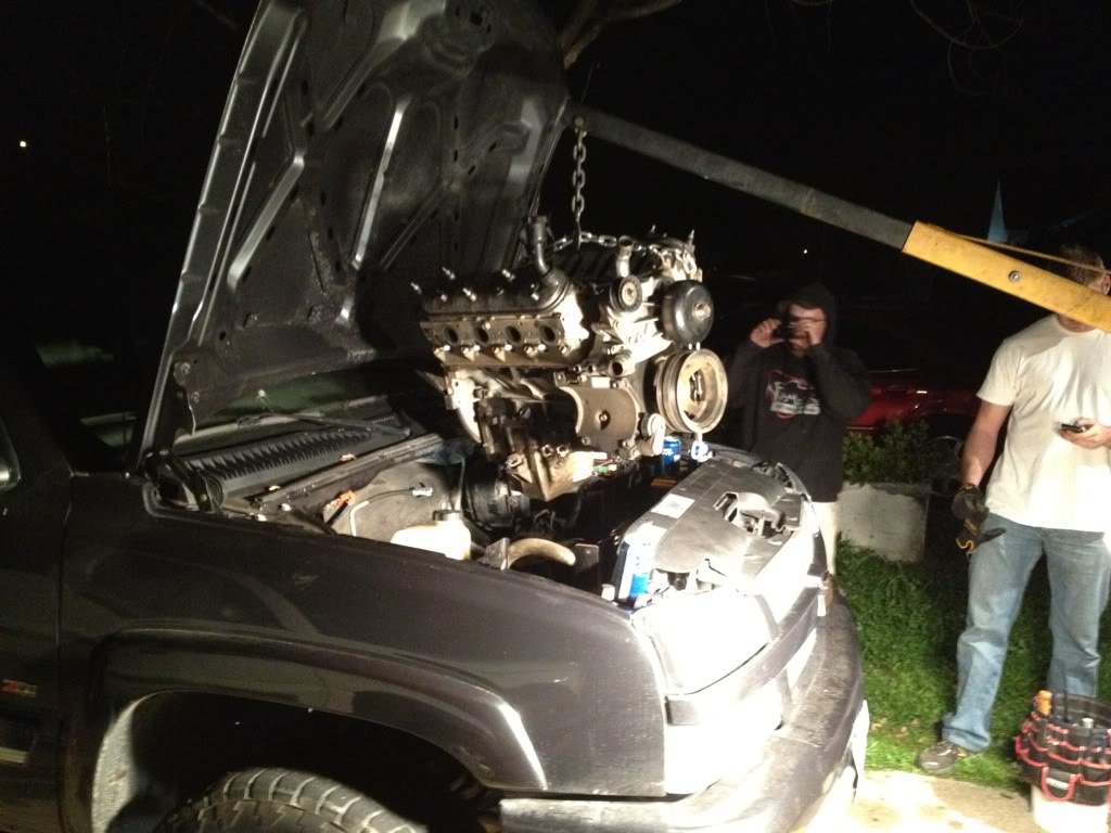

Out with the old. Didn't really get many pictures of it going in because I ended up doing it alone. Went pretty quickly regardless. I threw in a 34" radiator and efans at this point too, I think I went with the Nelson harness. Also went with the 145 amp and underdrive pulley.

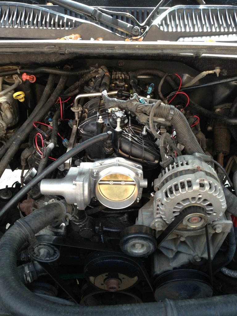

Shortly thereafter swapped on the TBSS intake with LS6 throttle body, plus the x-harness. Still trying to figure out where I want to permanently put that.

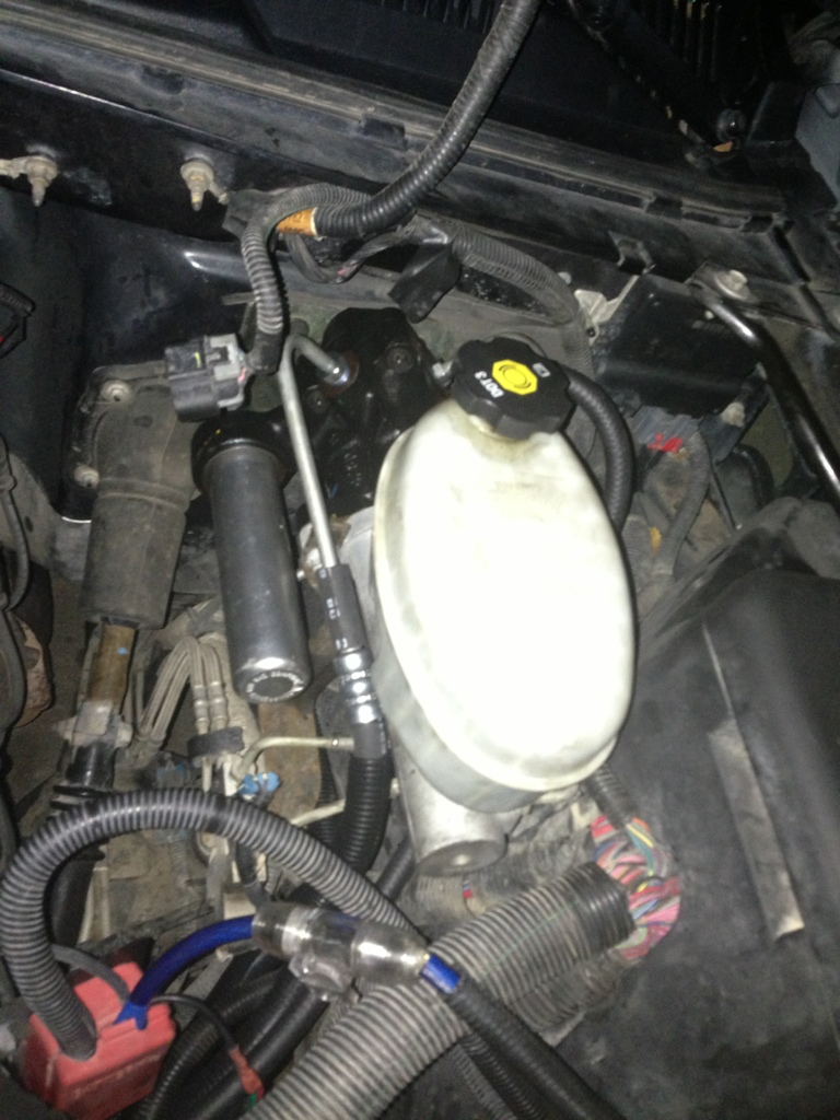

Then the hydroboost system with hydroboost ps pump.

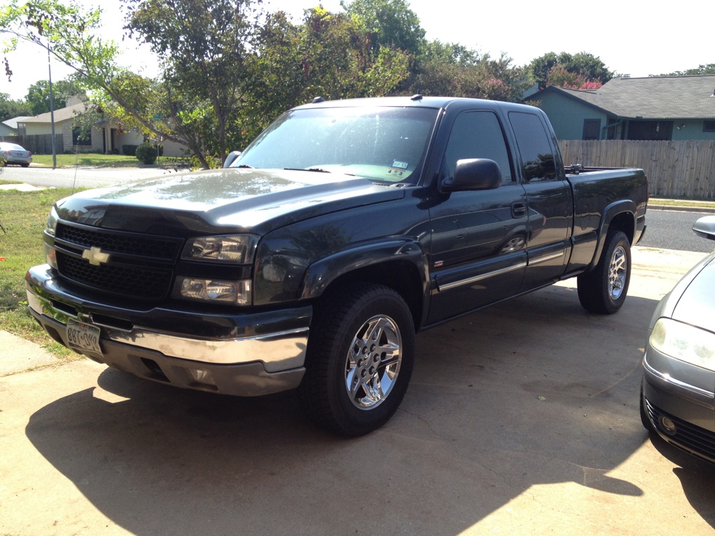

As she sits today, just tonight I sprayed the front valence flat black. Have yet to take a picture though. I have a set of LPP headers in the mail somewhere, I'll be getting them installed next. From here, I'll be doing more research on either FI or NO2, and will be looking for a cheap 4l80e, and a better locker. I've installed a servo and raised the line pressure and shift points with my tune, my 60 has been doing me well, but its only a matter of time. I almost locked down a sweet trade for a P1SC1 kit but it fell through. Let me know what you think.

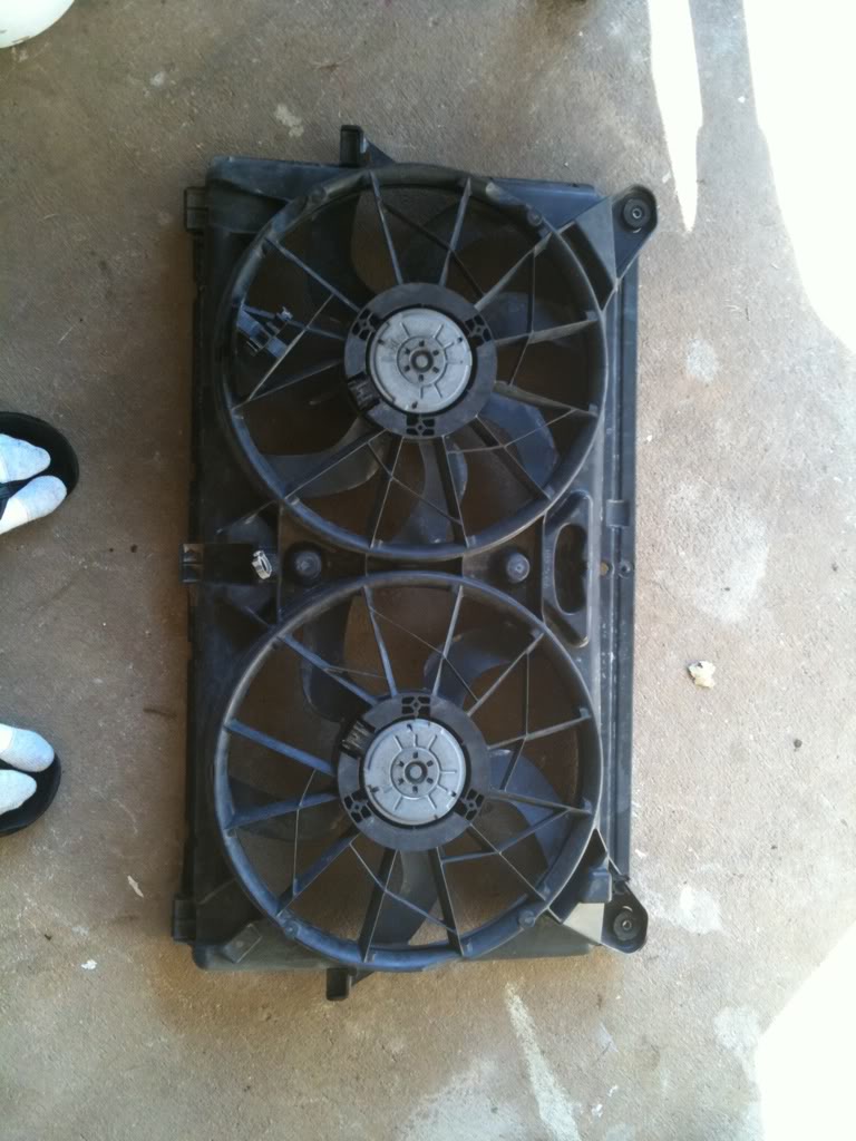

Thanks, just the standard 05+ truck efans, I got them from LKQ recycled parts.

Nice. How do you like the hydroboost?

The hydroboost is incredible. I've driven vehicles with vacuum powered brakes all my life, this is a difference of night and day. I encourage anyone to do that swap.
