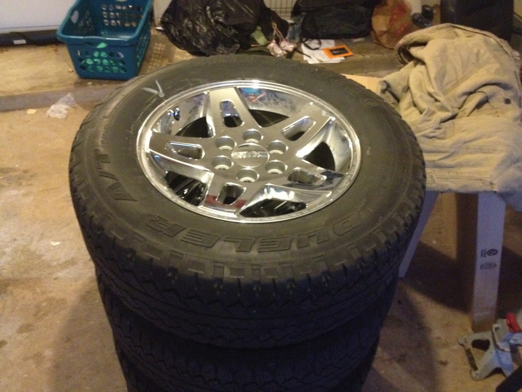

I really need an idea on new tires for my wheels, problem is, I don't see many people rolling them. I'm looking for an aggressive street tire, good grip at the same time has a long lifetime. Anyone have any ideas on a good tire combo? I'd love to see some pics if anyone has any.
