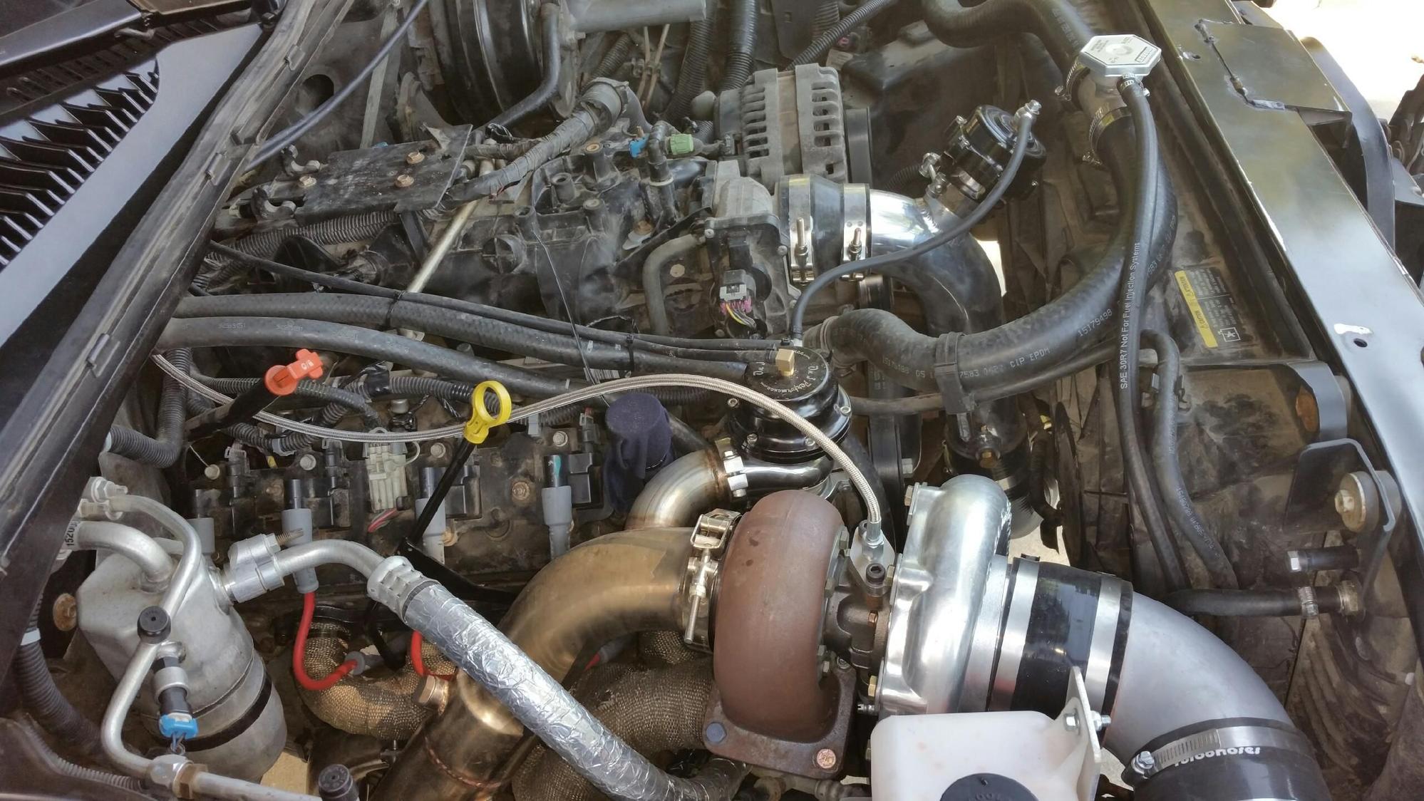

From: The Mitten
Heres a pic of the finished set up. Should have pulled this motor and gave it some lovin first...
