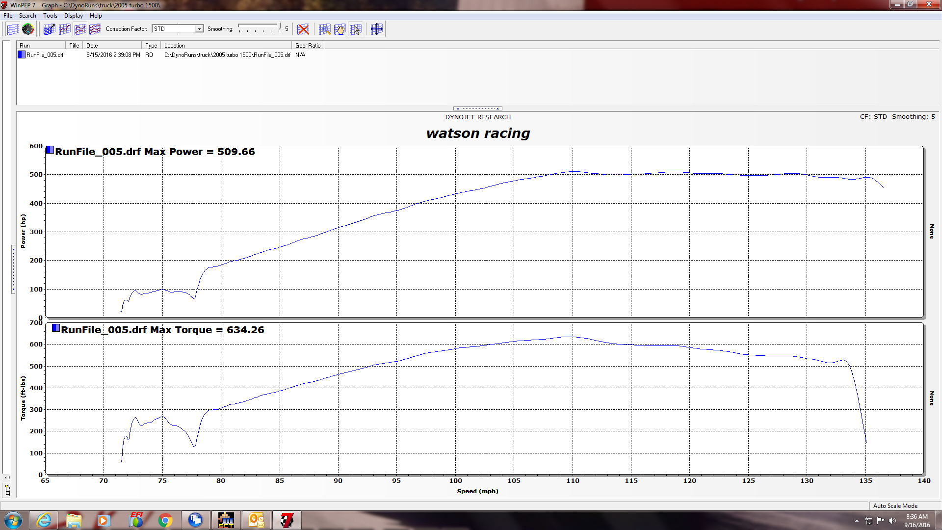

Ok sorry for such a delay in this build. I ended up getting a better job offer and moving etc in the past few months so i've been busy. The truck is finished and heres the results:

Now on to the real stuff. Pretty sure in the mist of all this one of my pistons didn't like the new turbo set up. So the motor has a knock to it. I will be laid off from my job within the next 2 months. I plan to pull the motor and do a rebuild. Thinking some forged pistons and rods with a head job would beef this thing up a little. Can anyone point me in the direction for a good set up?

Also my tuner said he had the truck up and over 540hp on the dyno but didnt include that print out.
