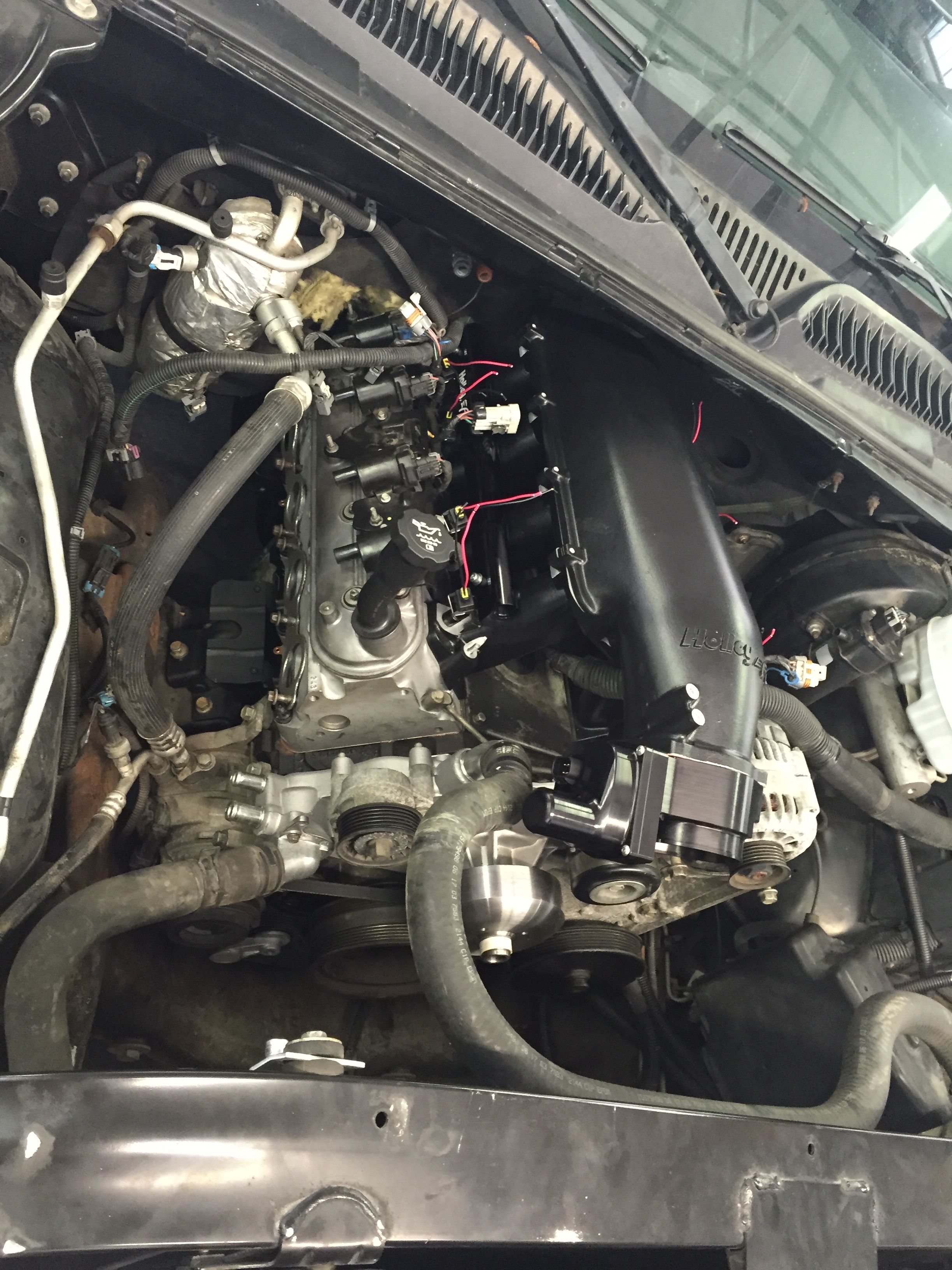

WILL HAVE PICS UP TONIGHT! Getting very close! Heads came out great from the machine shop. The Tick Performance package was great bang for buck. Brian Tooley head components and good cam. I will post the cam spec sheet also. So we kept the stock bottom end as planned. Motor is back together and looking great. Ending up tapping in a CTS-V map sensor. We are waiting on the conversion harness for the throttle body at the moment. I ended up getting the Dirty Dingo manifold and cross pipe. Its really great fitment and the short stubby design supports my big frame borg warner really well. Only modifications will be moving the 44mm wastegate back on the manifold a bit because the 4in down pipe will hit it. I went with 275/50r17 M&H tires for the back on my Truck Star wheels which look really good mounted up. At this point we just have to do the downpipe,dump tube, intercooler & set up the fuel system. We are shooting to be tuning next weekend. Going to start with a pump gas tune with the 7psi wastegate spring and see where we stand. After dialing in we really hope to see 600-700 on pump gas at between 7-10 psi. Pics will be up in a few hours

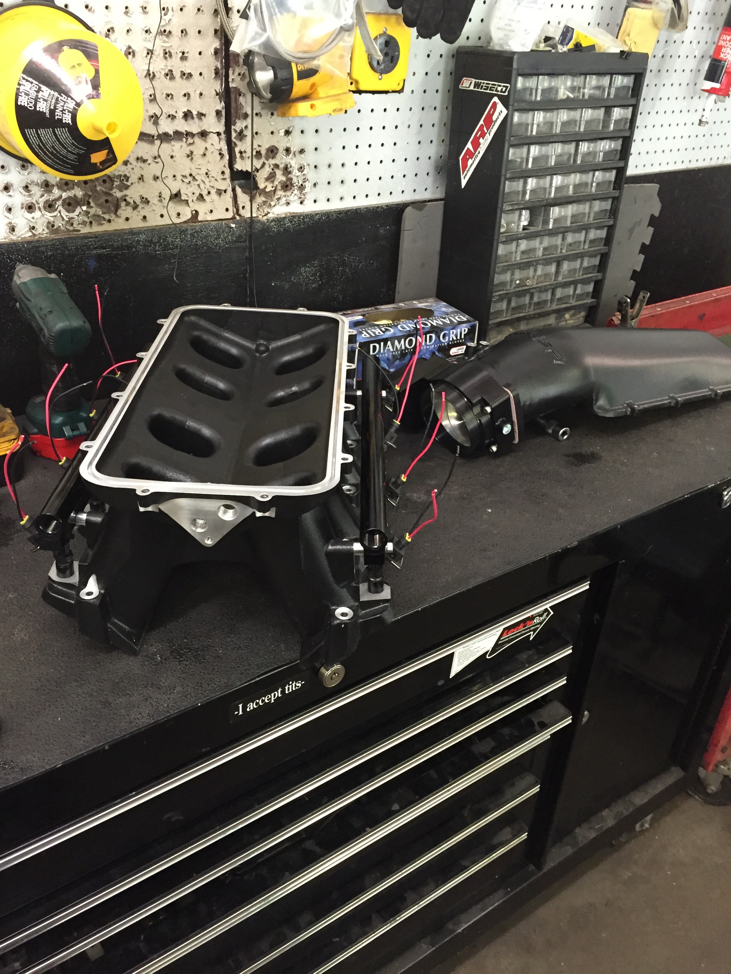

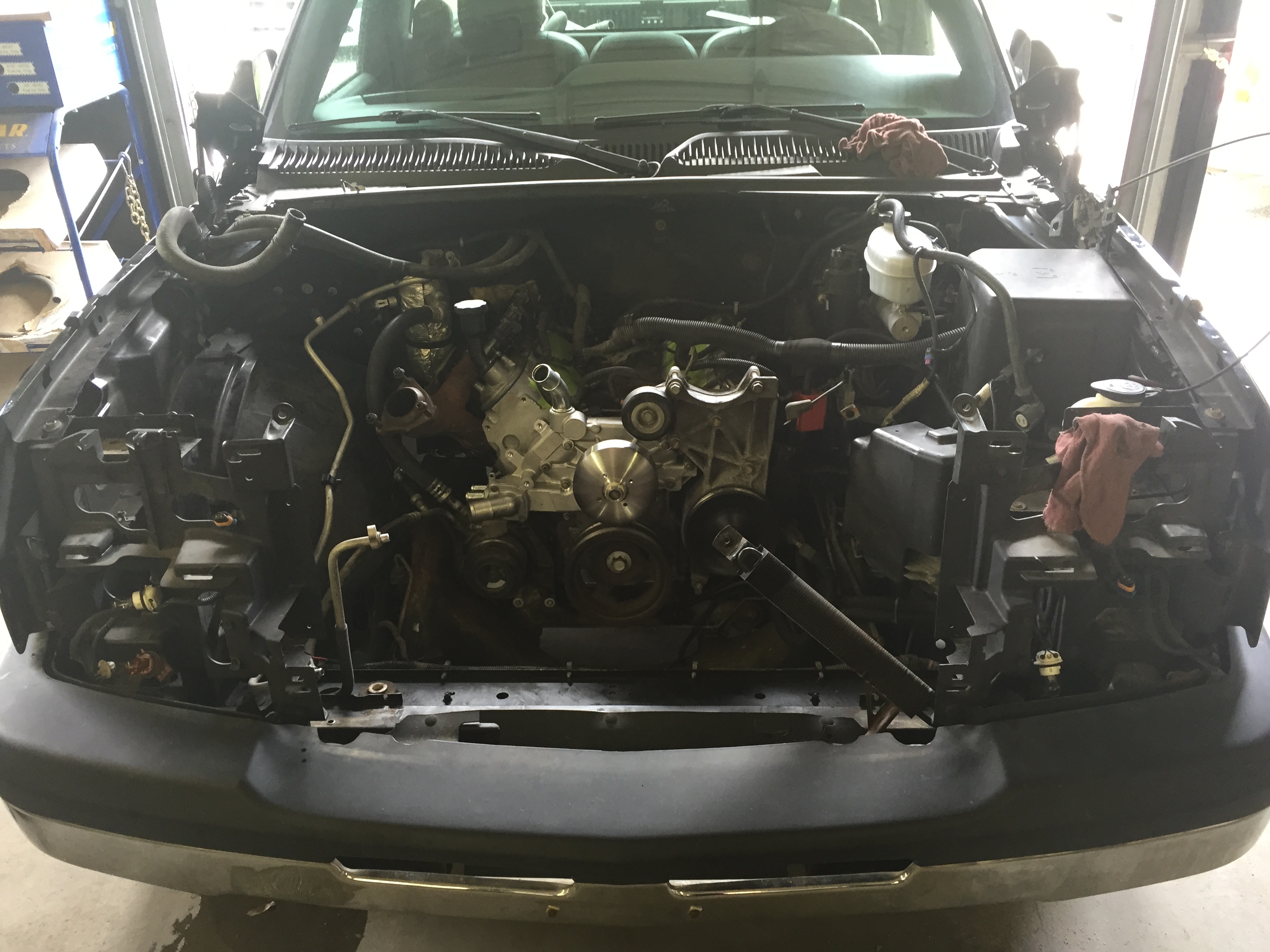

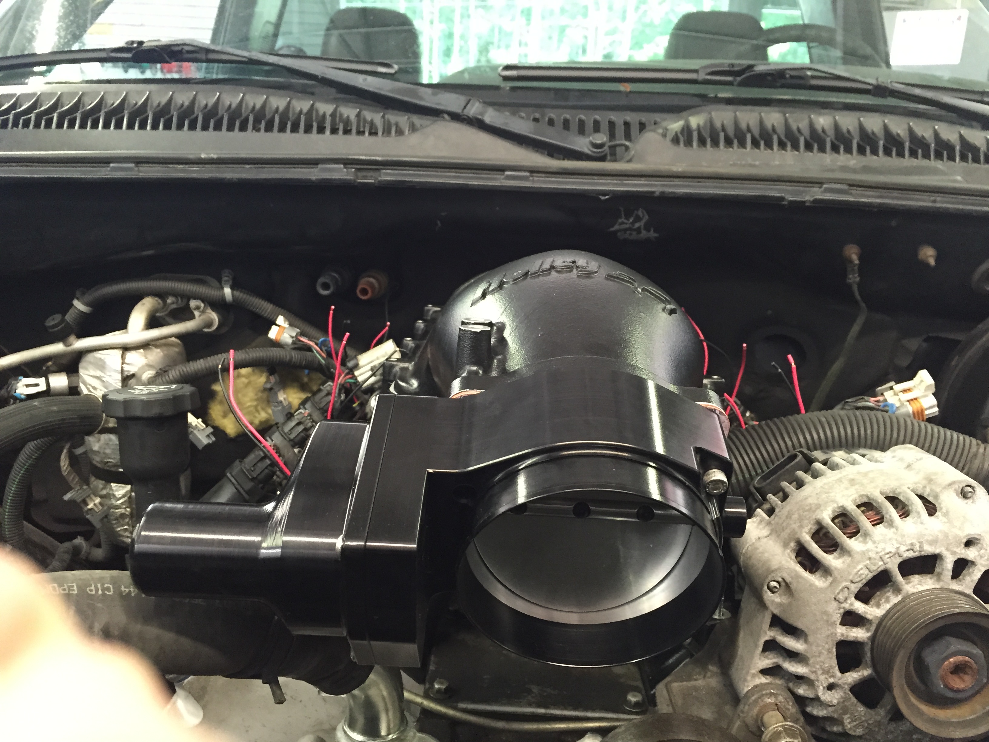

Progress pics

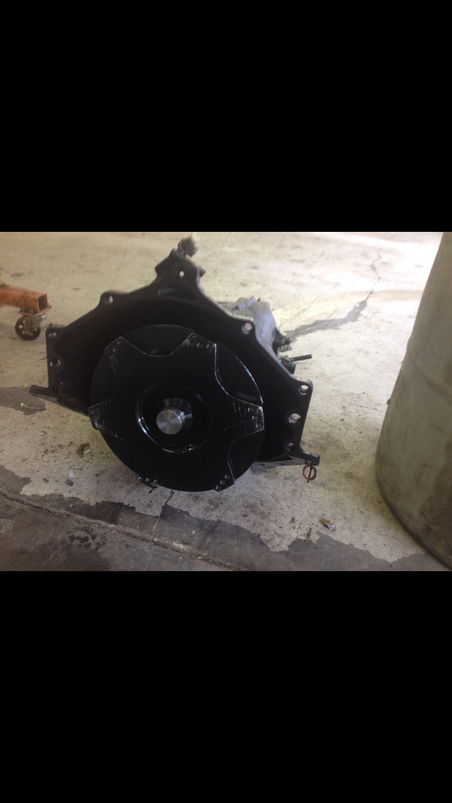

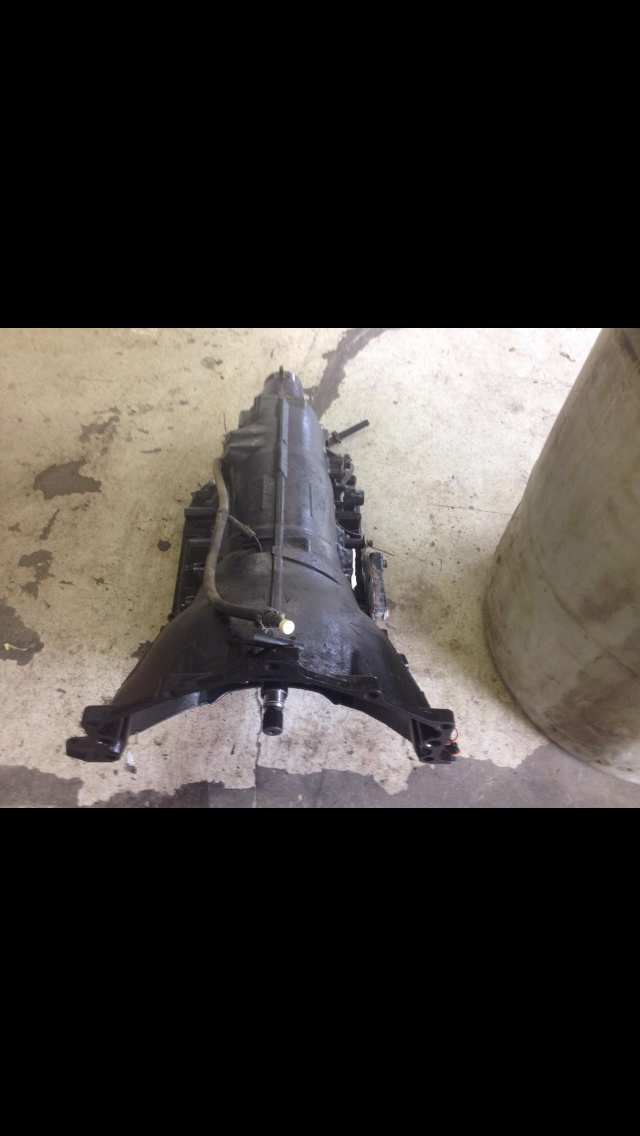

quick pics of the 4l80

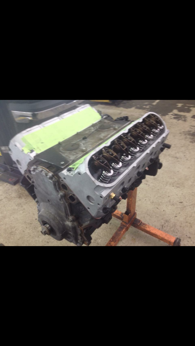

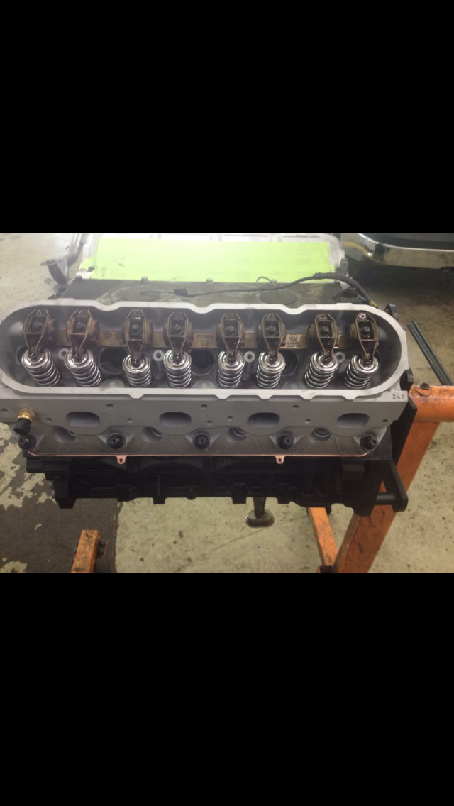

243 heads came out great!
Attached Thumbnails Fingers crossed 4.8 build-img_1196.png   Fingers crossed 4.8 build-img_1195.png   Fingers crossed 4.8 build-img_1194.png

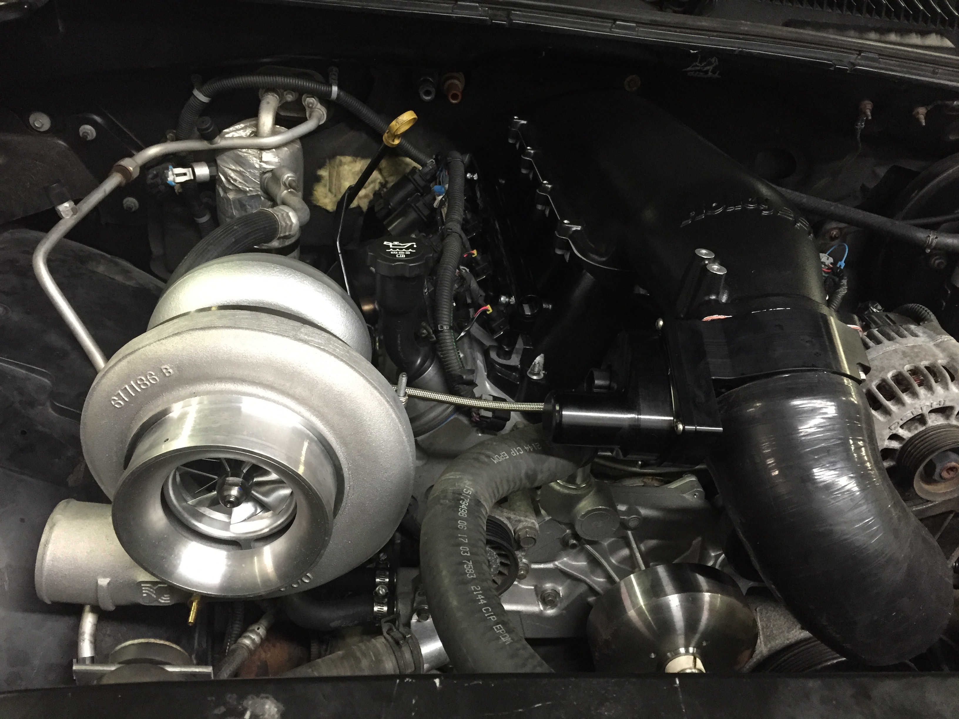

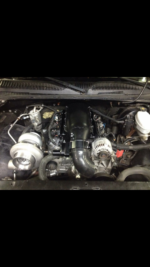

Turbo mounted up with the dirty dingo manifold and cross pipe

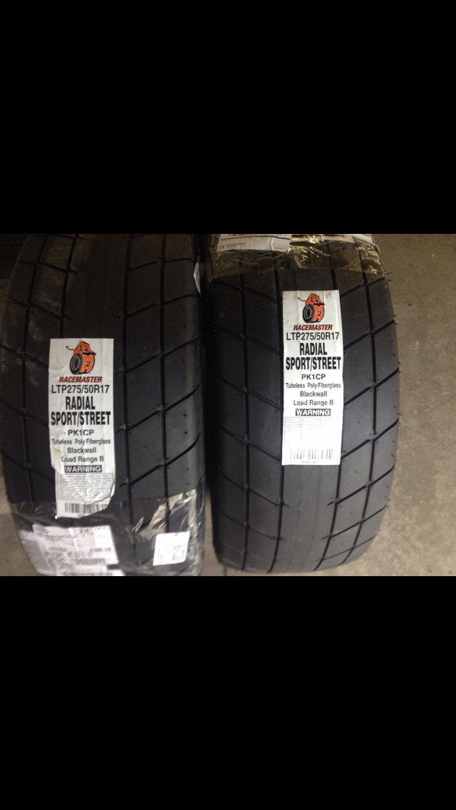

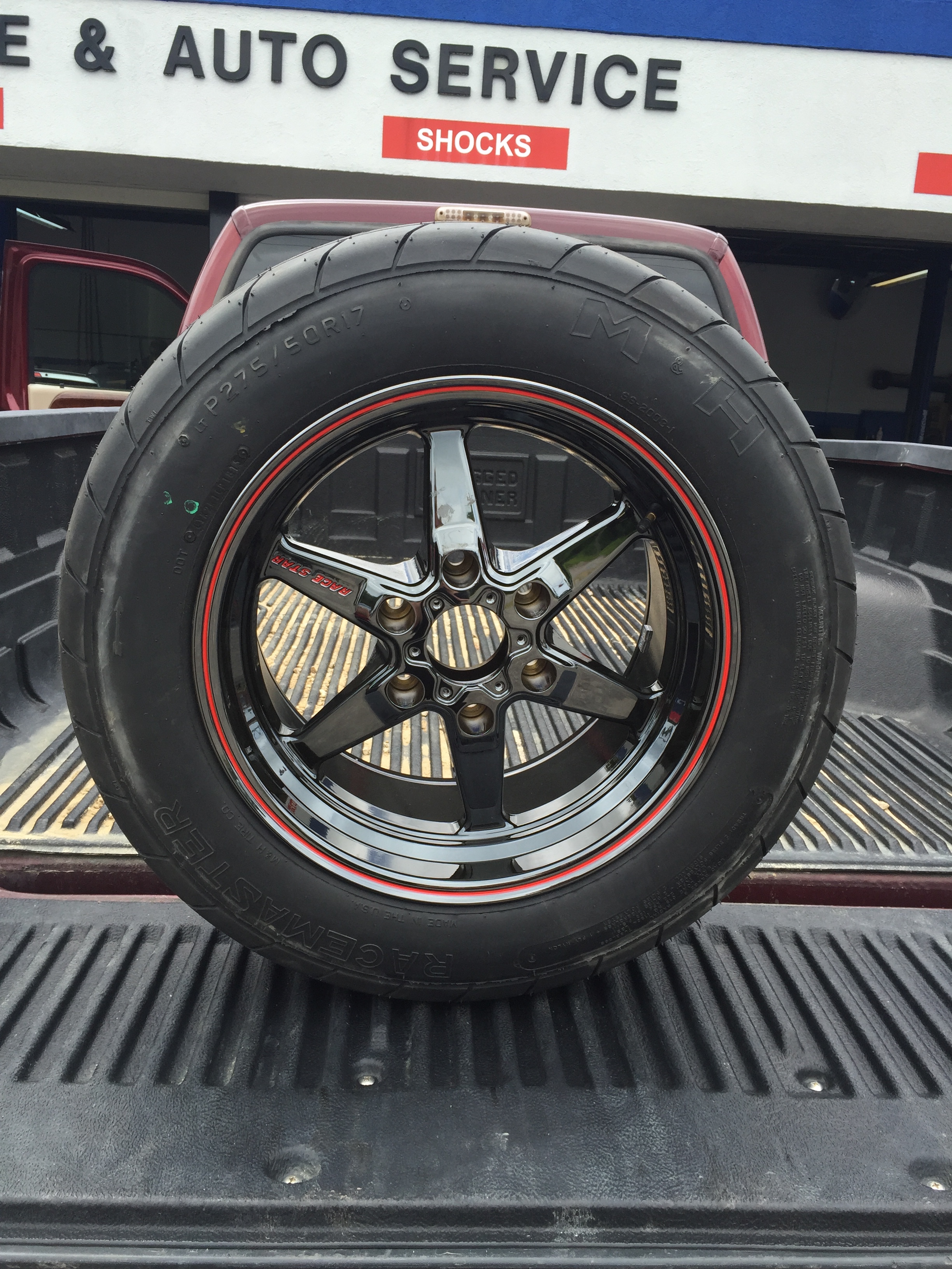

This setup doesnt look half bad. Really like the M&H tires.

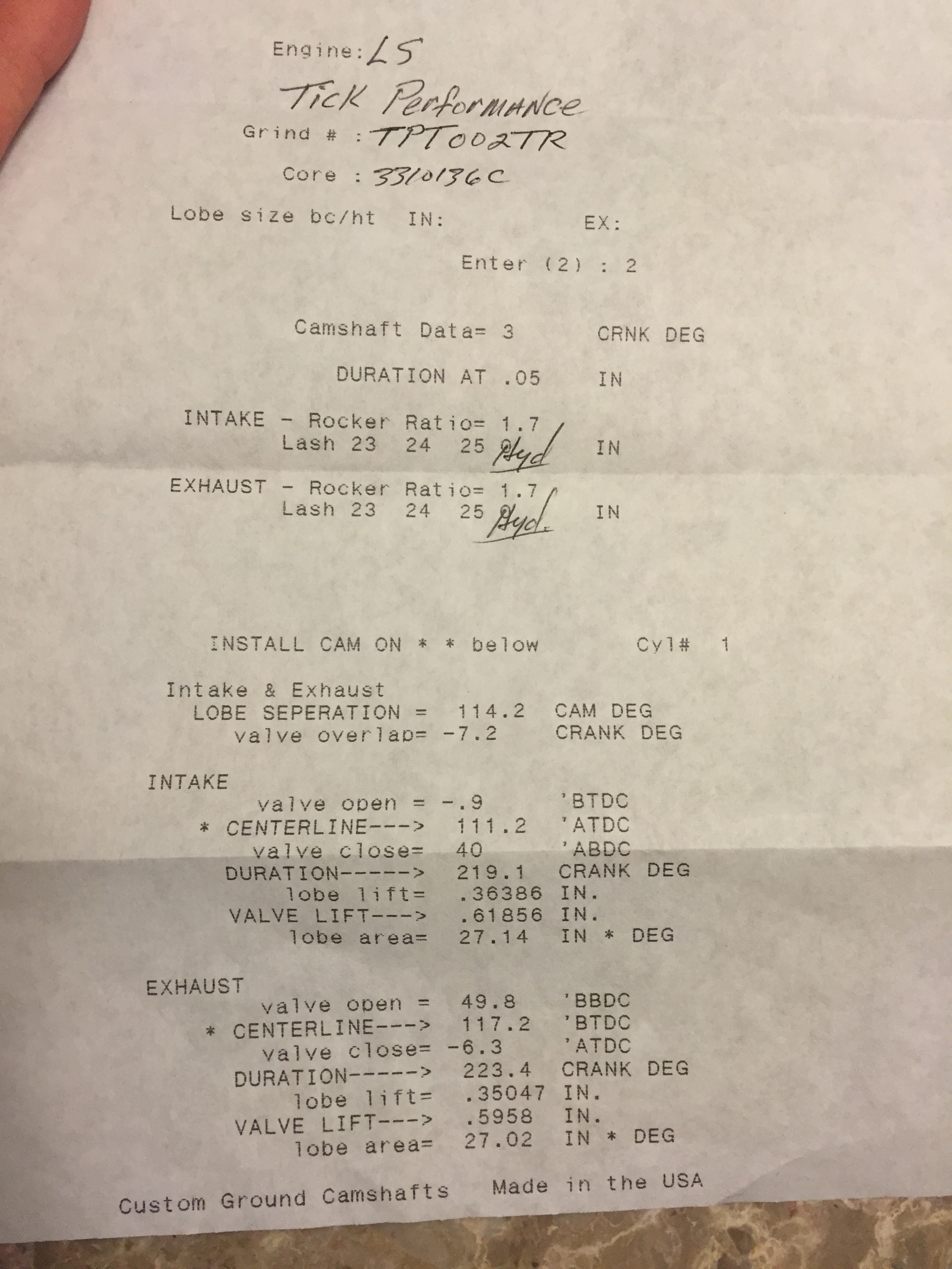

Spec sheet on my cam from Tick Performance
