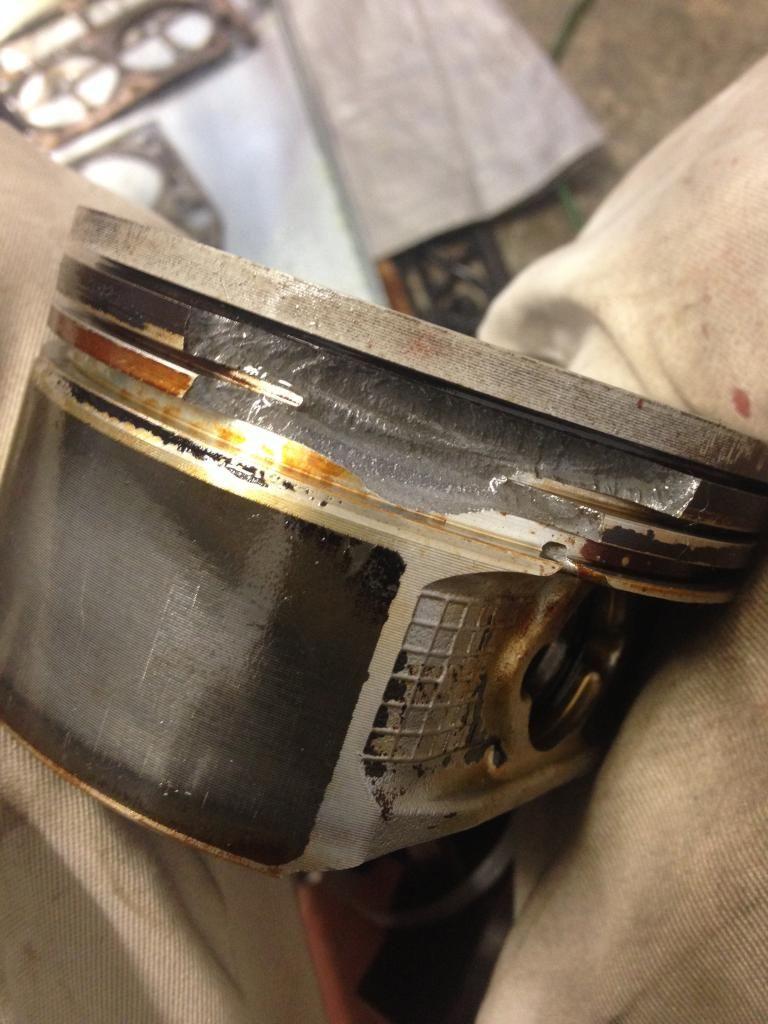

Well, finally got over my sadness and got motivated to pull the motor and pull it apart.
At first I didn't see anything...and then I took a closer look at #7 Cracked the ringlands, but didn't even break the ring
I guess the good news is that the cylinder walls are fine, and a new piston and I should be good to go!

Thatll do it!
I recommend replacing all the rings and doing a clean up hone before you install them

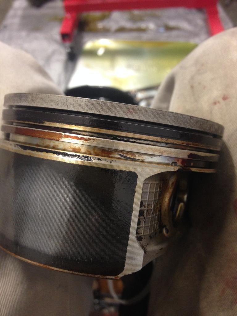

Turns out #7 didn't want to be alone and took #5 with him
