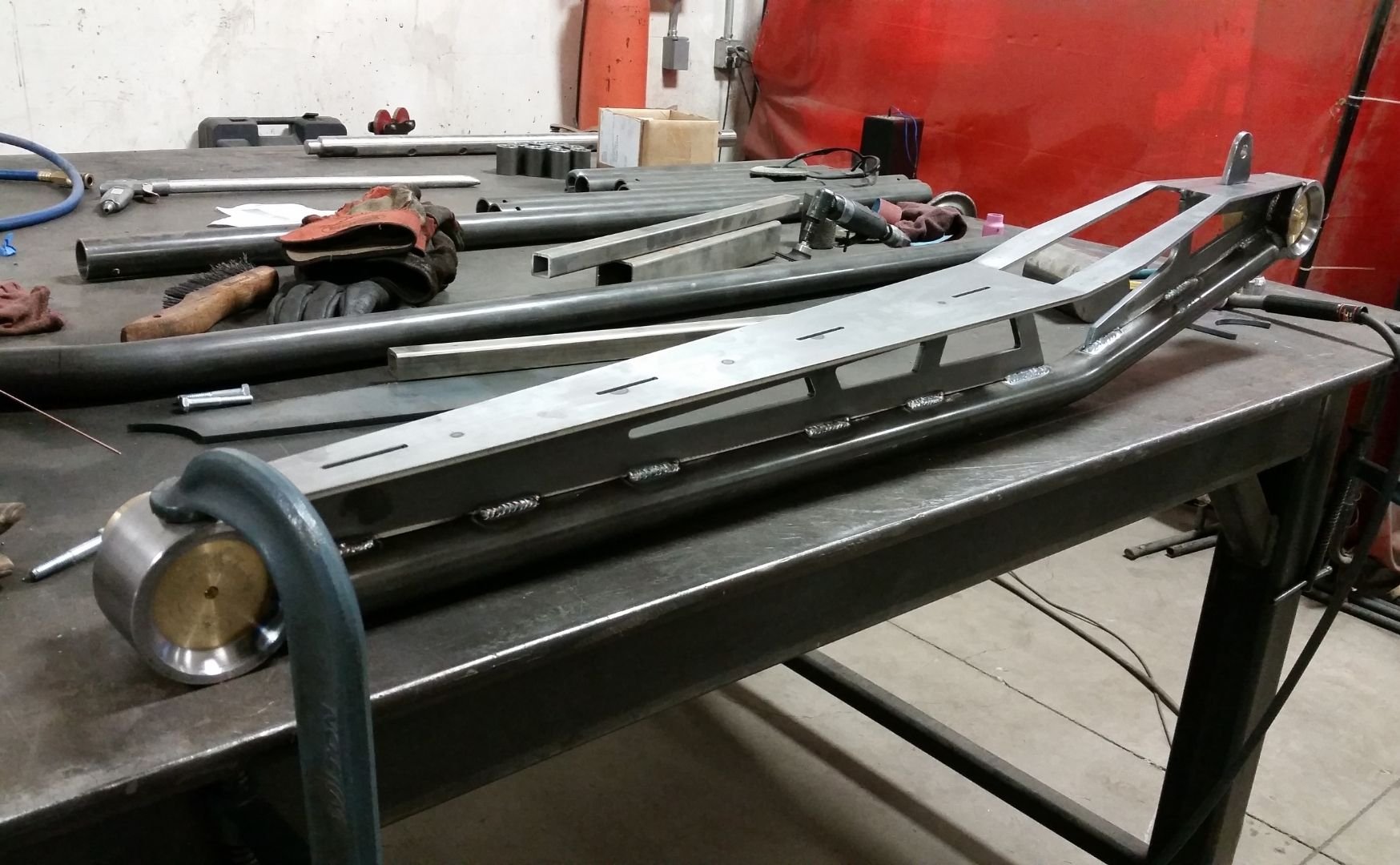

Needed the space at work so I took the truck home.
Started the front 4 link but knew the steering was going to be a pain in the ***.

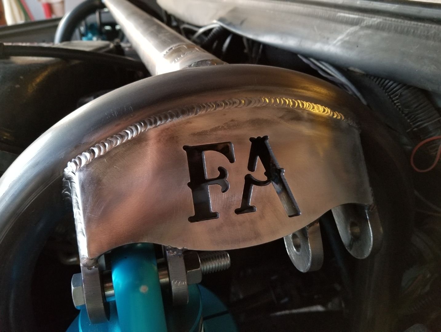

Front diff getting a brace and boxed
My coworker MIG welded it up. He's making me look like a bad ***!
We couldn't get the stock steering to work while keeping the lower stance and 14" of travel. So we switched to a full hydraulic from Howe. Those guys have some great customer service!
