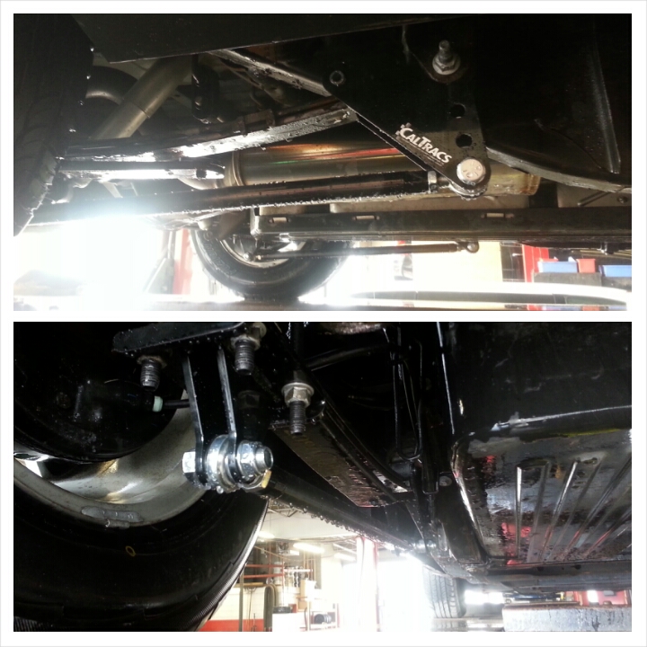

Got the Cal-Trac's installed, what an annoying job that was haha. Nothing really hard about it, just the ext cabs don't have as long of a filler neck as the quad cabs so you cant move the gas tank as far, but you can still do it. I also had a hell of a time with my leaf spring bushings, maybe cause they were still in such good condition?
haven't had a chance to really test them, but so far no problems!

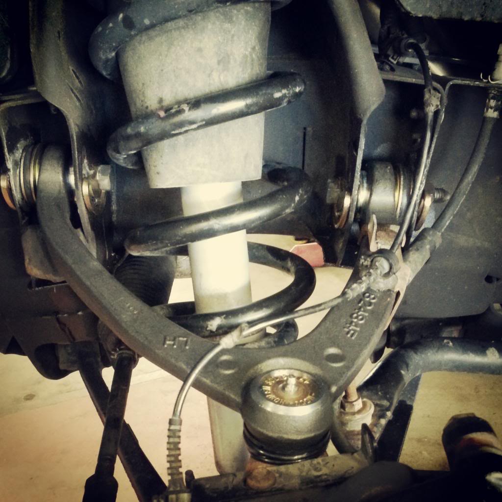

Installed some Belltech 1* bushings and Eccentrics, also replaced the upper arms with some Moog ones

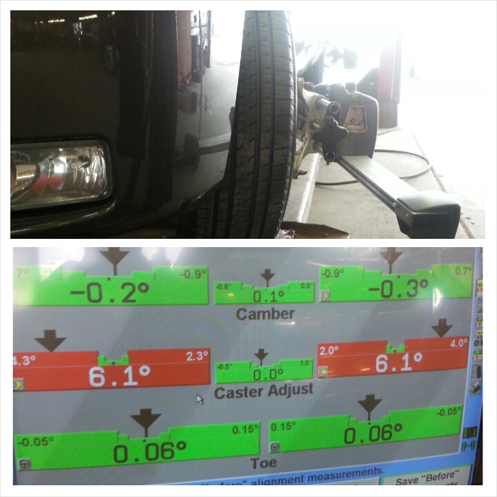

tossed on some new 245/70R17 Bridgestone Dueller H/L Alenza's and rechecked my alignment. the new bushings had settled a touch, so a quick camber, caster and toe adjust and done.
just for everyone who does they're own alignment. the "rule of thumb" for eccentrics...2:1 for caster:camber doesn't apply to these belltech 1* eccentrics. its more like 4:1 on these, kinda frustrating when I tweeked the camber 0.1 and suddenly my caster changed 0.4!

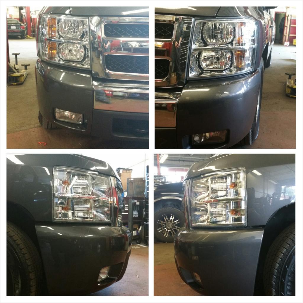

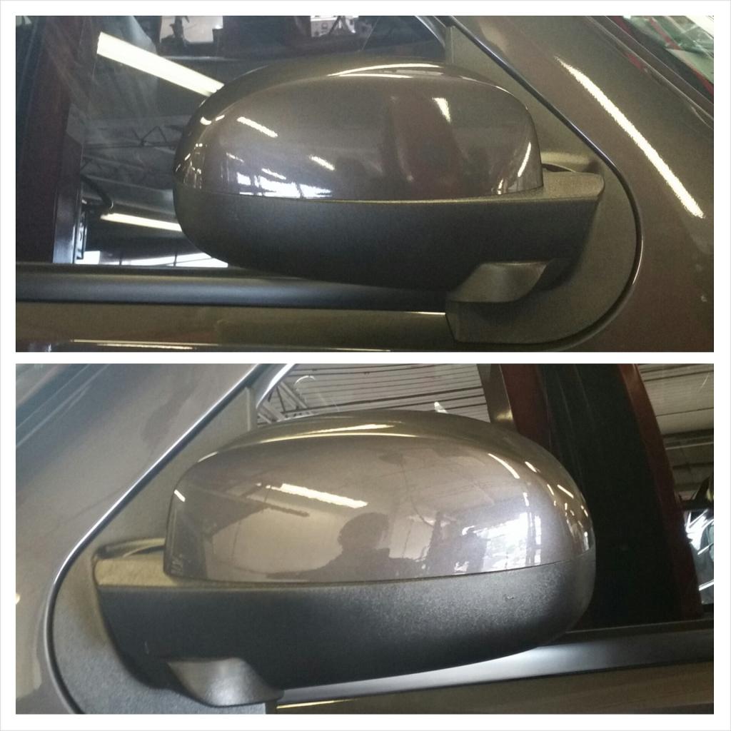

Threw in my cleared headlights and painted to match mirror covers
