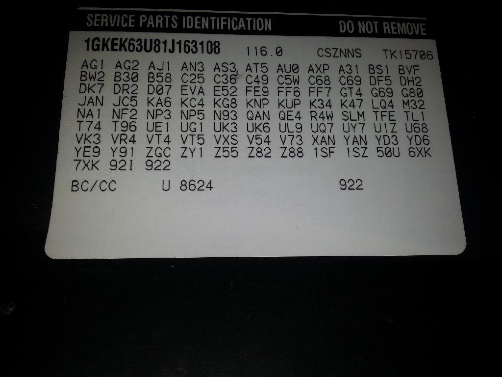

We all agree it is a lq4 but the gear ratio is 3.83. To clear any confusion. Also have this documented if i ever need it.

You mean 3.73 ???

Gt4 is 3.83 is what I found. Let me double check.
i think my first source said 3.83 but i found 3.73 for sure

Gm didn't make 3.83 for these vehicles.
GU4 = 3.08
GU5 = 3.23
GU6 = 3.42
GT4 = 3.73
GT5 = 4.10
G80 = Factory Positrack locker A.K.A. Gov lock or Gov Bomb
G86 = Factory Posi limited slip

3.83 lol , oh custom you make me laugh

How is it so funny? Either I saw it wrong ad 3.83 is so common or the first Internet sorce found s wrong. Either is simple and I don't memorize production codes
I am on my phone so not going to look but i think someone was talking about 3.83 earlier in the thread.
