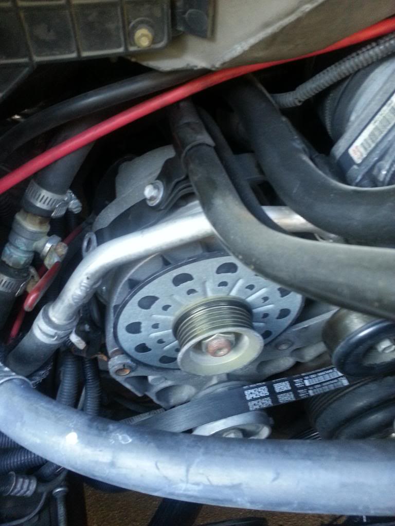

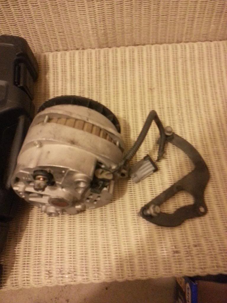

Removing the 16 year old CS-144

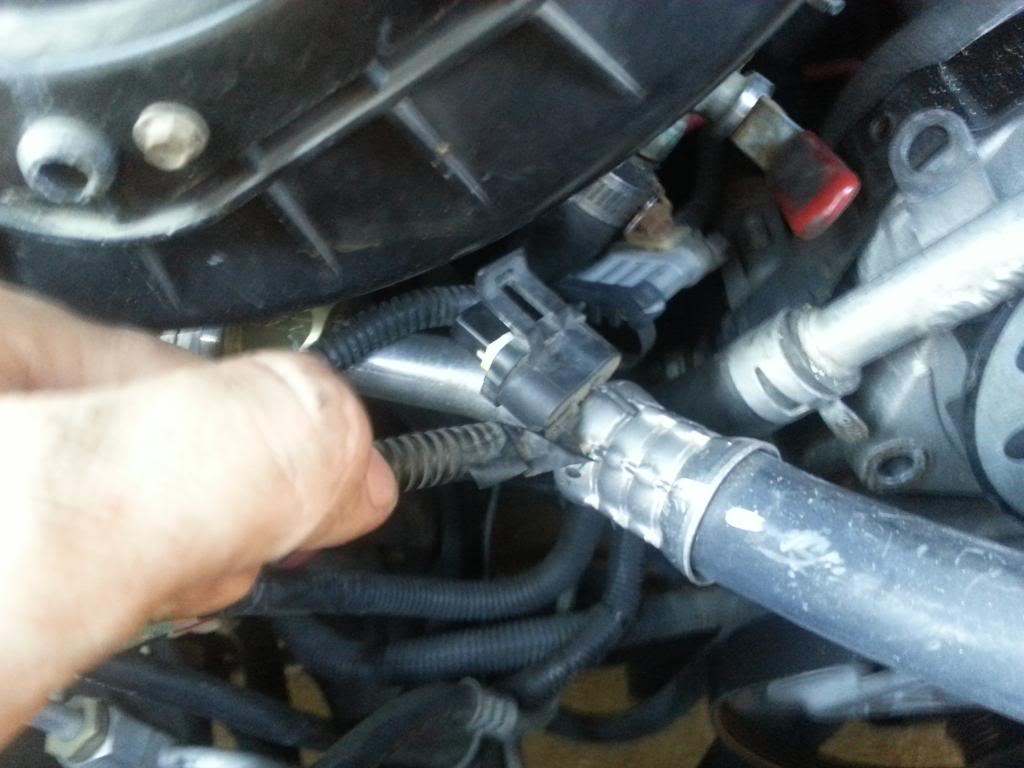

Discovered something during teardown. The grey connector is actually a factory conversion harness for a CS-130 to CS-144. MY Express harness was already setup for a CS-130 from the factory.

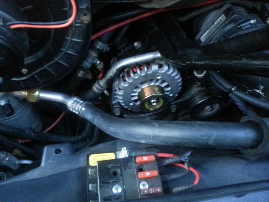

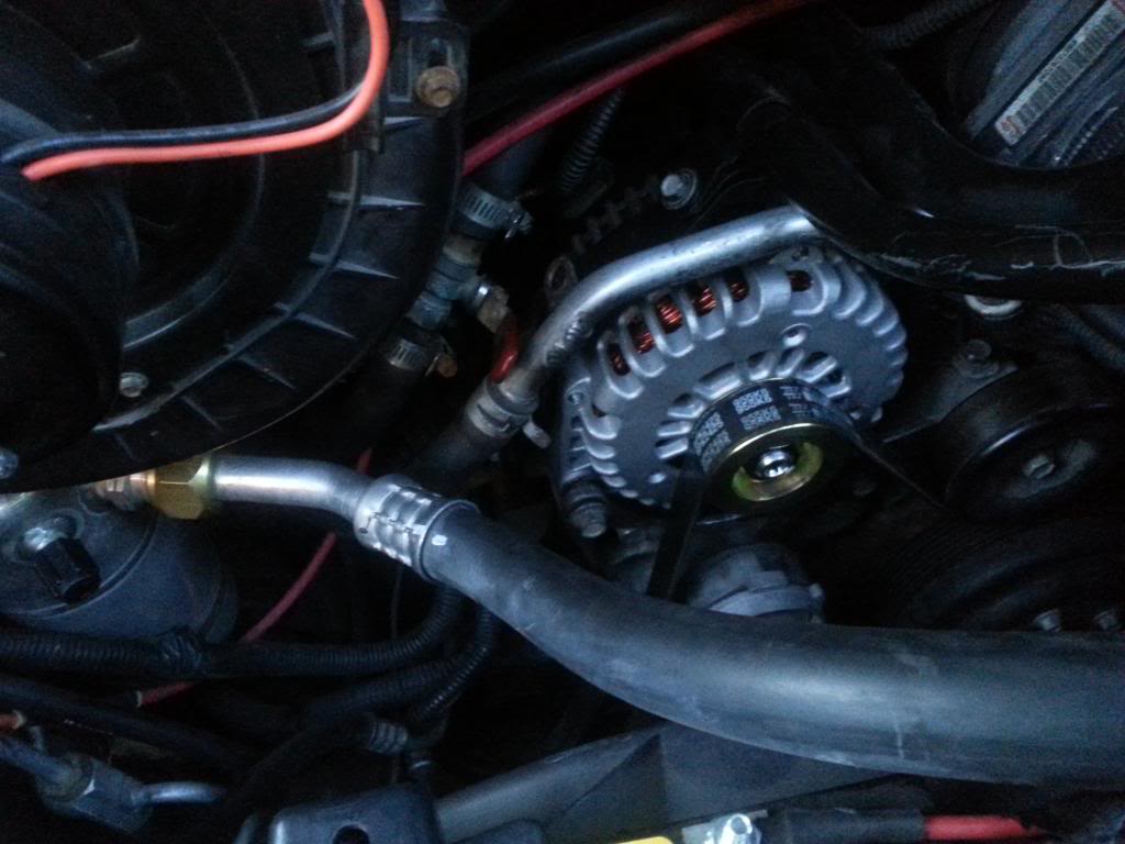

I loosened the alternator bracket from the head to allow clearance to remove the CS-144s rear brace. After fighting the sliding bushings on the mount and hooking up the charging wire it slipped into place and bolted right up.

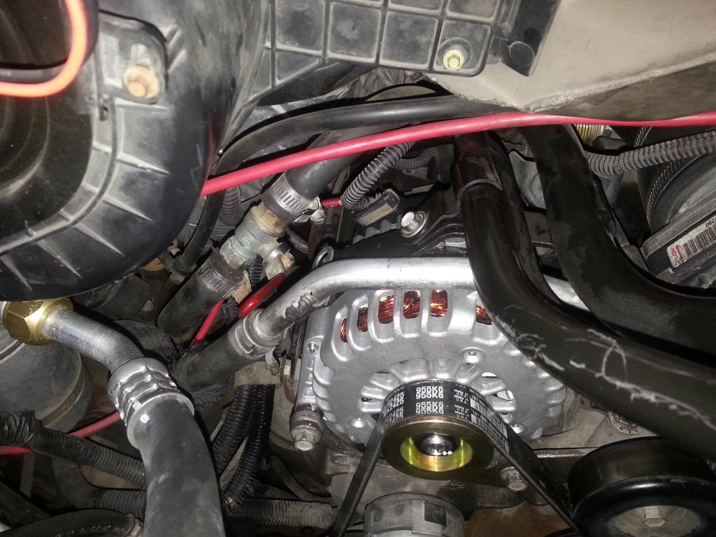

Stock CS-130 harness connector plugged righ into the AD-244

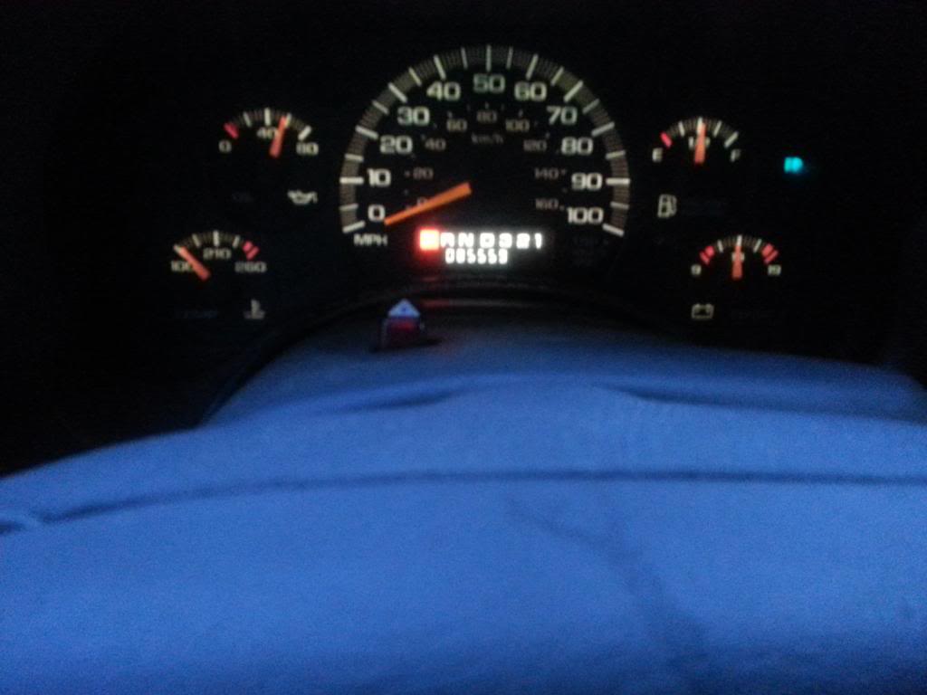

Fired her up and turned everything on.

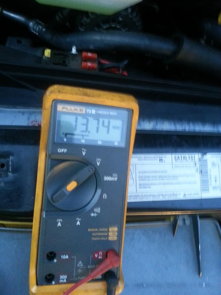

After the cooling fans tripped to high speed I measured the voltage getting to the battery.

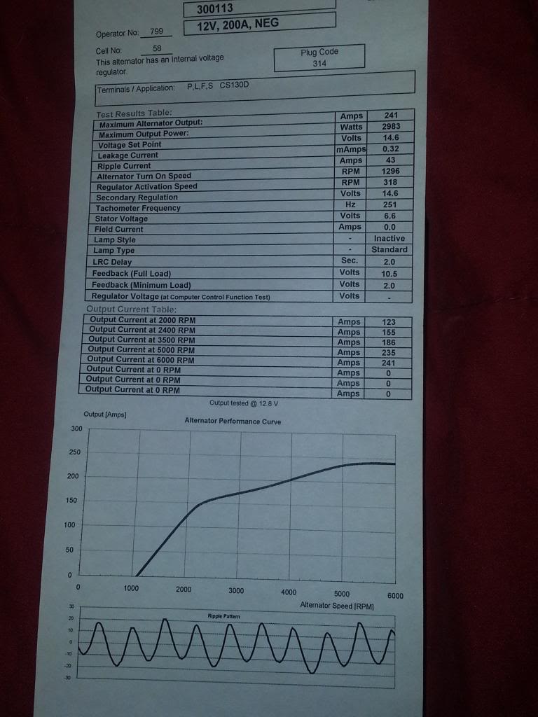

Found this little test slip in the paperwork.

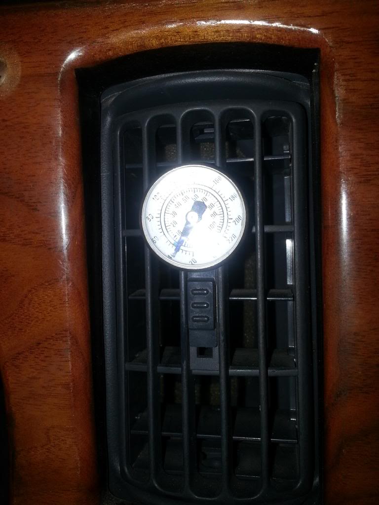

On a side note the engine is running better than ever and my 4 Hi headlights are brighter than they have been in years even before the E-fans.
I ran and picked up food and noticed the a/c blows hard and ice cold even at idle.
