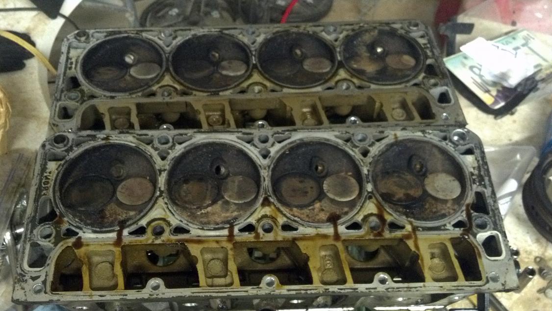

how filthy! heads are off to machine shop fist thing friday morning

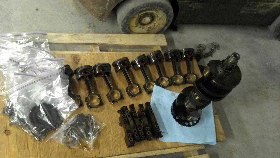

heres 90% of my internals everything is numbered and bolts are labeled is ziplock bags. organization is key!

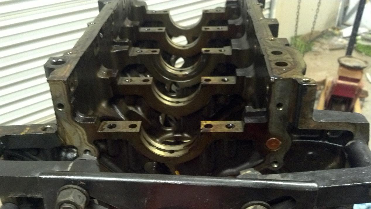

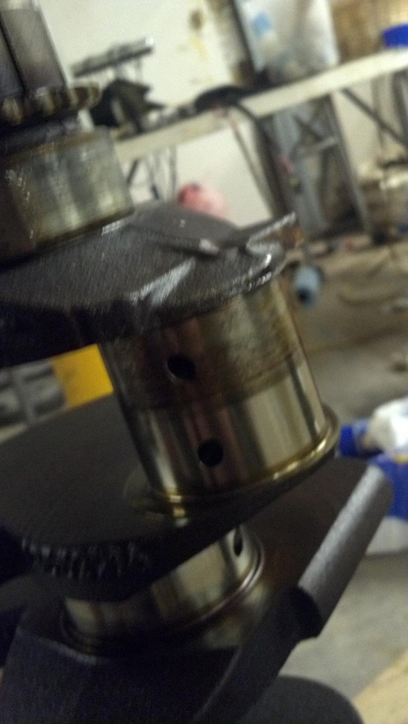

cylinder one was awfully mean to this crank. lol
