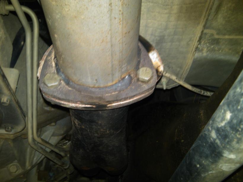

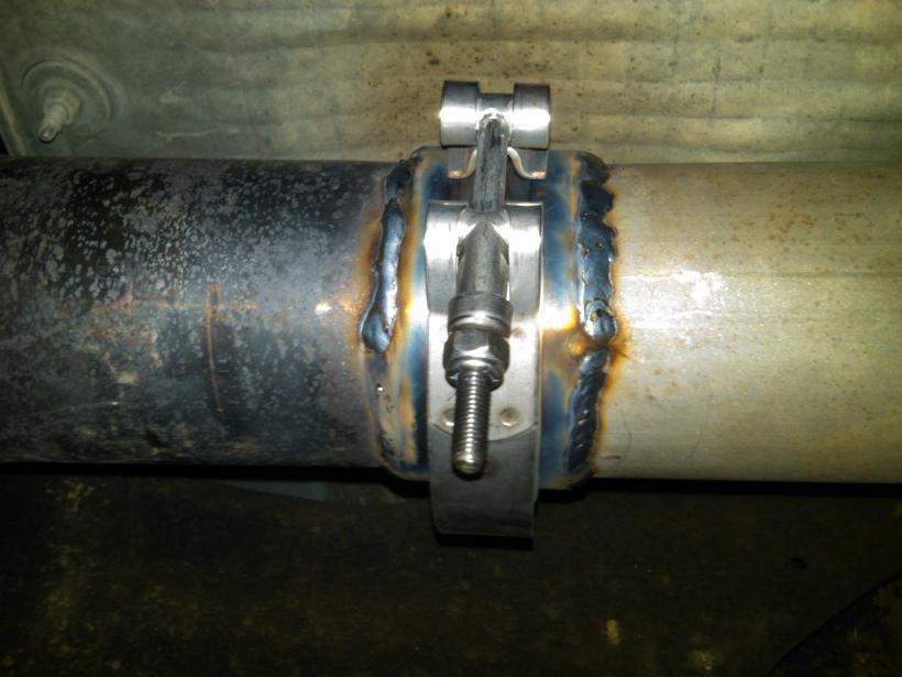

I had the last piece of the puzzle fixed today, the header collector flanges. They had been previously welded up with some crappy 3-bolt flanges, "dead soft" aluminum gaskets, and copper RTV to seal the leaks. It worked OK for a few months, then it started to look like this:
Yes, that is the gasket squeezing out the side like a slice of tomato in a thick juicy burger. This was used with a 0.300" thick 3-bolt flange.

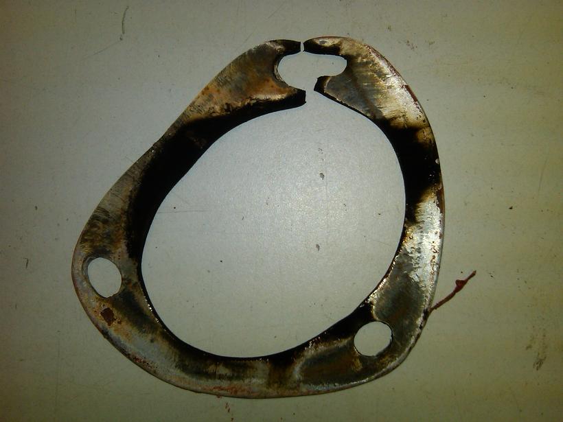

Here is what the gasket looked like when it was pulled out:

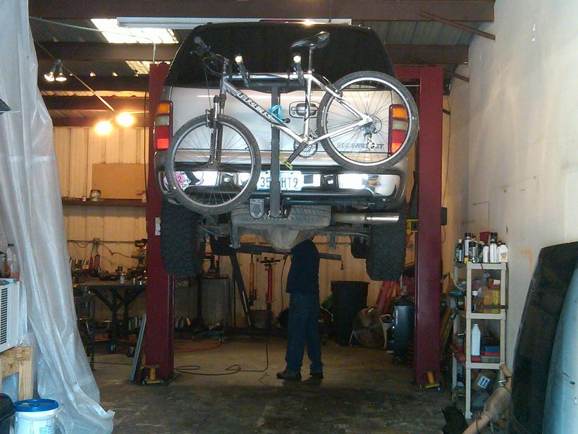

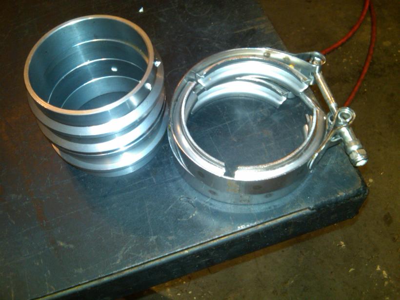

So I took the truck to Kyle at KB Racing who does excellent work at a fair price to get some V-bands installed:

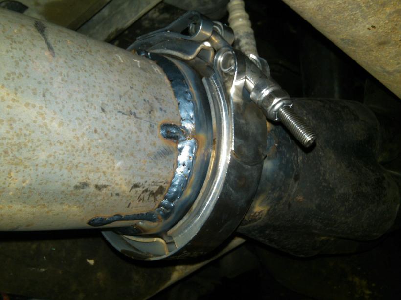

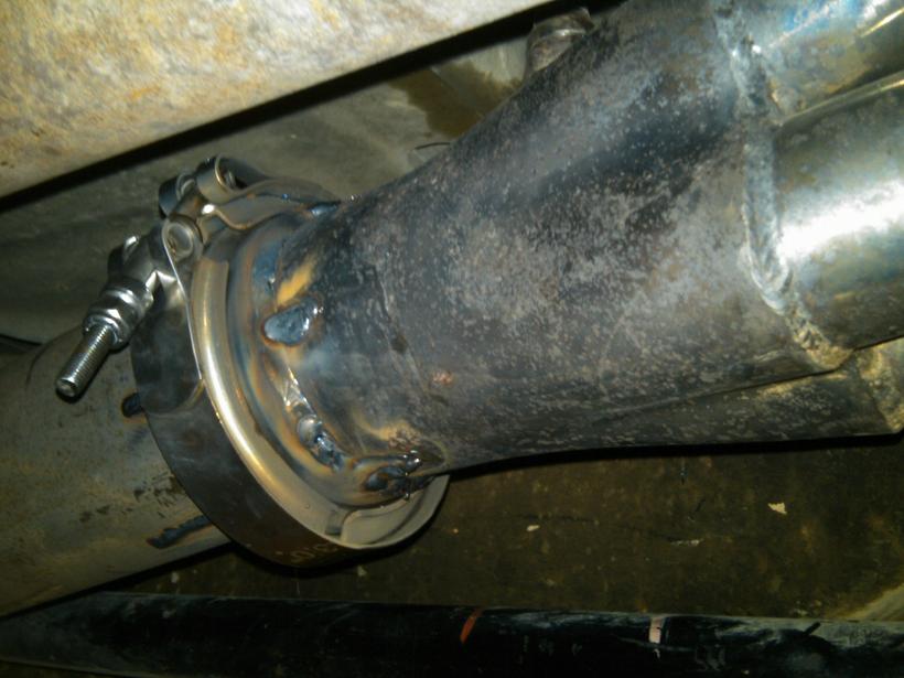

Here is the finished product:
The exhaust leaks are completely eliminated, the sound is better, and the idle is perfect.
Another happy KB Racing customer! Thanks again Kyle!
