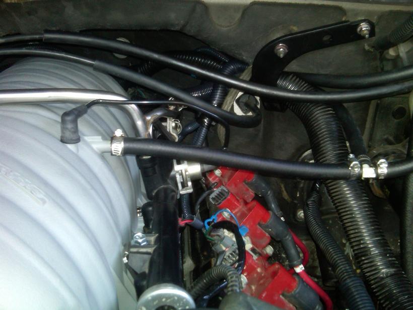

Curious, were did you remount the Evap solenoid to???
I don't know if I agree that Good Year is the worst tire, But they definitely didn't last near as long as they should have on my Silverado. I was definitely disappointed as the were recommended to me. I liked the Bridgstones AT Duelers that replaced them but they were pricey. I went with Nexxen's this last time because I was strapped for cash. There decent tires, but I think I will go back to Bridgestones or something comparable next time. The Nexxen's already out lasted my Good Years and still have plenty of tread left.
Thanks man! The evap solenoid is behind and left of the little bracket shown below. The hose is connected to a T on the return line from the catch can.

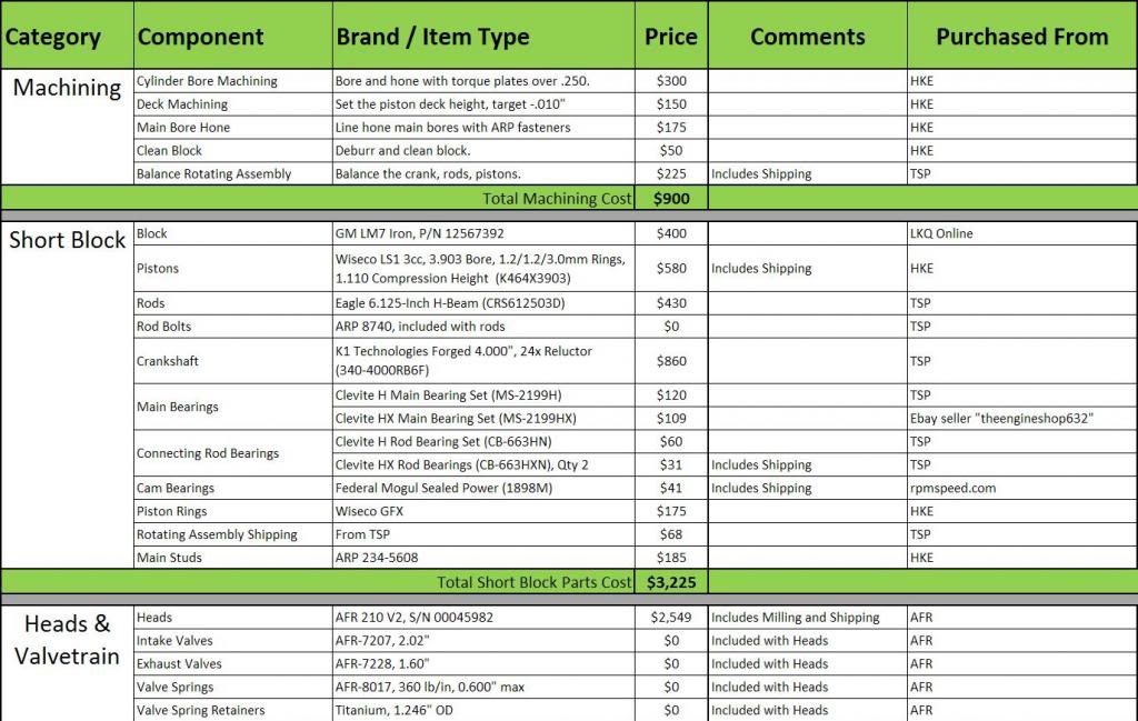

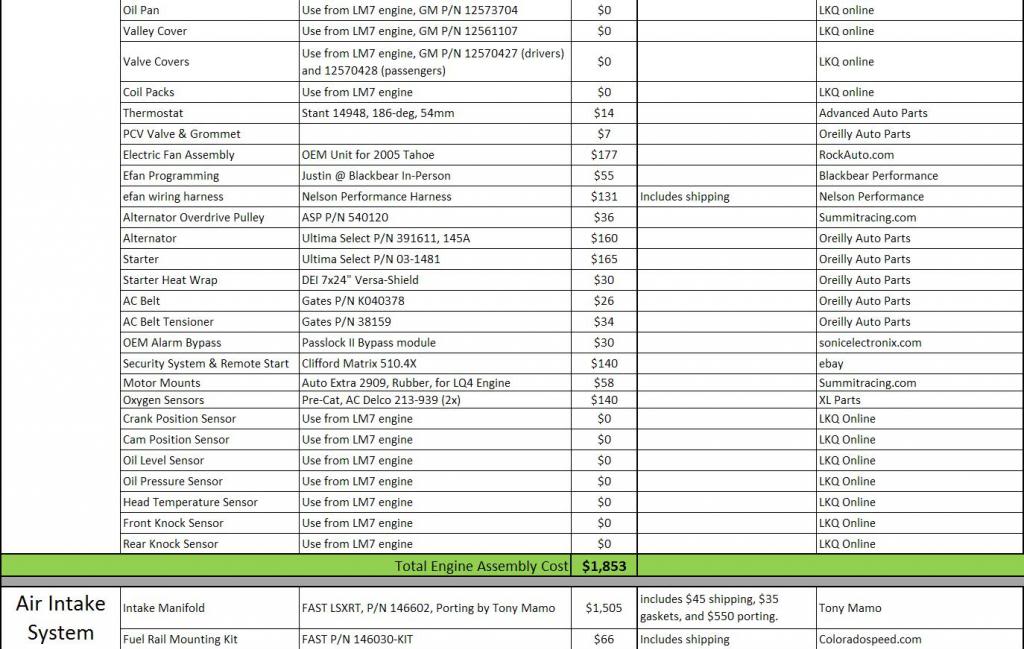

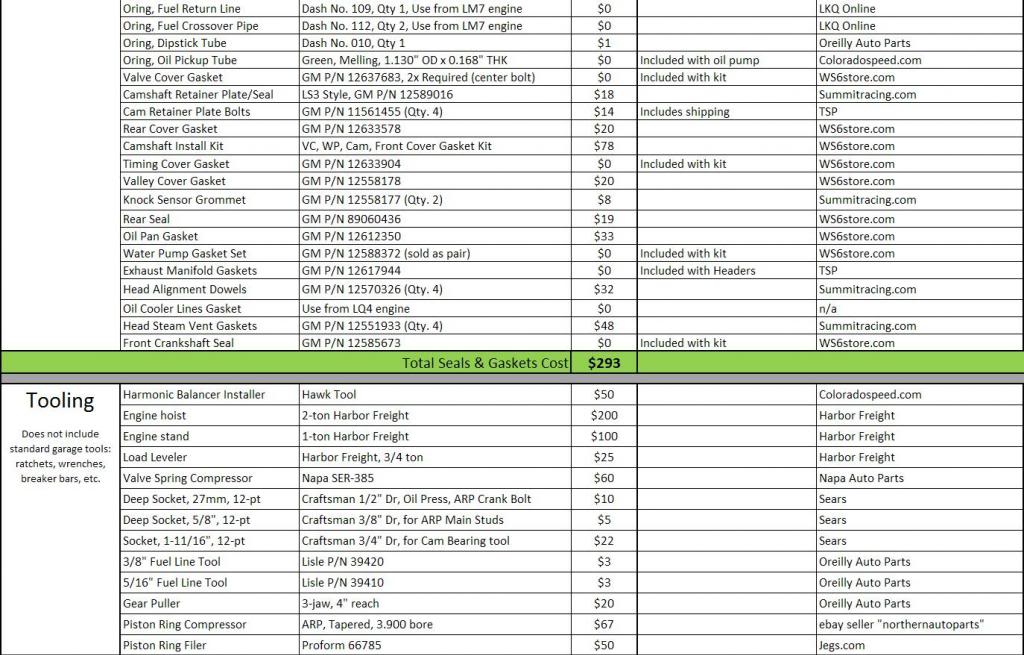

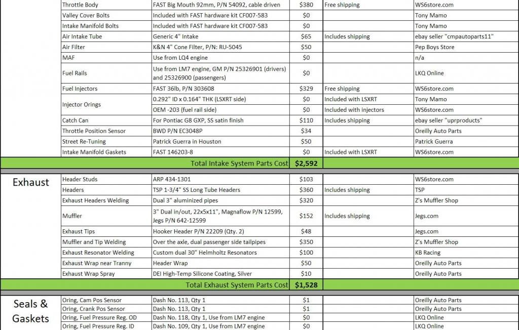

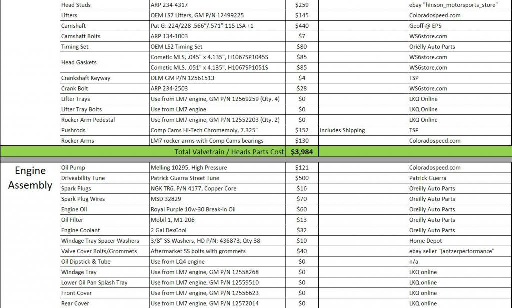

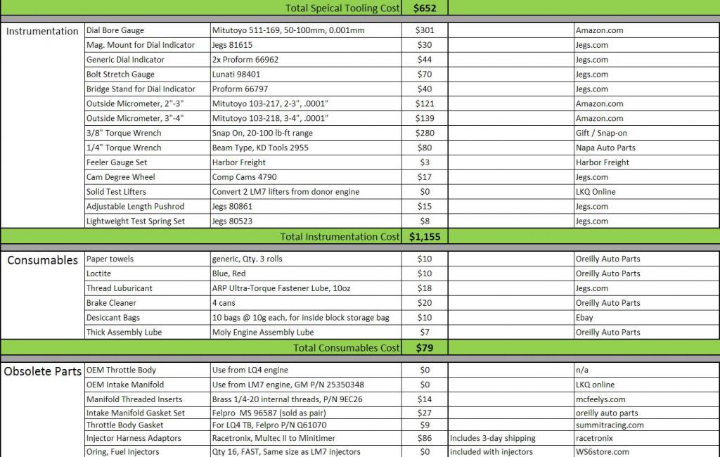

Here is my updated parts & prices list for this project.

I am not sure if you documented this build sufficiently. At least the IRS might be able to find one flaw in your paper work.
I would kill to have you organization! I am far too much of a procrastinator to document all of this data. I sure hope this truck lasts for a long time and fulfills all of your dreams!!
P.S. I just say you went all the way to "consumables" holly cow! I did go threw your trash and noticed that you left 2 grams of brake clean in one of the cans. That means you can adjust the cost buy 12% on one can.
